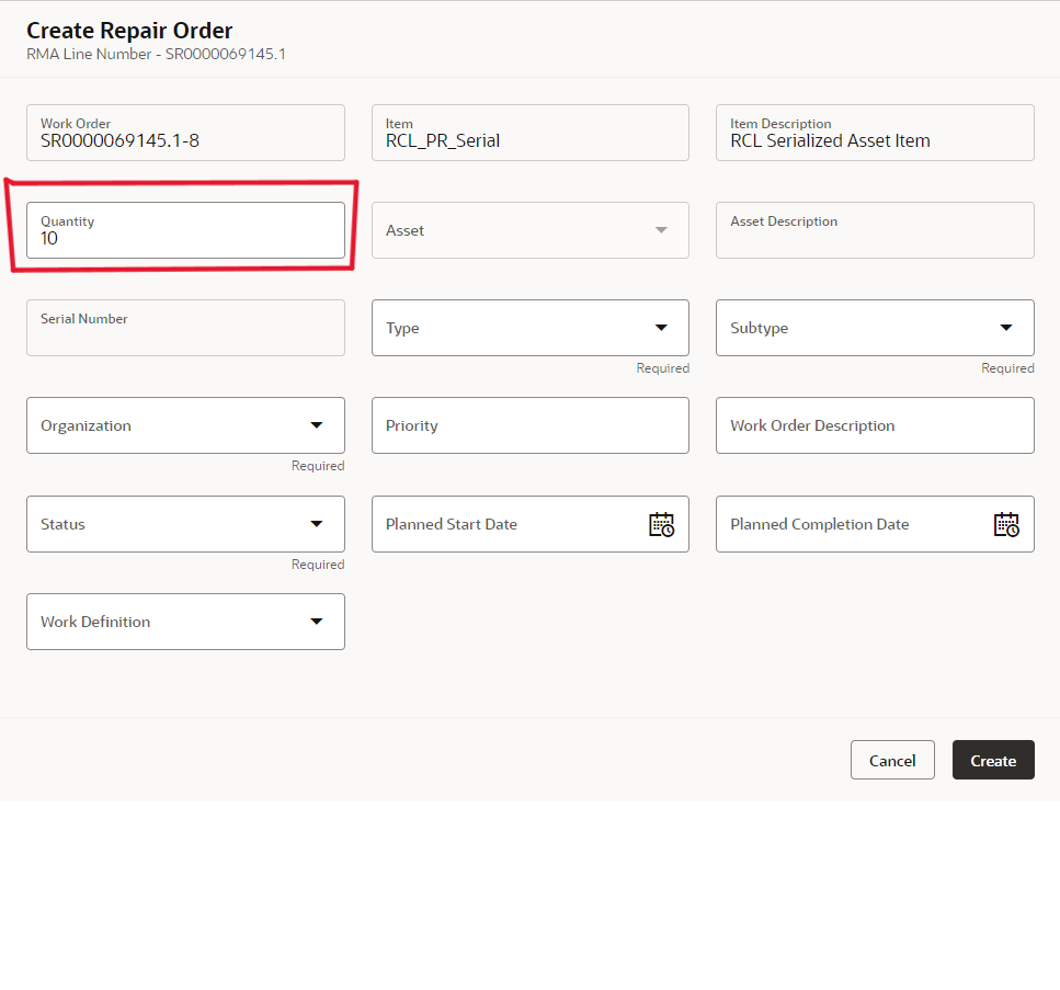

You can now create a repair work order to repair multiple serial-tracked assets with the same item number.  When you want multiple assets on a work order, you must enter these assets in a new tab in the Maintenance Work Order UI.  If you have only one asset to repair, you will continue to select the asset on the Depot Repair Create Repair Order UI.
The screen shot shows the creation of a repair work order for 10 serial-tracked assets.
Redwood Create Repair Order UI - For Quantity Greater than One

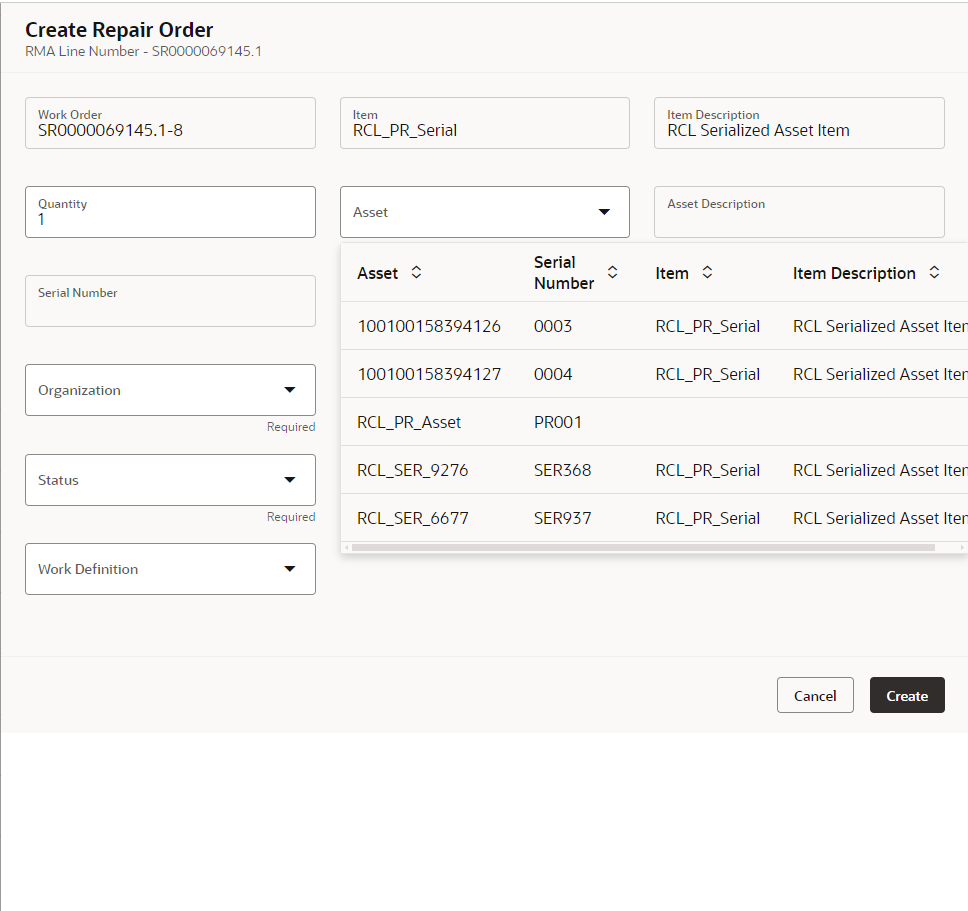

When the work order quantity is one, you will continue to use the current functionality, where you can select the broken asset from a list of assets received against the RMA/return sales order line.
Redwood Create Repair Work Order UI - Order Quantity is One
