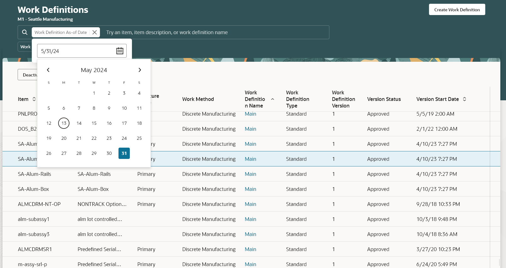

Search Work Definitions as of a Specified Date
In the Work Definitions page, you can now search for work definitions versions that are effective as of a specified date. You can apply the Work Definition As-of-Date filter and select a past date, today, or future date to narrow the search for work definition versions based on the version start and end dates. This type of search filter helps you quickly find work definitions for change management scenarios that take effect on a particular date.

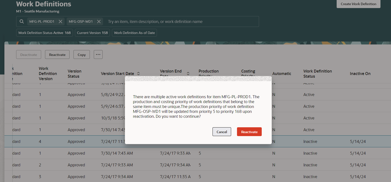

Warn When Reactivating a Work Definition
When you reactivate an inactive work definition, you can view a warning message to confirm the action before reactivation in the Work Definitions page. Reactivating a work definition makes all of its versions available again.
Warning When Reactivating a Work Definition
