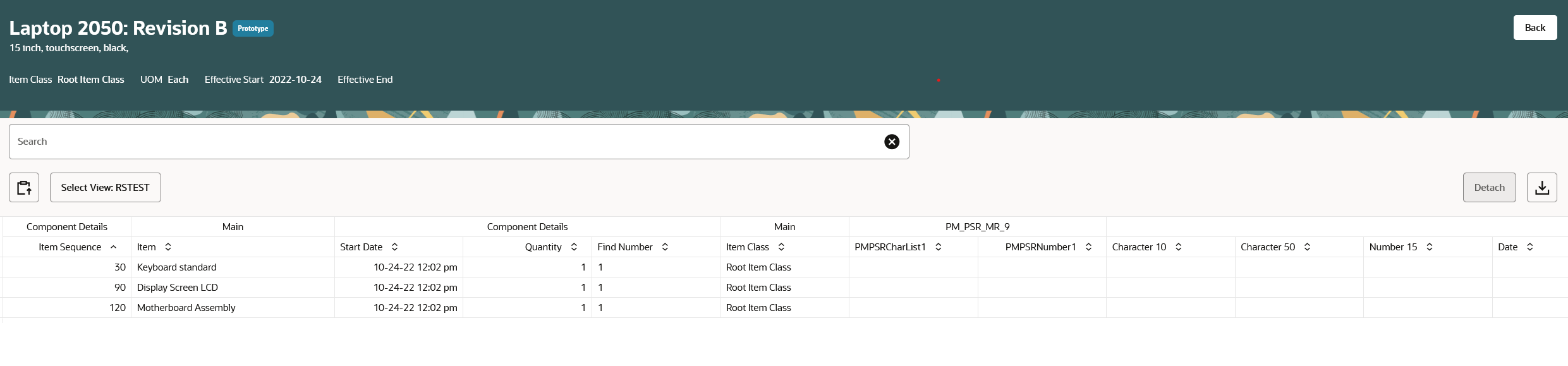

Use the new interface to quickly find item structures and view the exact information you want. First, navigate to the new item search from Tasks > Product Management Experience > Search Products.
In the item search results table, you can click the structure presence indicator (dot icon) against the item to navigate to the structure. When you open the structure, if there are subassemblies, you can navigate to these using the presence indicators on the component rows.
Once you navigate to the structure, you can:

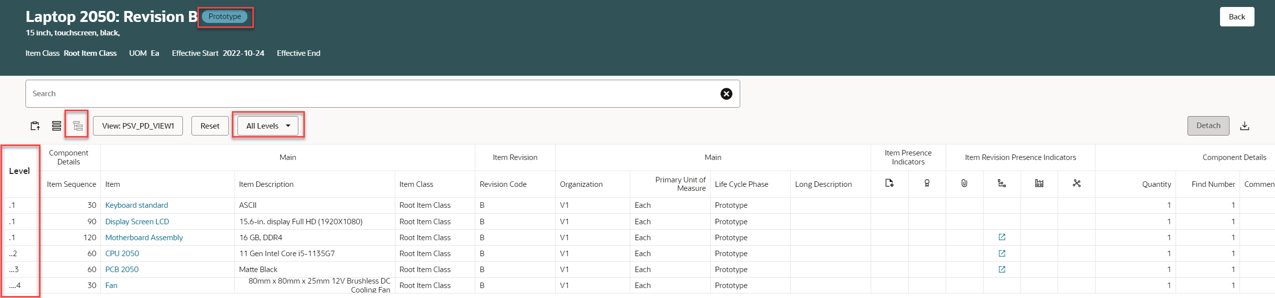

- view the basic details of the component on the header including lifecycle phase
- toggle between the first level and level view
- see the levels displayed on a structure
- filter by the levels.
- see the progress indicator when the data is loading.
- select different views created by your administrator through Configure Views. The view can contain item operational attributes, item extensible flexfields, component level attributes, or component descriptive flexfields.
- apply filters on the structure (filter supports item and item description).
- export the selected columns and rows or all.
- detach the table to view in full screen mode.
- navigate to the existing item interface using the hyperlink.
- If you have navigated to the new grid from the Product Development work area, the item will be opened in Product Development.
- If you have navigated to the new grid from the Product Information Management or the Concept Design work area, the item will be opened in Product Information Management.
- copy items to the clipboard.
- view the total count of rows in the structure and the number of selected rows.

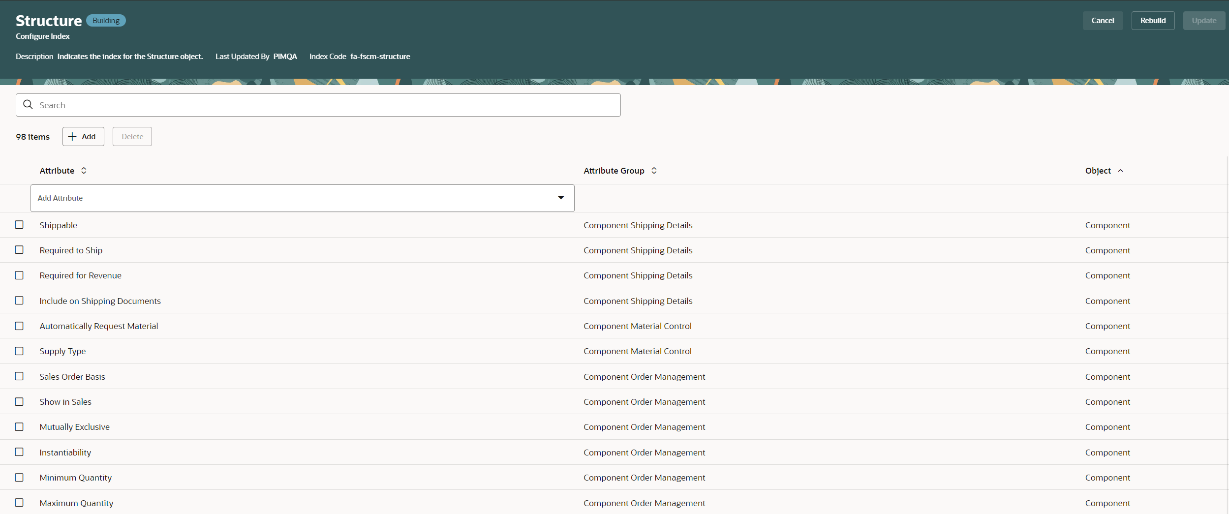

As an administrator, you can see a new structure card on the index management page. This will let you ingest item attributes (operational and extensible flexfields) and component attributes, including descriptive flexfields, that you can use to create Views.
Structure Index Management
Component Attributes Indexed for Structure

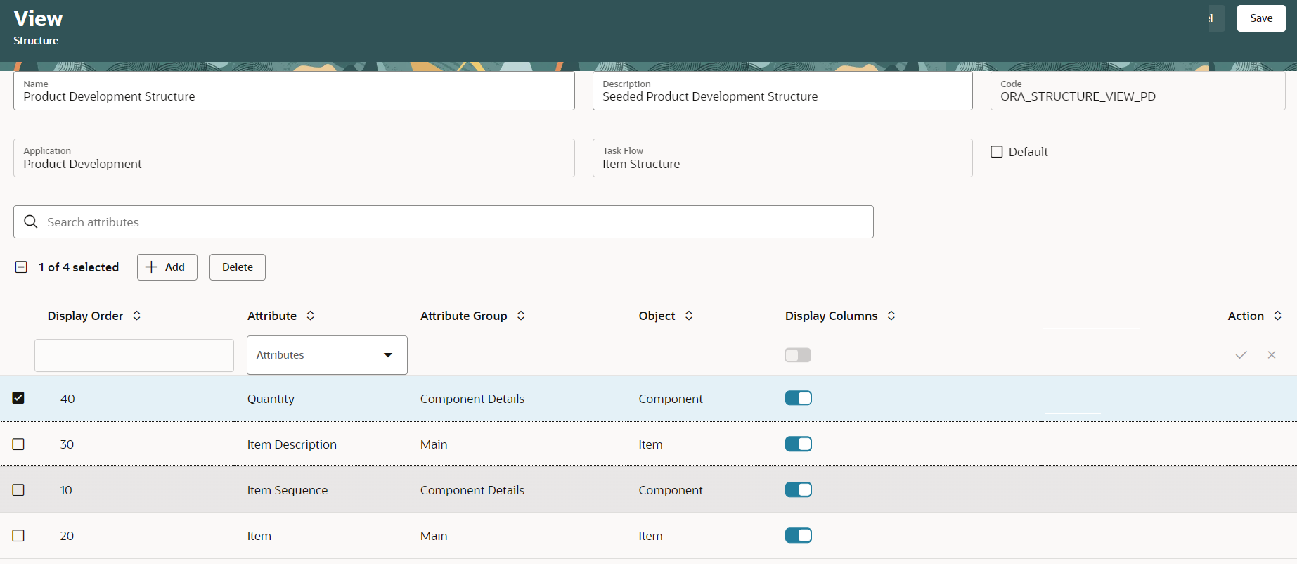

Configure Views can be used to configure the search you wish to see in new user interface. In the task menu click on Configure Views, to see existing views. You can modify an existing view or create a new view. In the search view you can add or remove attributes which are indexed. The view that is marked as default will be displayed in the Structure Grid screen for all users
For each view you would be able to control
- Attributes - item operational attributes, item extensible flexfields, component level attributes, and component descriptive flexfields
- Display columns- If display column is enabled, you will get an option to add the attribute as a column for display
Configure Structure View for Product Development Structure

- The index needs to be run the first time, and then each time a new attribute is added if you want to use the newly added attribute in your search.
- You must rebuild the index and re-create the Views if you have already created it.
- The index is run behind the scenes for new changes that are added after the index was last rebuilt.
- Prior to adding presence indicator attributes to the object index, you will need to run a job which will populate the data in the presence indicator table so that the index ingest program can add the presence indicator data to the index.

If you haven't configured a view, there is a default view available showing Item and Item Sequence attributes. Depending on the work area from which you navigated to the structure, the default view is either Product Development Structure or Product Hub Structure.
- To navigate to the subassembly, you need to add the Item Structure in the Rev Level Indicator attribute group.
- Item and Item Sequence are added to each search view by default. Whenever you create a new search view or modify a search view, these attributes can't be removed.
- You can create a view that contains Item operational attributes, Item extensible flexfields, component attributes, and component descriptive flexfields.
