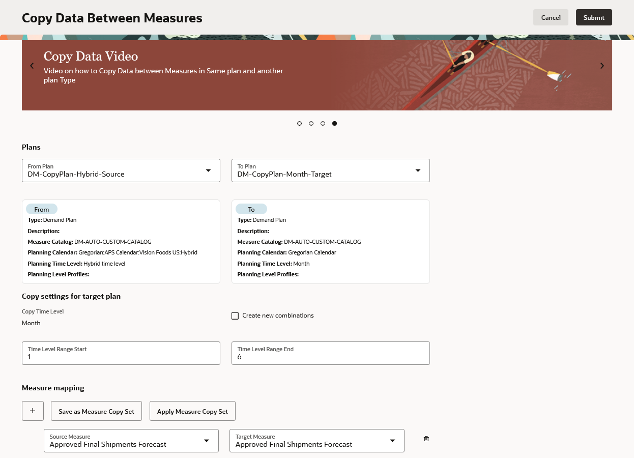

Copy Data Between Measures Page

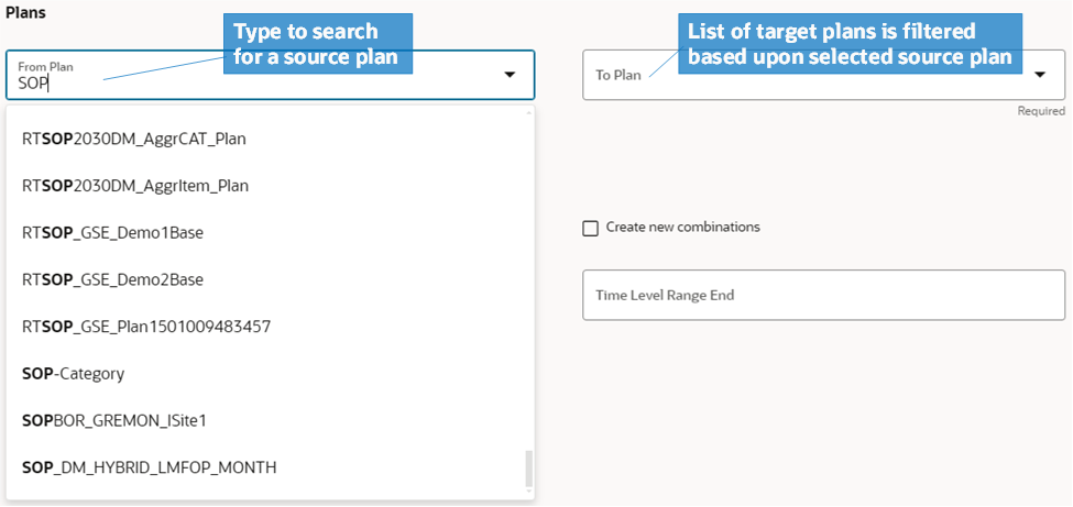

You can search for and select the source plan and target plan by typing in From Plan and To Plan respectively. The list of target plans is filtered based upon the selected source plan.
Search for From Plan and To Plan

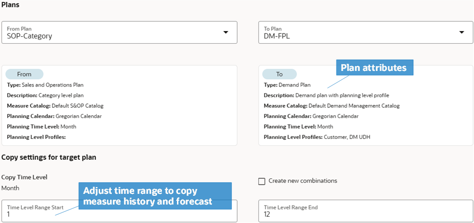

You can copy measure data for a time range that includes both past and future dates. Use a negative value for time periods is in the past.
Adjust the Copy Time Range

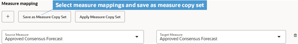

You can then specify one or more measure mappings between a source measure and a target measure. Save the measure copy set to automate data copying between measures.
Save as Measure Copy Set

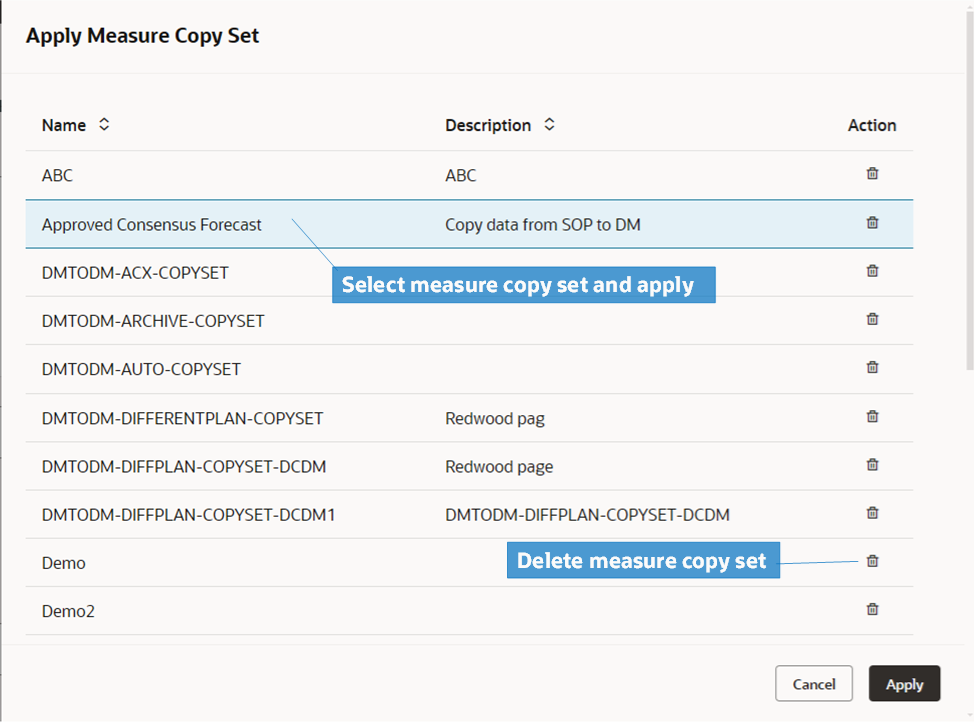

You can apply a previously saved measure copy set and update the measure mappings. If you no longer need a measure copy set, you can delete it in the Apply Measure Copy Set panel.

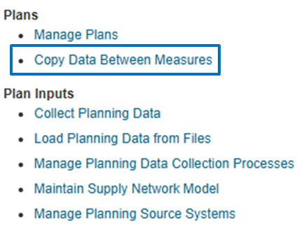

Once this feature is enabled, the landing page’s panel task displays Copy Data Between Measures instead of Load Measures from Other Plans. Clicking this task opens the Redwood page in a new browser tab.
Copy Data Between Measures task
