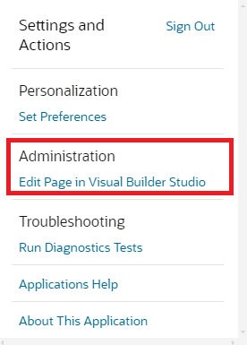

To determine whether you can extend a specific page using VB Studio, go to the page and open the Settings and Actions menu. Look for the Edit Page in Visual Builder Studio task.
This image shows the Settings and Actions menu with the Edit Page in Visual Builder Studio menu item selected. This menu action takes you to VB Studio, where you can add journey codes to Redwood pages.
Settings and Actions Menu
You can't use VB Studio to edit the page if you don’t see the Edit Page in Visual Builder Studio task.

  2. Select the Edit Page in Visual Builder Studio task in the Settings and Actions menu.

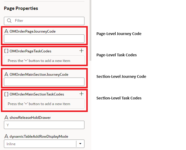

  3. Navigate to the Page Properties section (formerly the Constants tab). Wait for the page to load completely before proceeding to the next step.
  4. Locate the journey code property you want to modify, and enter the page- or section-level code from the guided journey into the property field in VB Studio.
Mapping of VB Studio Property Name to Guided Journey Field Name
Property Name in VB Studio
Field Name in the
Description
NamePageJourneyCode
(journey) Code
Page-level journey code field, where Name is the camel-case name of the page. Enter a journey code in this field to display guided journeys at the page level.
NamePageTaskCodes
(task) Code
Page-level task codes, where Name is the camel-case name of the page. Enter a task code in this field to display tasks at the page level. Separate multiple task codes with a comma.
NameSectionJourneyCode
(journey) Code
Section-level journey code field, where Name is the camel-case name of the section. Enter a journey code in this field to display guided journeys at the section level.
NameSectionTaskCodes
(task) Code
Section-level task codes, where Name is the camel-case name of the section. Enter a task code in this field to display tasks at the section level. Separate multiple task codes with a comma.
The following screenshot shows journey code fields at the page and section level.
This image shows journey codes at the page and section level in VB Studio.
Journey Code Fields in VB Studio
