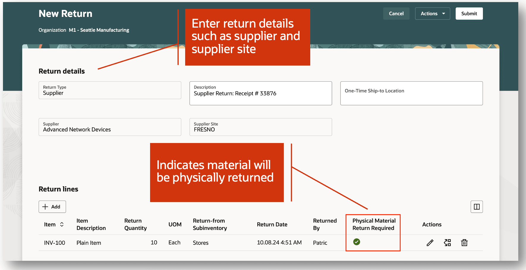

When creating a new return, the Physical Material Return Required column indicates that a shipment will be created to physically return the material to the source.
IMPORTANT NOTE: When the Ship Your Receipt Returns Through Oracle Shipping When Goods Require Physical Return opt in feature is enabled, the Physical Material Return Required column will be enabled.
dskjf

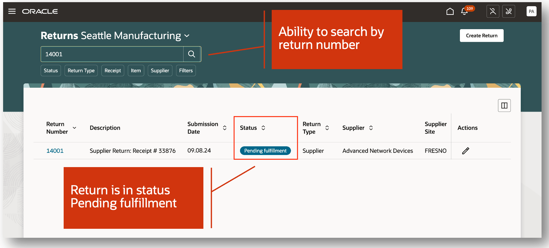

Once you've successfully created the return, it will appear in Pending fulfillment status on the Returns page. You can search by the return number to view the status of the return. Optionally, you can use the Status filter to display only those returns that are in Pending fulfillment status.
lkdsmnfkl
Return Pending Fulfillment

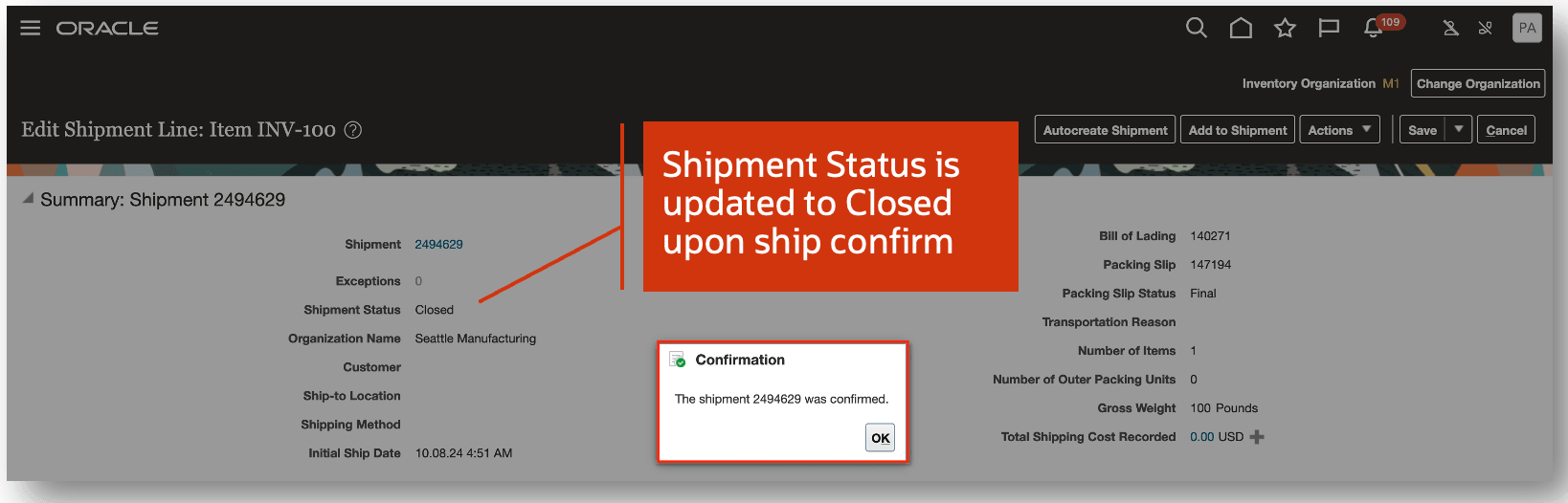

Once you've confirmed your shipment, the shipment status is updated to Closed.
ksdjfk
Ship Confirm

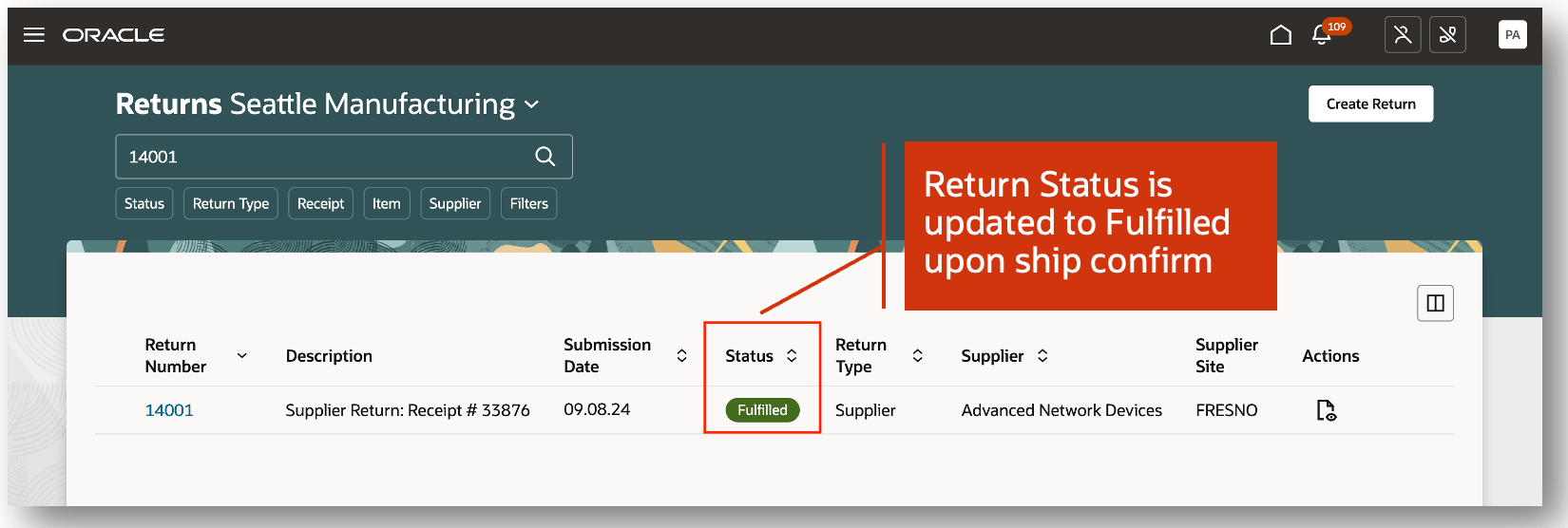

You can navigate back to the Returns page to view the return status. You can confirm that the status associated with the return is Fulfilled.
asDA
Return Status Fulfilled

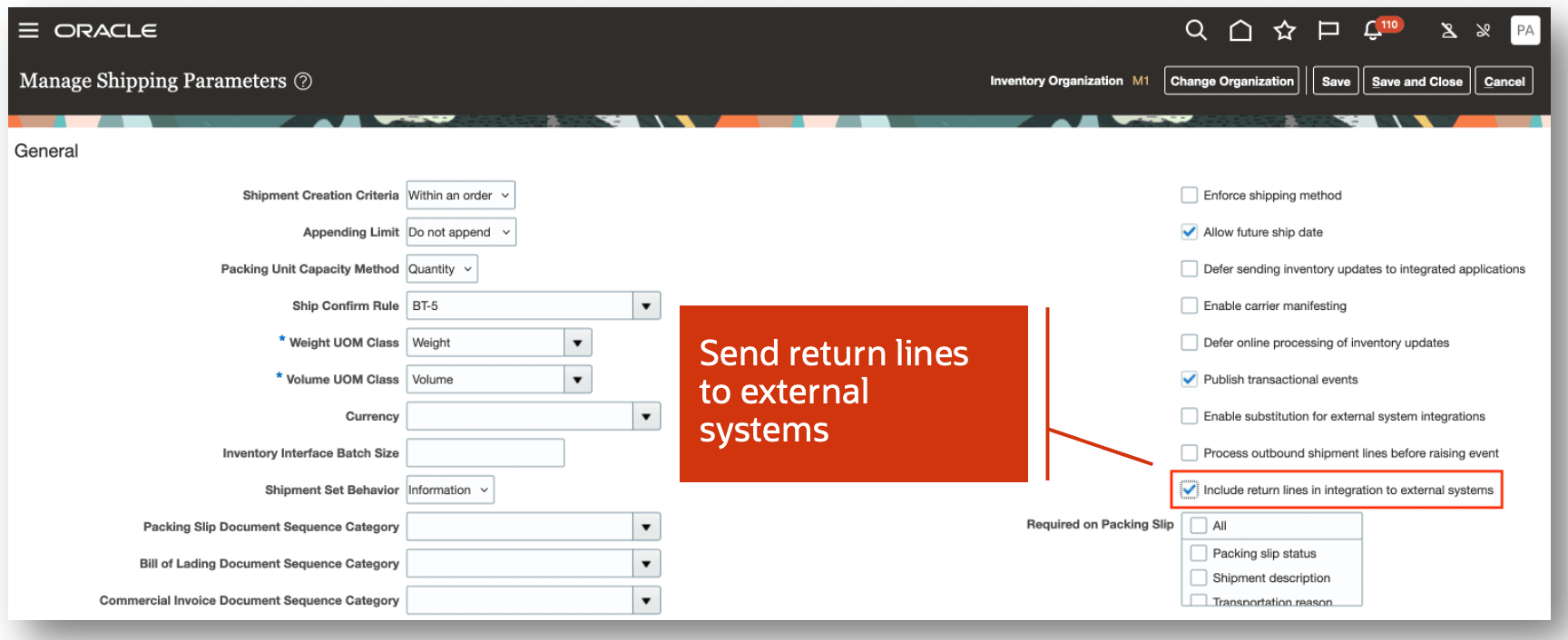

When a WMS or 3PL system ships the return line, you can send the shipment lines created for the return order to the external execution system using the Generate Shipment Request process. To include return lines sent as part of the Generate Shipment Request process, enable the Include return lines in integration to external systems shipping parameter. Once the return line is shipped in the WMS or 3PL system, the shipment information is sent to Oracle Shipping to confirm and close the shipment.
Follow these steps to enable the Include return lines in integration to external systems shipping parameter.
  1. In the Setup and Maintenance work area, go to the Manage Shipping Parameters task:
  • Offering: Manufacturing and Supply Chain Material Management
  • Functional Area: Shipping
  • Task: Manage Shipping Parameters
  1. Enable the Include return lines in integration to external systems parameter.
  2. Click Save and Close.
ndsklf
