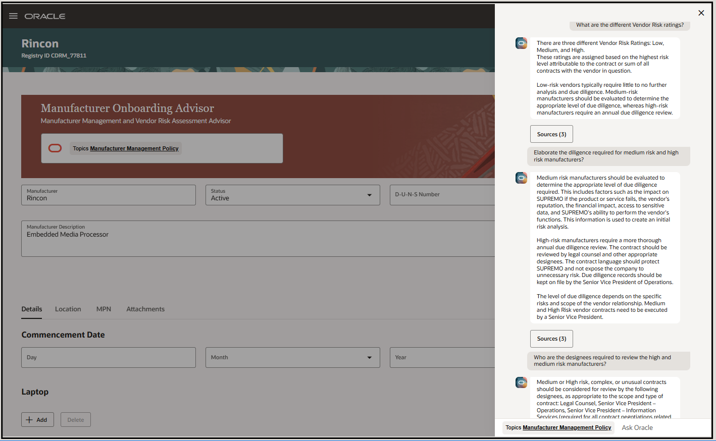

Deploy AI agents in guided journeys to answer user questions about SCM standards, regulations and policies. You can upload various sources of information for the AI agents, such as policy documents, regulations (industry, geographic, governmental), standard operating procedures, and more. Through a chat experience that's embedded in transactional pages, users can ask questions and get highly targeted responses sourced from these uploaded documents.
Example: Design engineer interacts with AI agent while onboarding a manufacturer as shown in the screenshot
