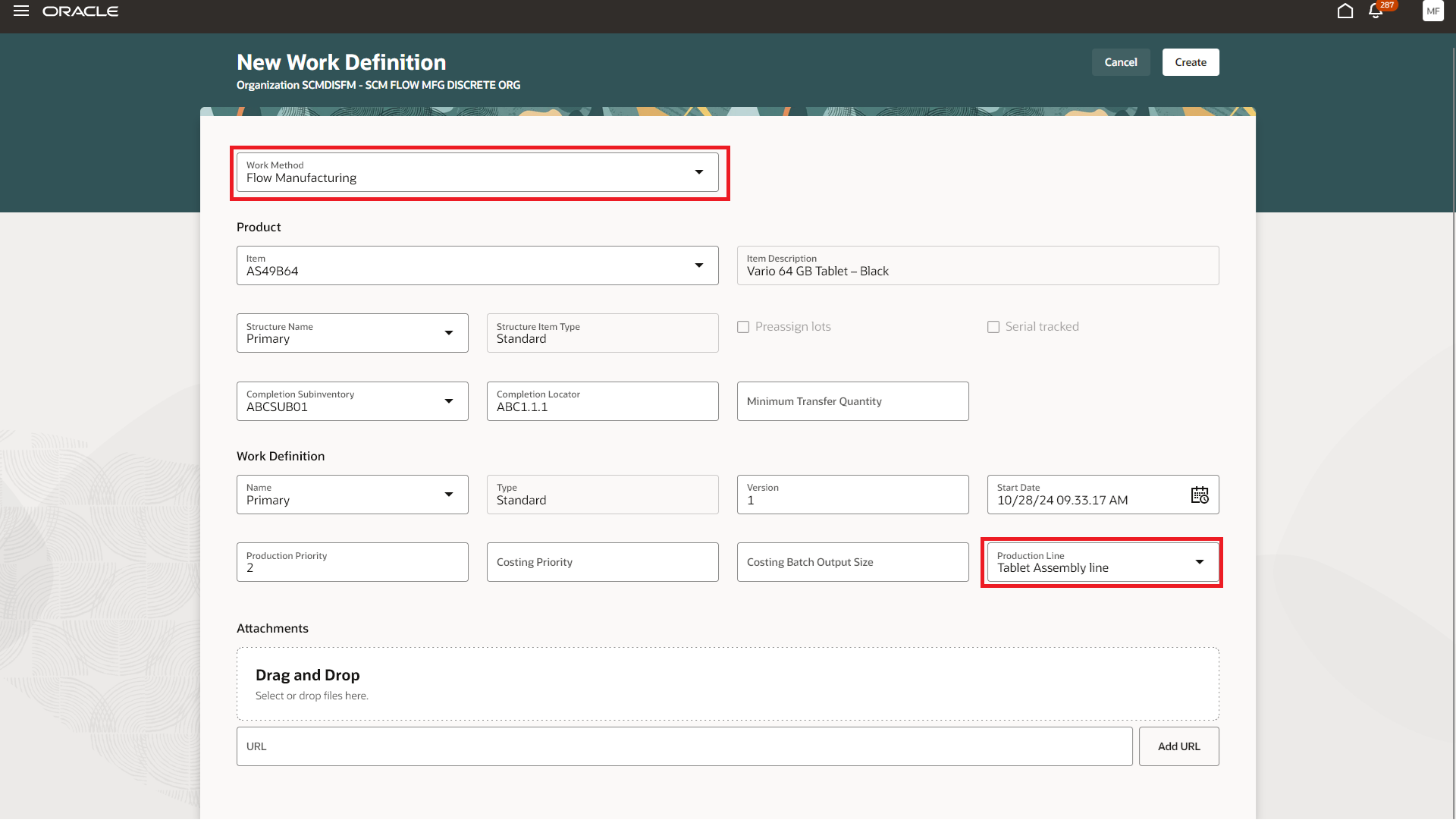

Using a Redwood user experience, you can create and update a work definition to make a standard item or Assemble to Order model (ATO) item using flow manufacturing on a specific production line. A work definition models the production process as the combination of the product structure with the set of operations, and equipment and labor resources used in the production line. A flow manufacturing work definition is subsequently used in creating flow schedules that can be sequenced for execution and completion of multiple products on a line.
- Search and filter work definitions – Use keywords and filters to quickly find an item's work definition to review and manage.
- Efficiently manage work definitions – Use actions like copy, delete, deactivate, and reactivate on a work definition. Manage versions and edit priorities in change management scenarios.
- Create a work definition for an item in a few steps – Enter the product information with a reference to its item structure and production line. Use the placeholder operation as a starting point.

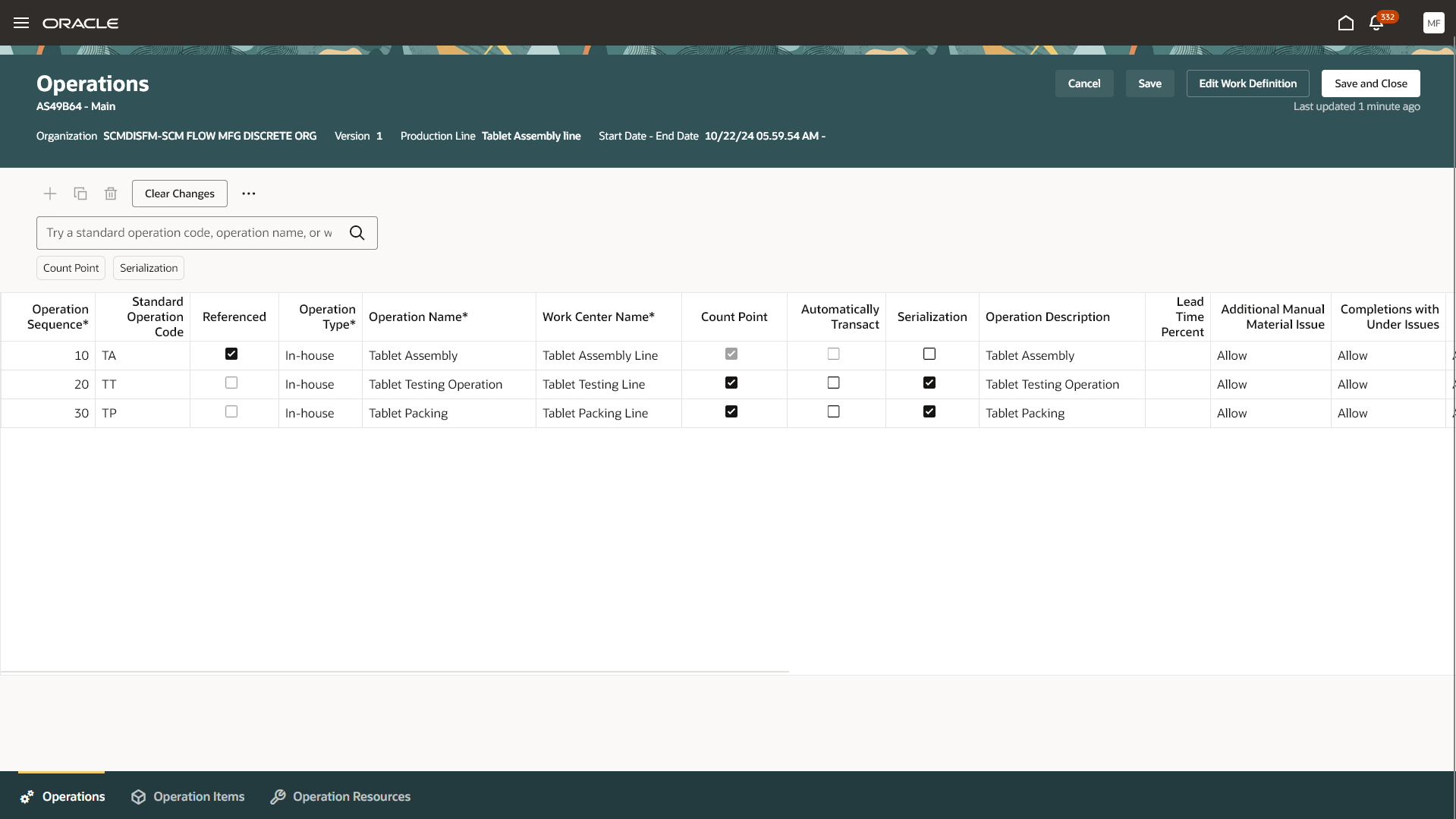

- Edit work definition's operations, operation items, and operation resources using a grid experience:
- Provide spreadsheet-like interfaces that allows to enter, access, or edit large volumes of data with high efficiency
- Navigate through the data relationships in a work definition using tabs and grids
- Add, copy, or delete rows in the grid
- Search for specific data in the grid to narrow down the dataset
- Enter data using keyboard shortcuts or mouse-driven interactions including cut, copy, paste, and autofill

Create a Flow Manufacturing Work Definition

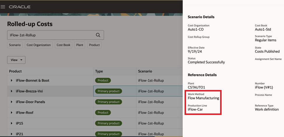

If you use standard cost method to value your inventory, in the Rolled-up Costs page, the Production Line information is available for reference after you calculate the costs of your products.
Production Line Information in Rolled-up Costs

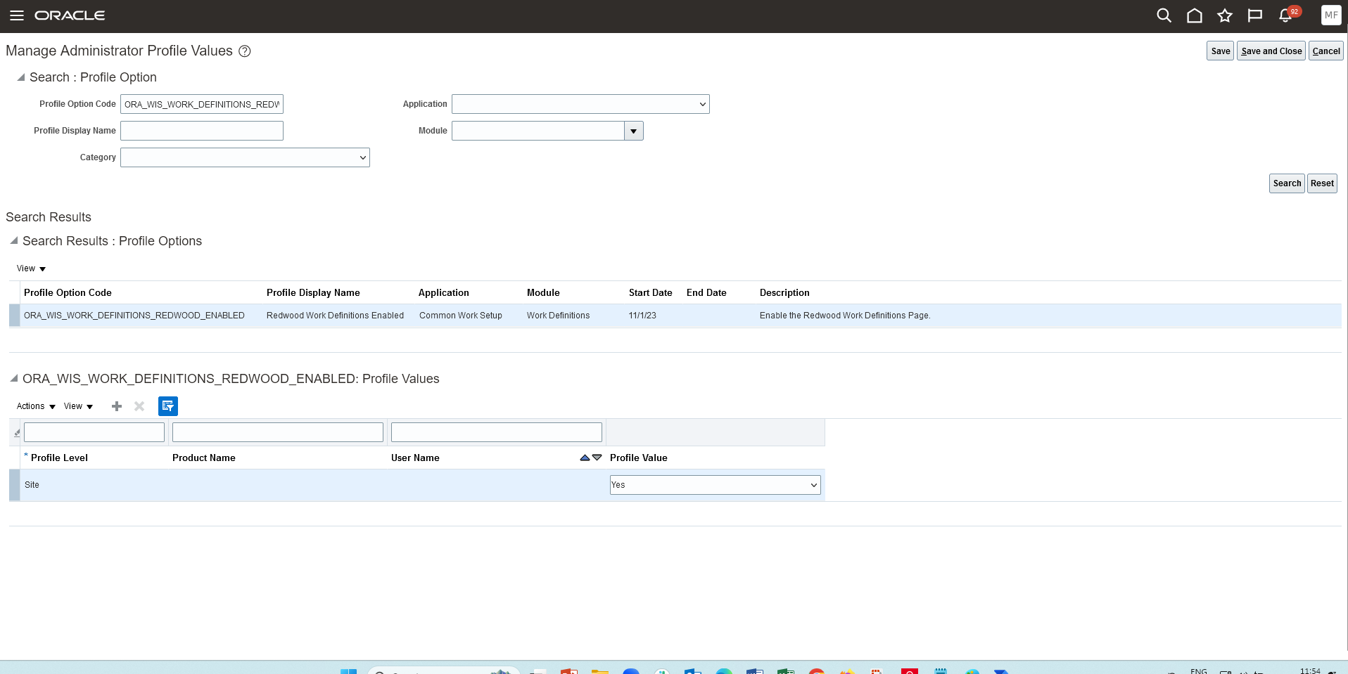

Follow these steps to enable or disable this feature:
- Enable the Profile
- In the Setup and Maintenance work area, search for and select the Manage Administrator Profile Values task.
- On the Manage Administrator Profile Values page, search for and select the ORA_WIS_WORK_DEFINITIONS_REDWOOD_ENABLED profile option code.
- In the Profile Values section, set the Site level to Y or N. The default value of the profile option is N.
- Y = enables the feature
- N = disables the feature
- Click Save and Close. Changes in the profile value will affect users the next time they sign in.
Profile Option for Accessing Work Definition Using Redwood User Experience
