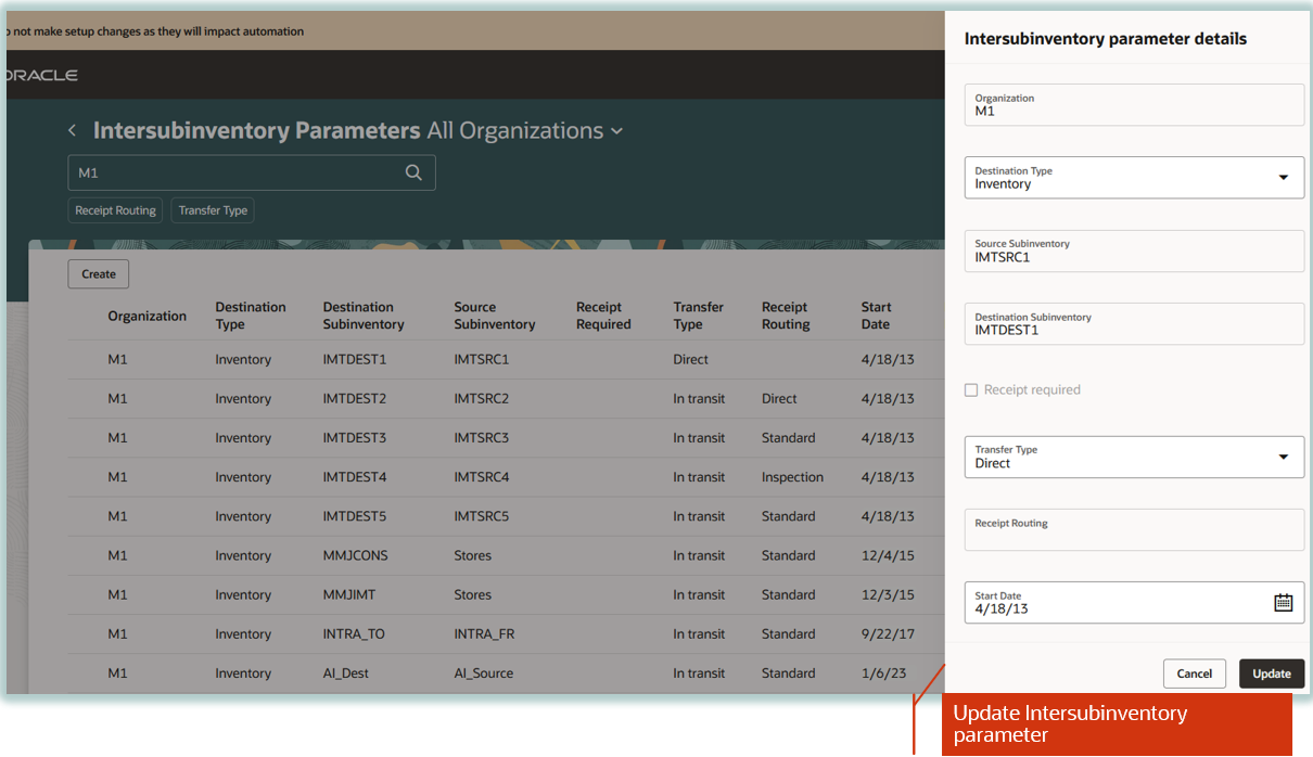

Here are some key points about updating intersubinventory parameters:
  • For an Inventory destination type, you can update both the source and the destination details for an intersubinventory parameter.
  • For an Expense destination type, you can update the receipt routing when the Receipt Required option is enabled.
  • You can update the destination type from Inventory to Expense, but you can't update the destination type from Expense to Inventory.
Update Intersubinventory parameter
Update Intersubinventory Parameters
This feature provides you the ability to create, update, and delete your intersubinventory parameters with an improved user experience.
