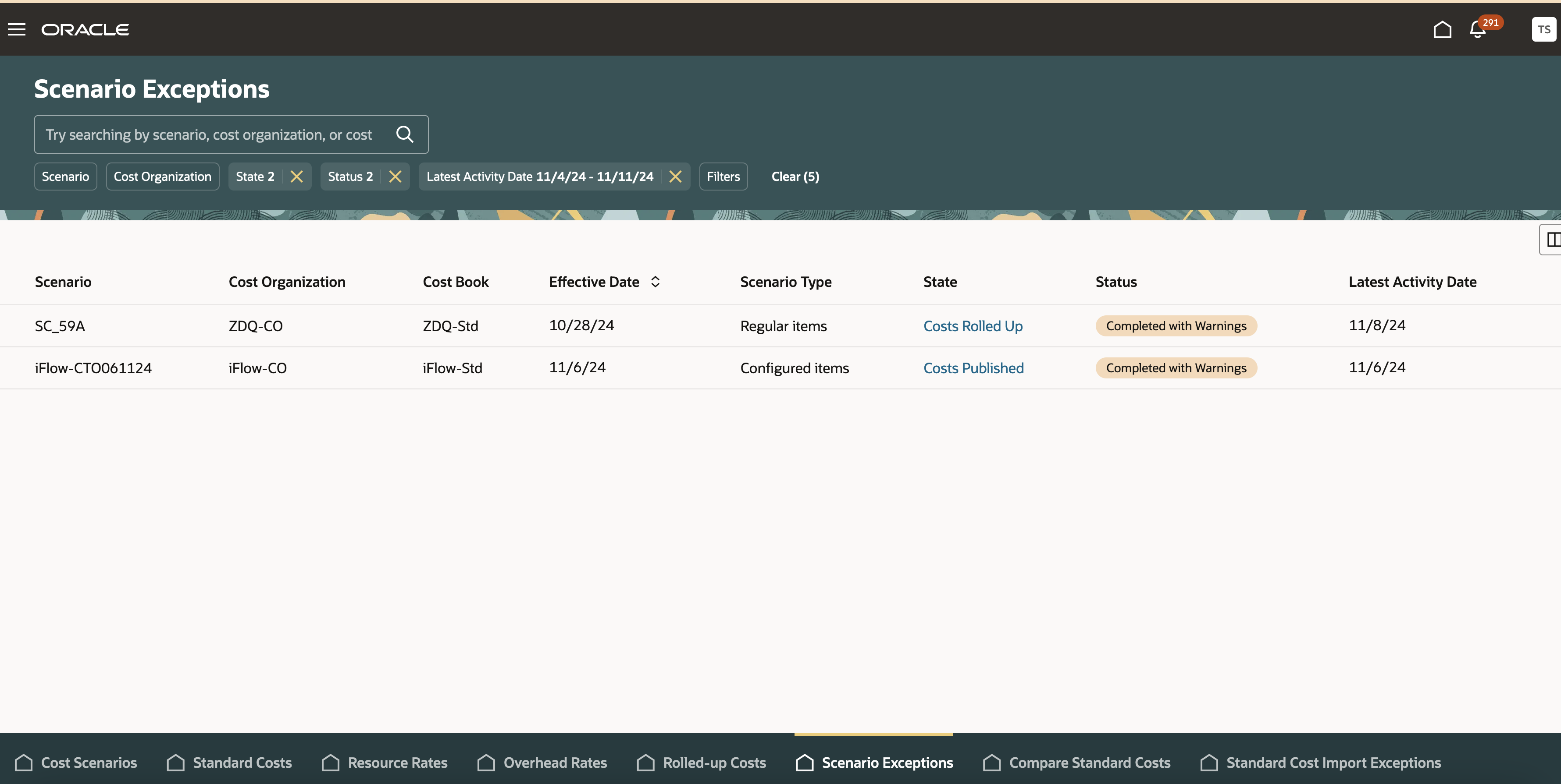

The Scenario Exceptions page displays all the exceptions for the cost scenarios that had activity in the last 7 days. You can search for the records and filter the results based on your requirements.
Scenario Exceptions Landing Page

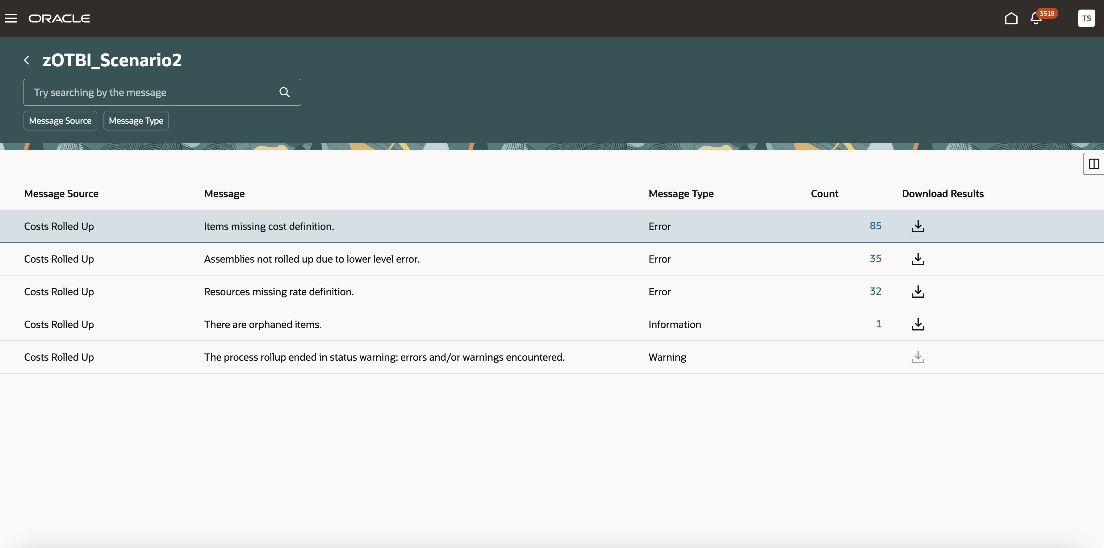

When you click on the state for a cost scenario, the page with all the exceptions logged for the scenario are displayed with the respective count. You can export the details of a specific message by clicking the download results icon.
Scenario Exception Details Page

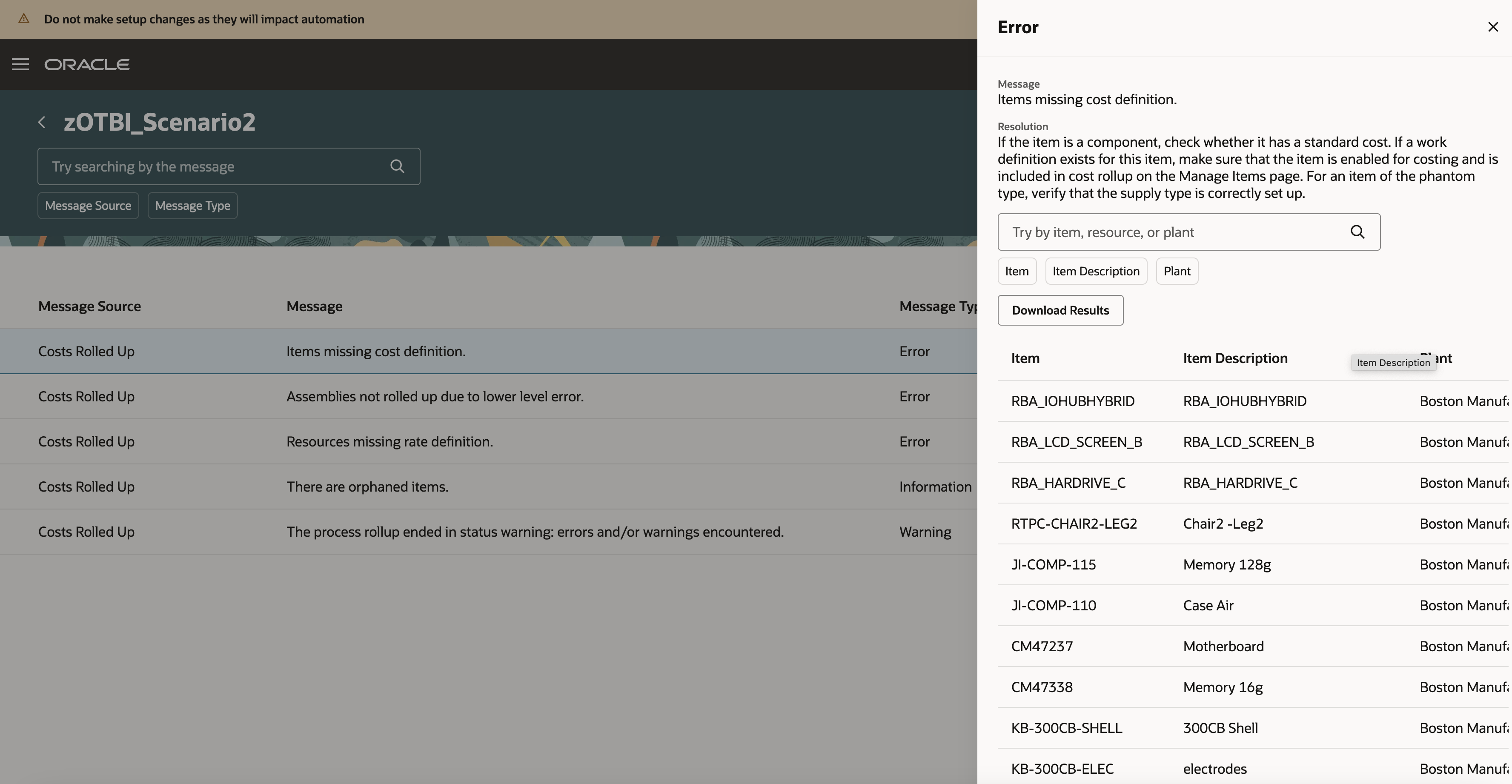

You can view the details of an exception message by clicking the count for that message.
Scenario Exceptions Messages
