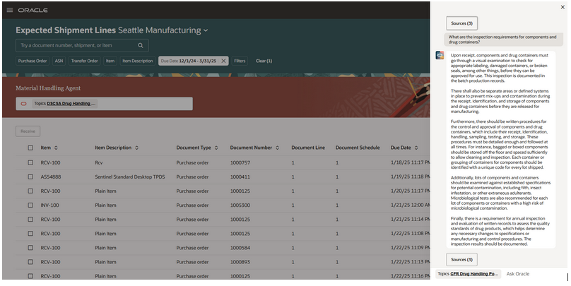

Deploy AI agents in guided journeys to answer user questions about standards, regulations, and policies, and to provide troubleshooting guidance. You can upload various sources of information for the AI agents, such as policy documents, regulations (industry, geographic, governmental), standard operating procedures, and more. Through a chat experience that's embedded in transactional pages, users can ask questions and get highly targeted responses sourced from these uploaded documents.
Example: Receiving Agent interacts with AI agent to inquire about material handling best practices to ensure compliance
