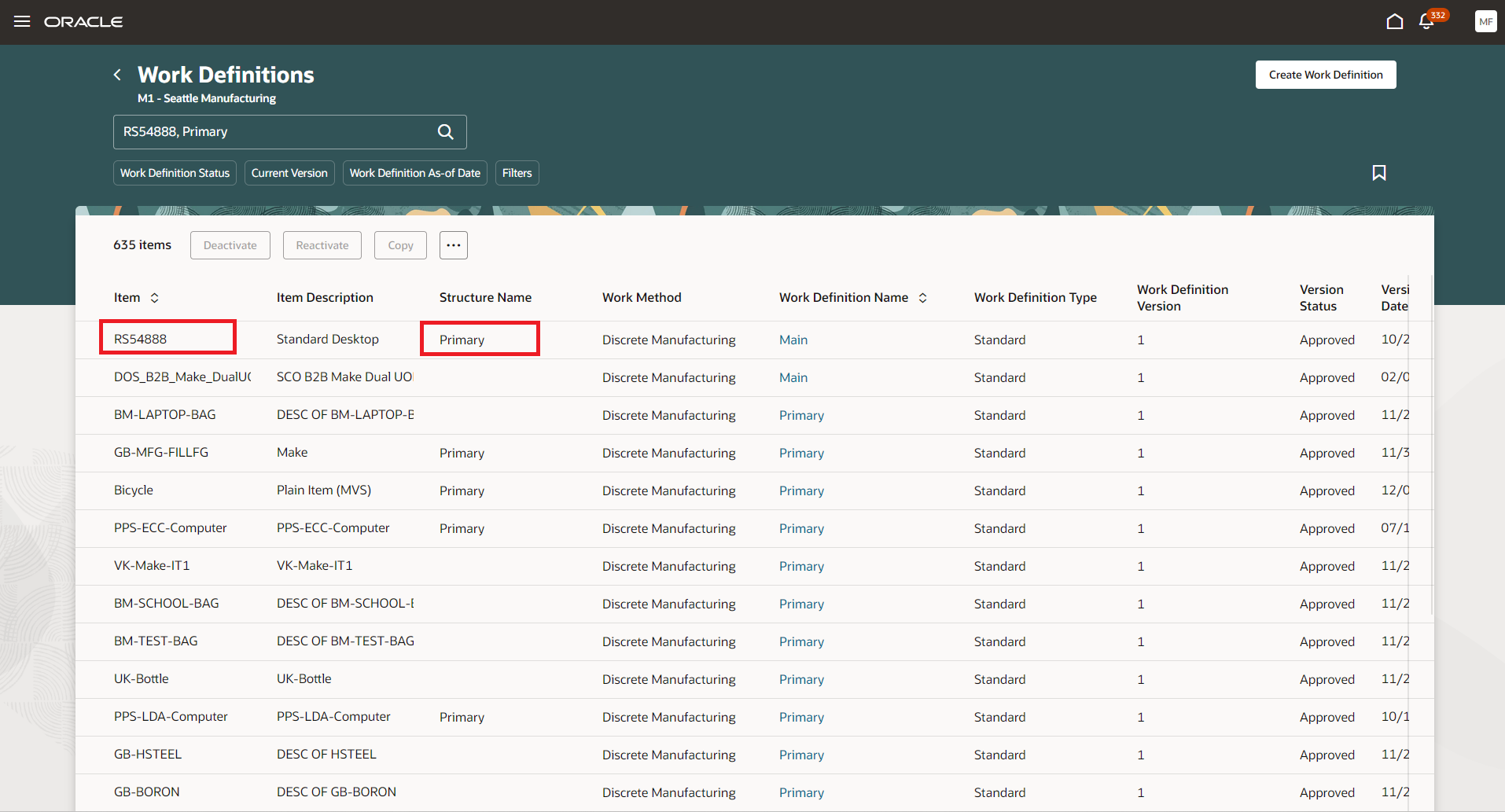

On the Redwood page for Work Definitions, you can search for the item, structure name, and work definition as of date to find the work definition versions that need review. From the item structure change notification, you can review the detailed changes and decide whether to edit an existing work definition version or create a new work definition version based on when the item structure changes become effective in Product Information Management.

- On the Work Definitions page using the Redwood user experience, you can search for work definitions that align to the item structure change notification by entering the item, structure name, and work definition as of date as the change effective date specified in the notification. Make sure the organization selected matches the organization specified in the notification.
