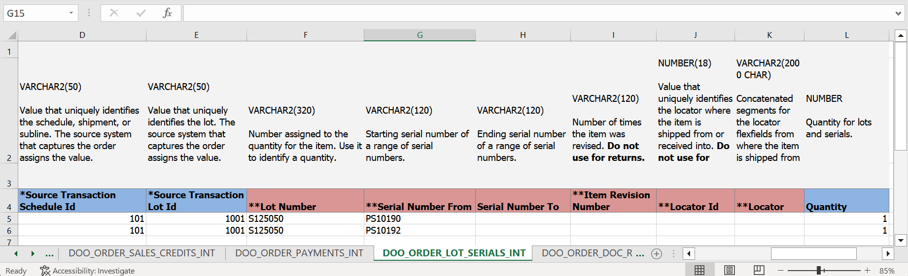

Here's a similar example from the DOO_ORDER_LOT_SERIAL_INT worksheet of SourceSalesOrderImportTemplate.xlsm for file-based data import:

Get more flexibility when you return a sales order. You can now return it when the lot or lot and serial aren't in sequence.
Steps to Enable
Starting with update 25A, if you specify the lot or the lot and serial in a return order and they are out of sequence, then you must do this set up.
Add a profile option.

Tips And Considerations
  • Enable the profile only if you specify the lot or lot and serial in a return order.
  • If you include only serials, then you won't encounter an error even if they're out of sequence and you don't include a quantity for them.
