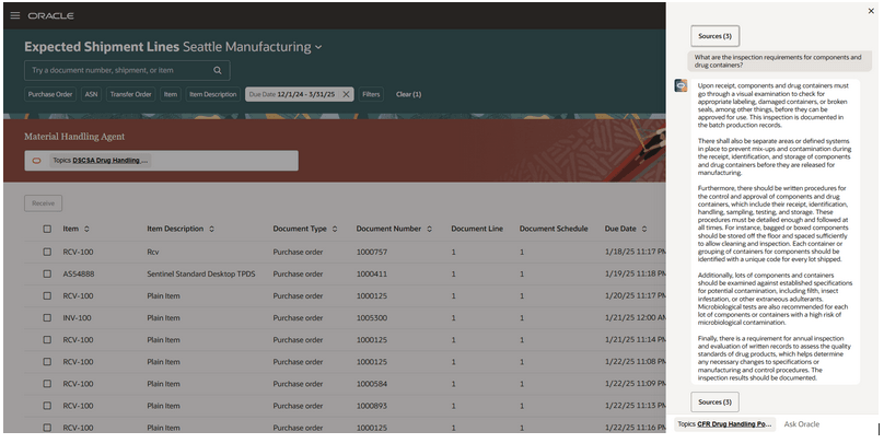

Receiving Agent Example
Example: Receiving Agent interacts with AI agent to inquire about material handling best practices to ensure compliance

Material Handling Advisor Provides comprehensive instructions to ensure adherence to material handling best practices, focusing on:
Safety and Equipment Compliance
Supports receiving agents in using appropriate safety gear and material handling equipment to align with applicable regulatory requirements, such as FDA and CGMP standards.
