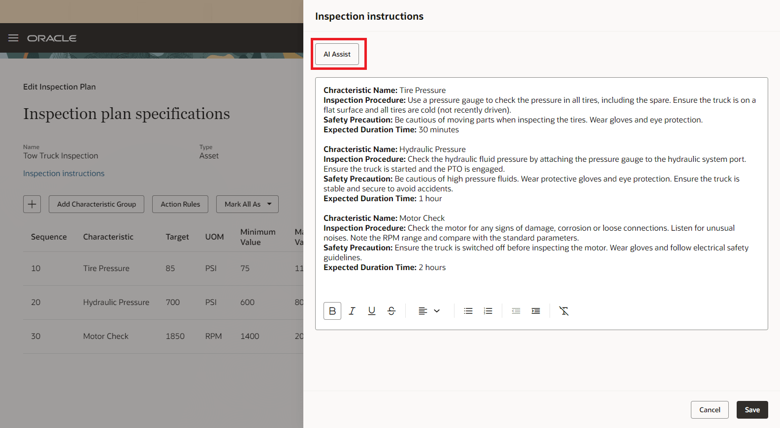

As a quality engineer, you can invoke the Generative AI to create or suggest inspection instructions based on the preliminary information.
With Generative AI enabled for inspection plan authoring in Redwood experience, you can fast-track the creation of a quality inspection plan. On the Inspection Plan Specifications page, click the new AI Assist button to generate a list of suggested inspection instructions that you can review and include in the quality document.
Do the following:
  1. Enter preliminary information in inspection details, such as inspection type and the relevant object, like item, asset, or resource.
  2. Define your inspection plan specifications.
  3. Click on the Inspection instructions link above the specifications table.
  4. Click the AI Assist button on top of the Inspection instructions panel drawer to generate inspection instructions.
  5. Review, edit, and accept the AI proposed inspection instructions.
Generate Inspection Instructions
The accepted inspection instructions become part of the quality inspection plan.
