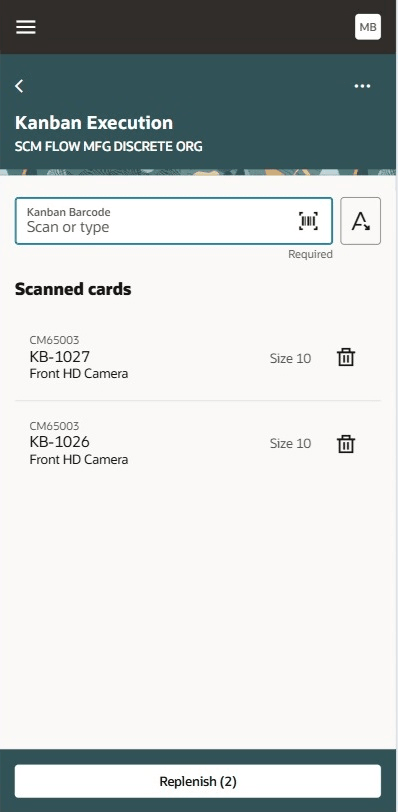

Kanban cards enable warehouse operators to efficiently signal material replenishment by scanning when a bin or container is running low. With real-time capabilities, you can now send replenishment signals to suppliers or within your organization using a mobile device, tablet, or desktop. You can walk up to a kanban location, scan the physical cards in sequence, and compile a list for review before finalizing the replenishment request.
Scan and replenish kanban cards
Scan and Replenish Kanban Cards
Kanban execution of material replenishment becomes a simplified warehouse task without continuous monitoring of inventory levels.
