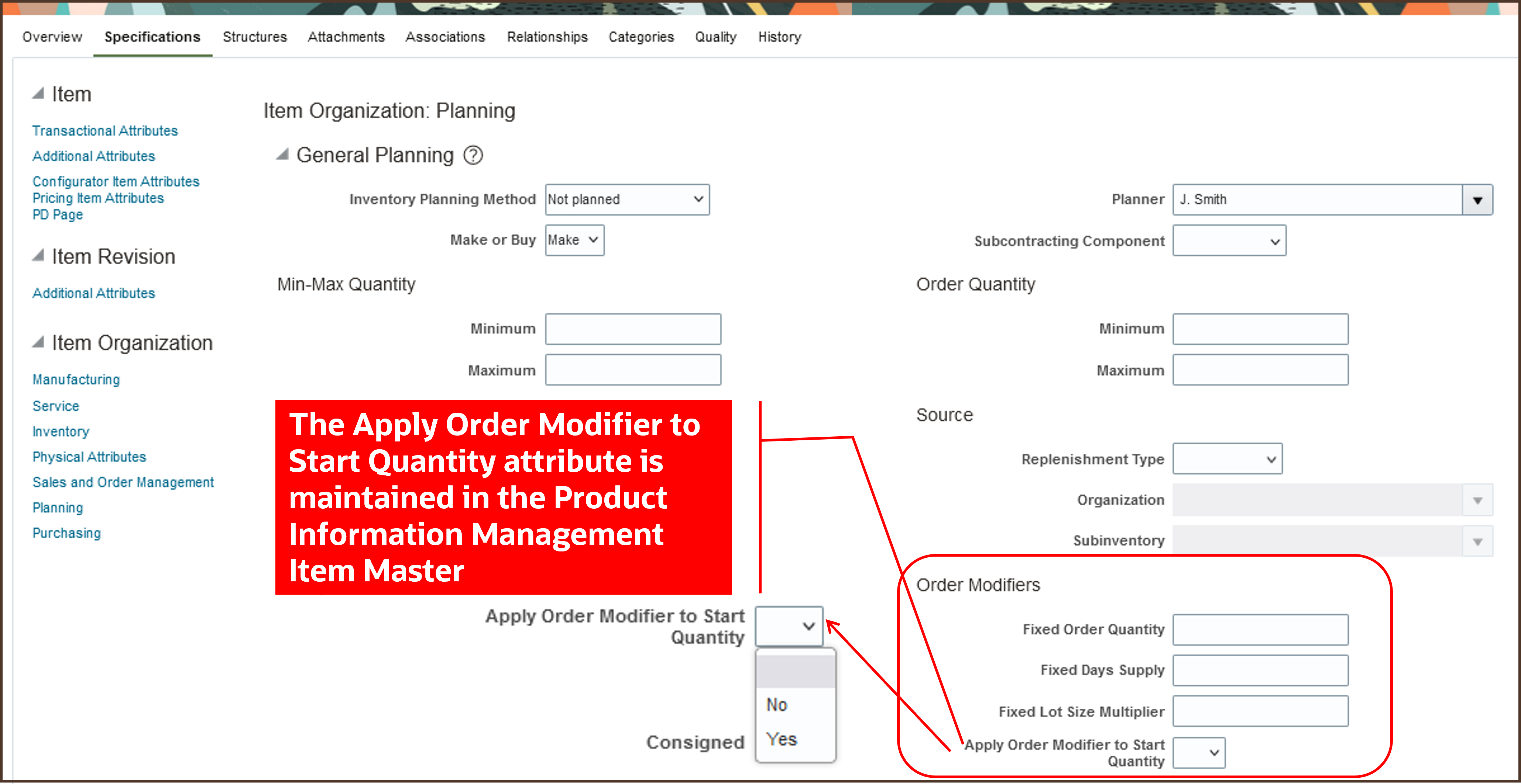

For certain items, the order modifiers of Fixed Order Quantity, Fixed Days Supply, and Fixed Lot Size Multiplier can be applied to either the Start Quantity or the Order Quantity. This is done by using the Apply Order Modifier to Start Quantity attribute, which is located in the Product Information Management work area in the Item planning specifications.
Apply Order Modifier to Start Quantity Field

The Apply Order Modifier to Start Quantity attribute is available and can be edited on both the Items page and the Items Simulation page.
