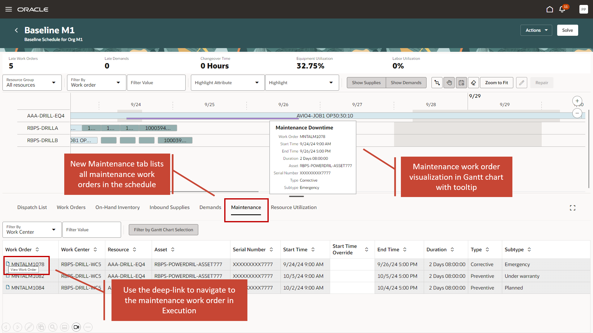

Maintenance Tab and Gantt Visualization.
A maintenance work order on a resource with default units available greater than one is visible on the parent row only. If multiple maintenance work orders are scheduled on a resource with overlapping start and end times, then they are displayed with vertical offsets.
Selecting a row in the Maintenance tab will select the corresponding maintenance work order in the Gantt chart, and vice versa. To find specific maintenance work orders, you can filter by work order or resource in the Maintenance tab or use the Filter by Gantt Selection capability.
To change the timing of a maintenance work order for scenario purposes within Production Scheduling, you can enter a Start Time Override in the Maintenance tab. The Start Time Override is considered by subsequent Solve actions, but is not synchronized to Cloud Supply Chain Execution because maintenance work orders are not included in Production Scheduling’s release process. You can use the deep link to easily navigate from Production Scheduling to the maintenance work order in Cloud Supply Chain Execution and enter desired changes there.
