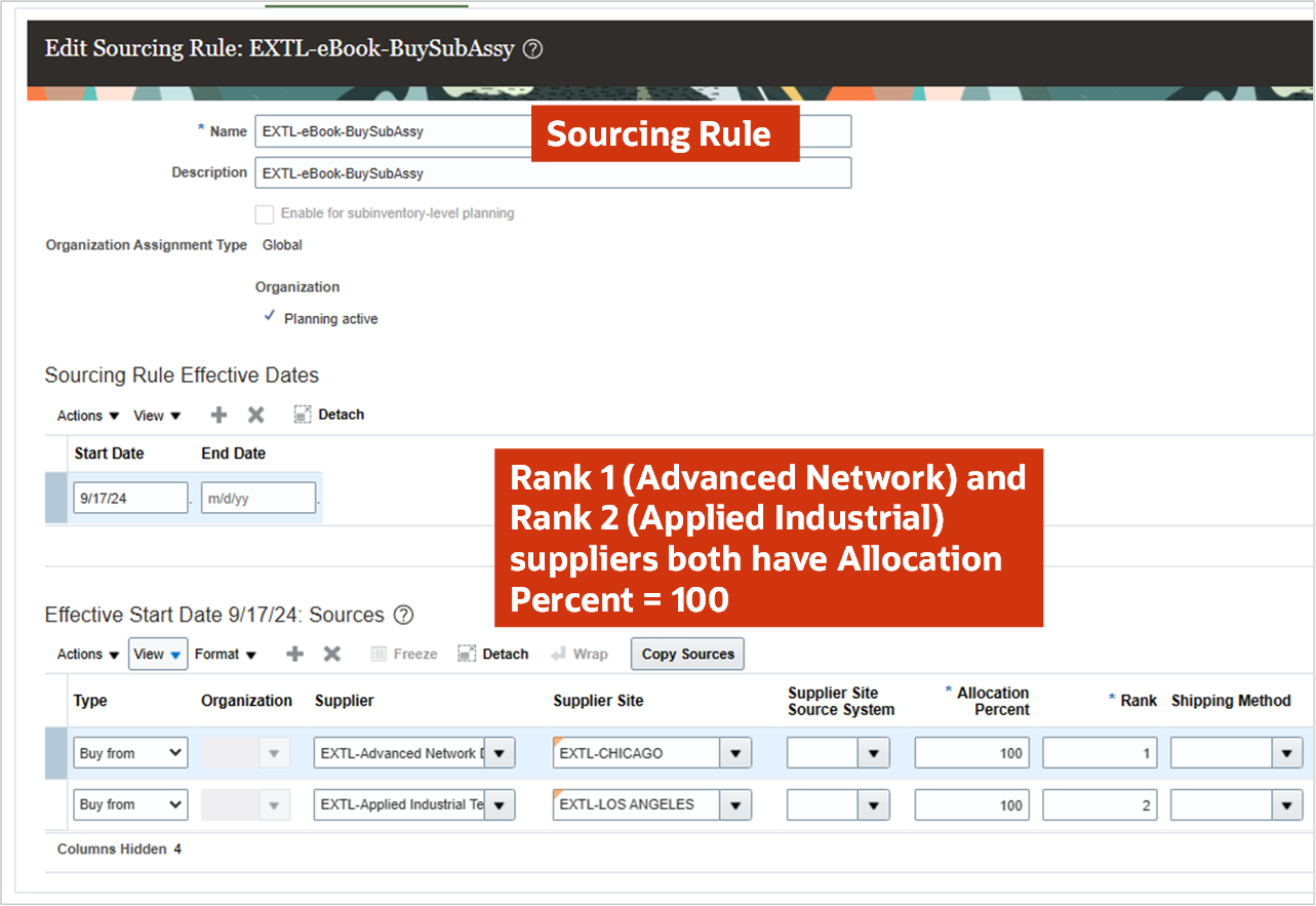

Consider a supply chain in which you buy component items for the MFG manufacturing organization from both primary Supplier1 and alternative Supplier2. Sourcing rules with Rank 2 sources are transformed into Rank 1 sources with Allocation Percent equal to 0 during a sales and operations plan run.
Rank 2 Sources Transformed Into Rank 1 with Allocation Percent Equal to 0

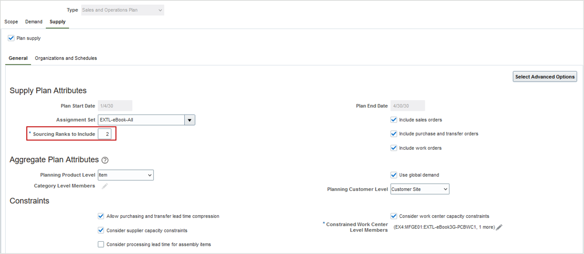

- On the General subtab on the Supply tab on the Plan Options page for the sales and operations plan, modify the value for Sourcing Ranks to Include from the default value of 1.
General Subtab on Supply Tab on Plan Options Page for Sales and Operations Plan
- Run the sales and operations plan with the Refresh with current data option selected. Sourcing Ranks to Include is used to consider multiple ranks up to and including the value specified for this option for sourcing rules in the plan’s assignment set. In this case, the plan transforms sourcing rules with Rank 2 sources into Rank 1 sources with Allocation Percent equal to 0.

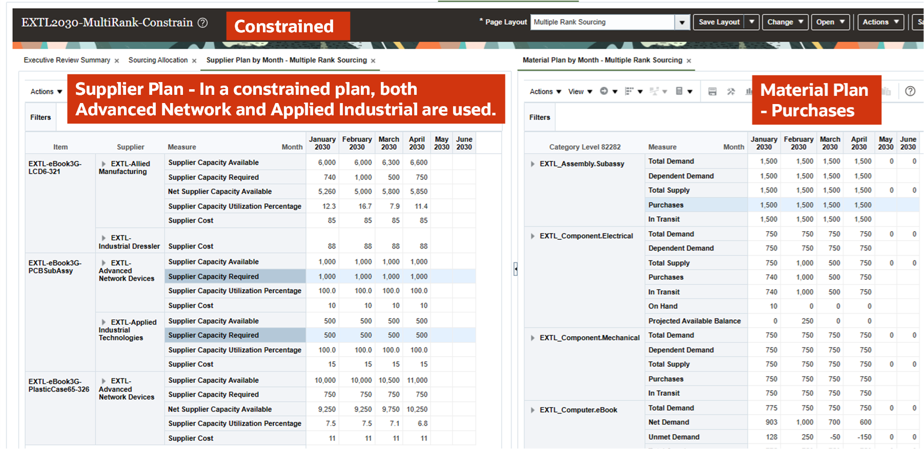

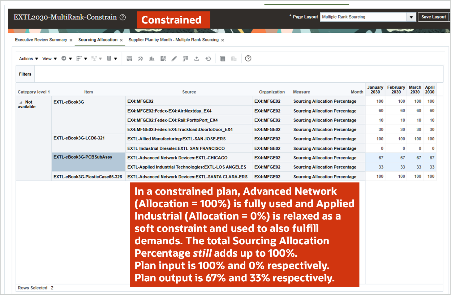

In a constrained plan, sourcing allocation is considered as a soft constraint. If an alternative source must be used to meet demands, then it can be used.
Sourcing Allocation Percentage in a Constrained Plan
Alternative Source Used in a Constrained Plan
