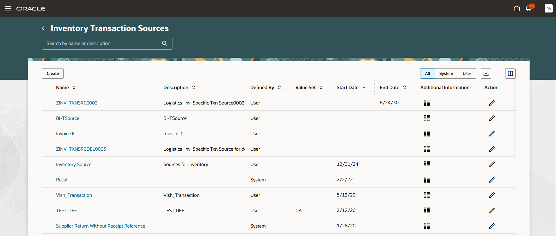

 Inventory Transaction Sources Landing Page

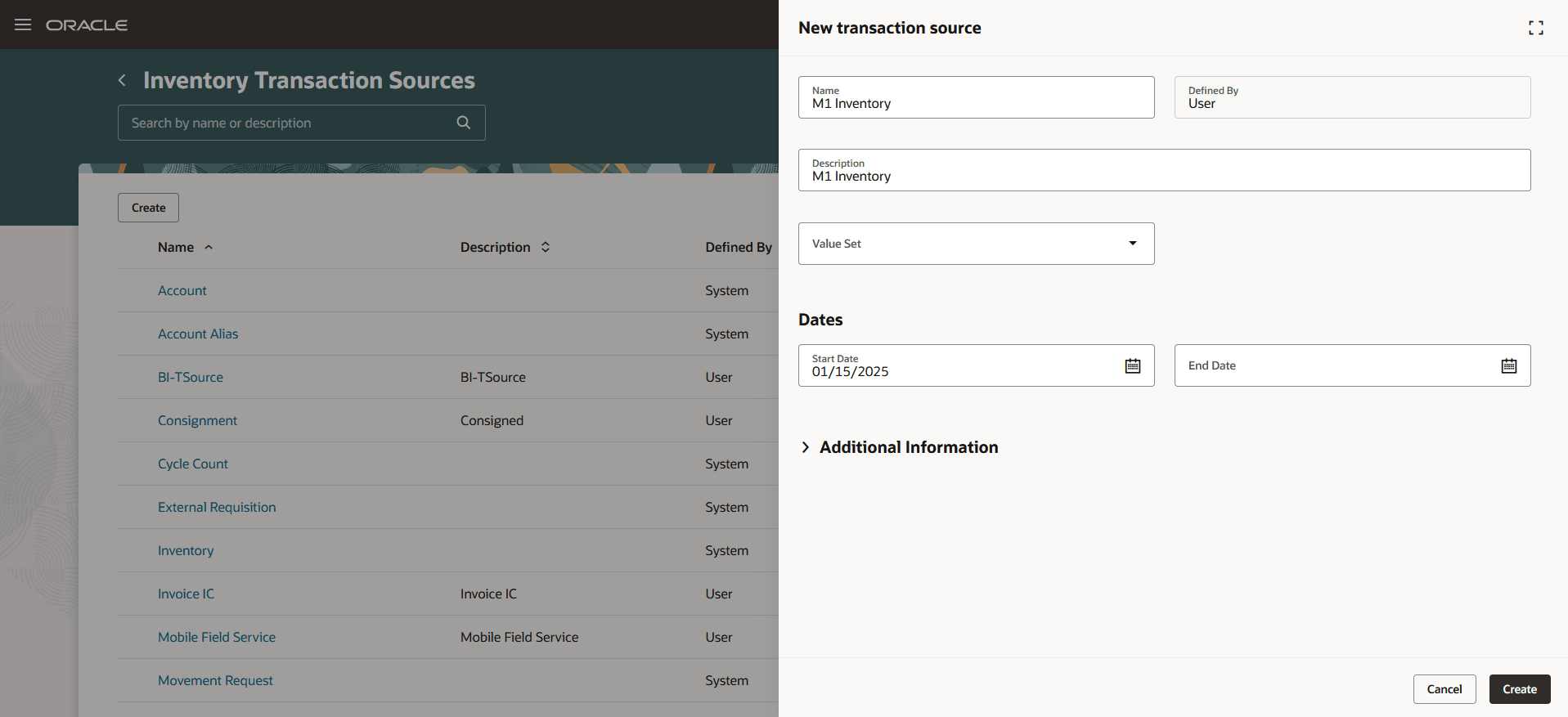

To create a new inventory transaction source, click Create and enter the required details such as the source name, description, and relevant dates. Specify a Value Set if applicable. Use the Edit icon to update an existing transaction source.
Create Transaction Source

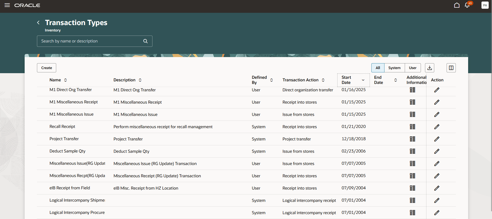

To create a new inventory transaction type for a source, select the relevant transaction source by clicking its link on the Inventory Transaction Sources landing page. This opens the Transactions Types page where you can click the Create button to create a new transaction type. In the New Transaction Type drawer, enter details like the transaction type name, description, transaction action, and applicable dates. Specify additional details, such as: Enable status control, Allow project transactions, and Location required. Use the Edit icon to update an existing transaction type.
 Inventory Transaction Types Page
