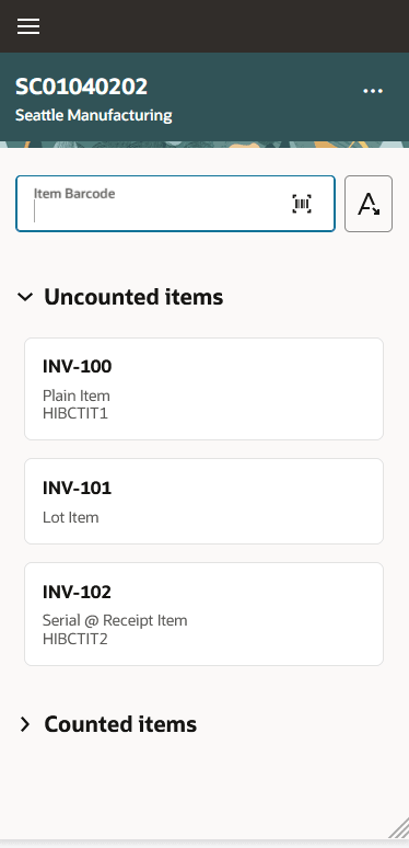

Item Search Capability
The item scan field has been added to the top of the Uncounted Items list, letting users quickly search for an item.
Item Scan Field

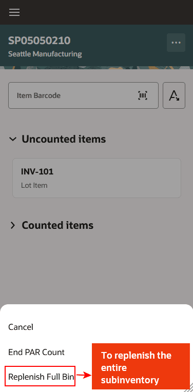

Replenish Full Bin Action for PAR Subinventory with Two-Bin Replenish Count Method
For nonlocator-controlled PAR subinventories, you can now replenish the entire subinventory using the Replenish Full Bin action.
Replenish Full Bin for Nonlocator Controlled Subinventory

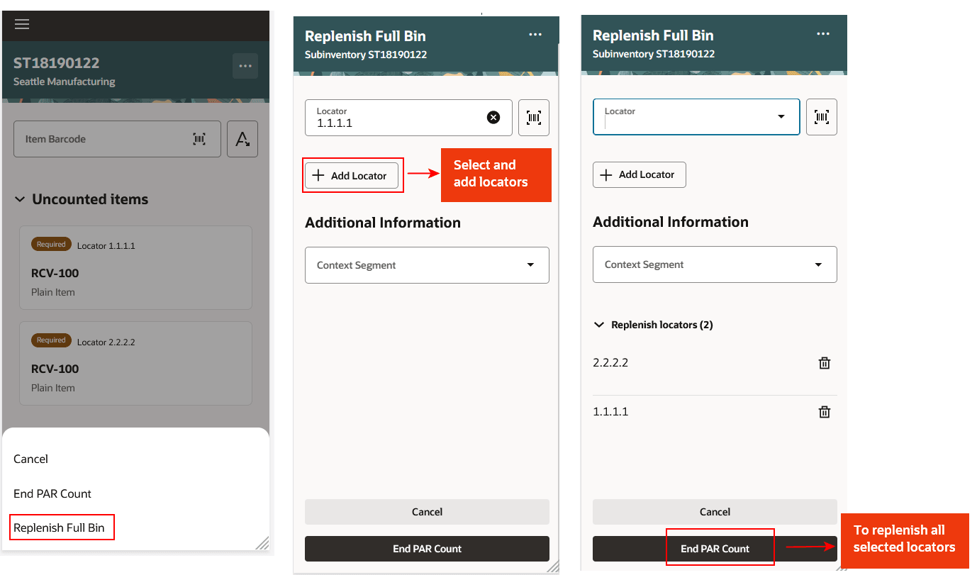

For locator-controlled PAR subinventories, you can now replenish the entire subinventory using the Replenish Full Bin action.
Replenish Full Bin for Locator-Controlled Subinventory

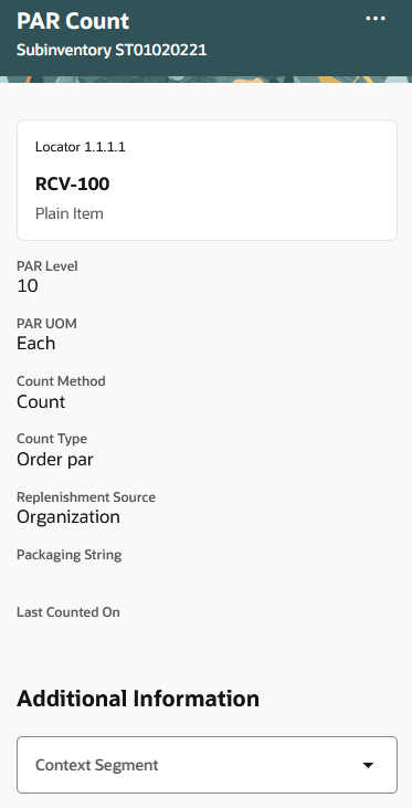

New Fields
The PAR Count pages now include multiple fields:
- Count Type: Specifies the replenishment count type
- PAR Level: Defined PAR level for the item
- PAR UOM: Unit of measure for the PAR level item
- Replenishment Source: Source responsible for replenishment
- Packaging String: Represents the packaging hierarchy
New Fields

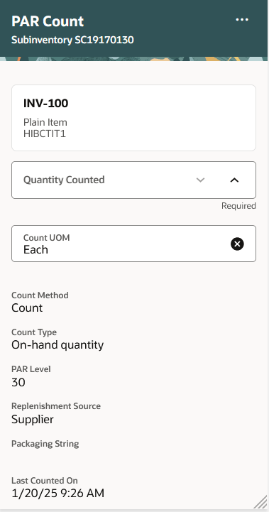

Ability to Change Count Unit of Measure
You can now modify the count unit of measure when the replenishment Count Method is set to Count and the default replenishment Count Type is set to On-Hand Quantity.
Change the Count UOM
