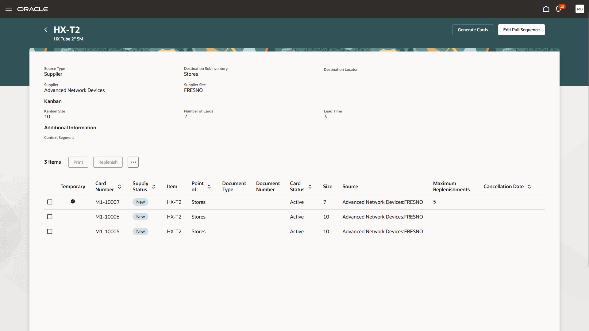

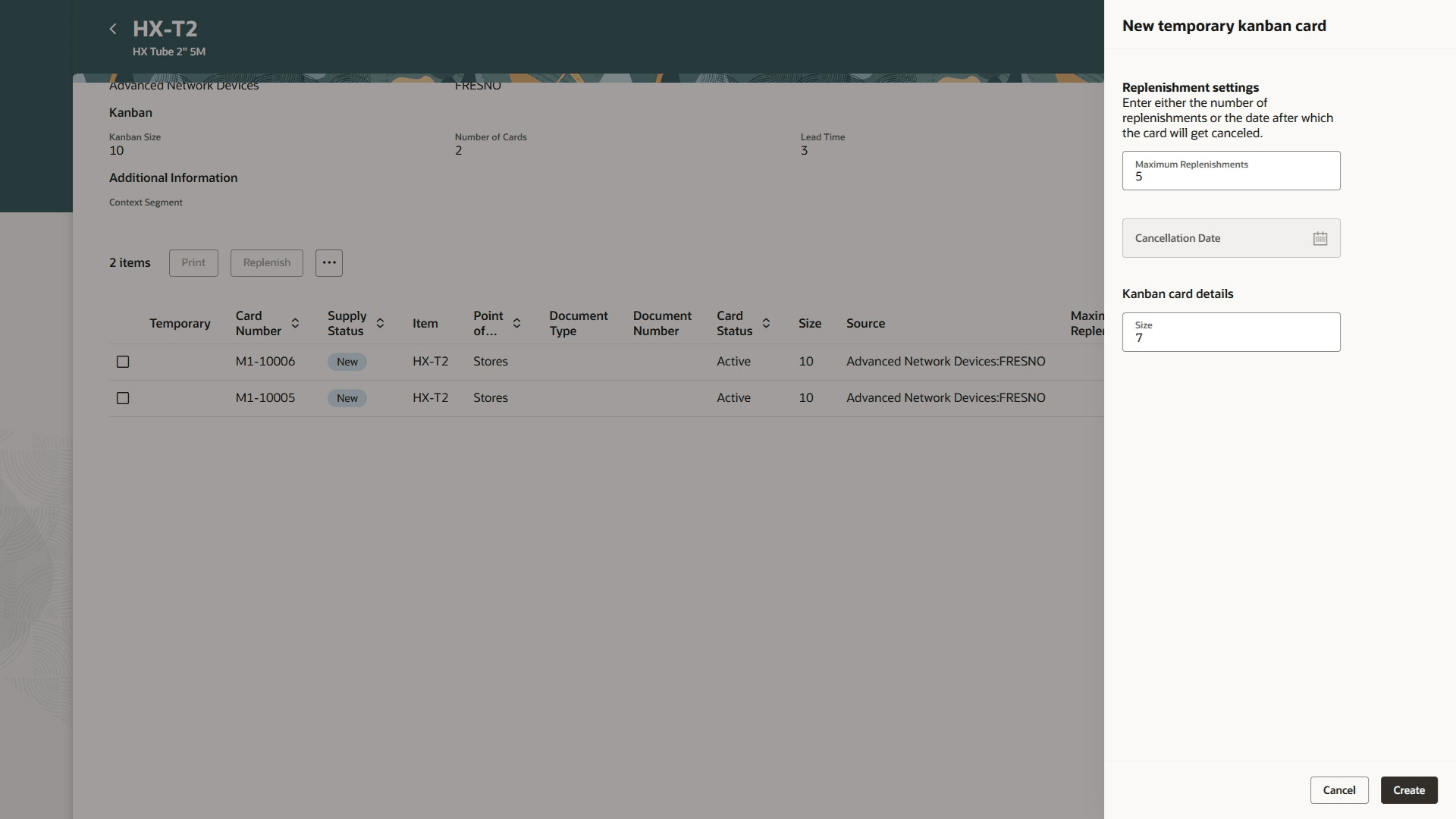

Time sensitive projects, such as those related to prototyping or testing, and other abrupt, unforeseen situations may require you to replenish material on a temporary basis in place of the normal recurring basis that is driven by the rate of consumption. You can now extend the definition of a pull sequence to add a temporary kanban card in response to an increase in demand. You can also set the maximum number of replenishments or a cancellation date for the temporary kanban card. Just like a kanban card, the temporary kanban card can be sourced both internally and externally, printed as an attachment to a bin, and updated through the lifecycle of supply statuses to indicate whether it is new, full, empty, or in process relative to the replenishment process. When either the maximum replenishments number or the cancellation date is reached, the temporary kanban card is cancelled upon next replenishment.
Temporary kanban card generation
Generating a Temporary Kanban Card with a Size Different from the Pull Sequence
Icon to identify temporary kanban in pull sequence page
Check Mark in the Temporary Column Identifies the Temporary Kanban Card on the Pull Sequence Page
