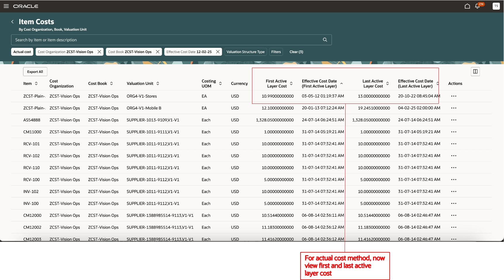

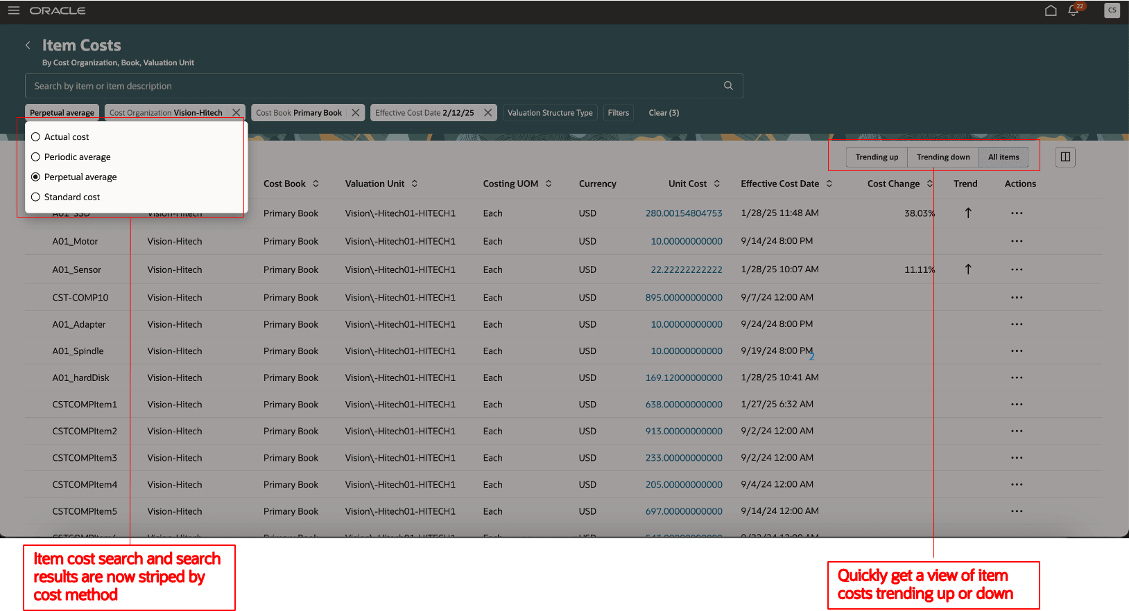

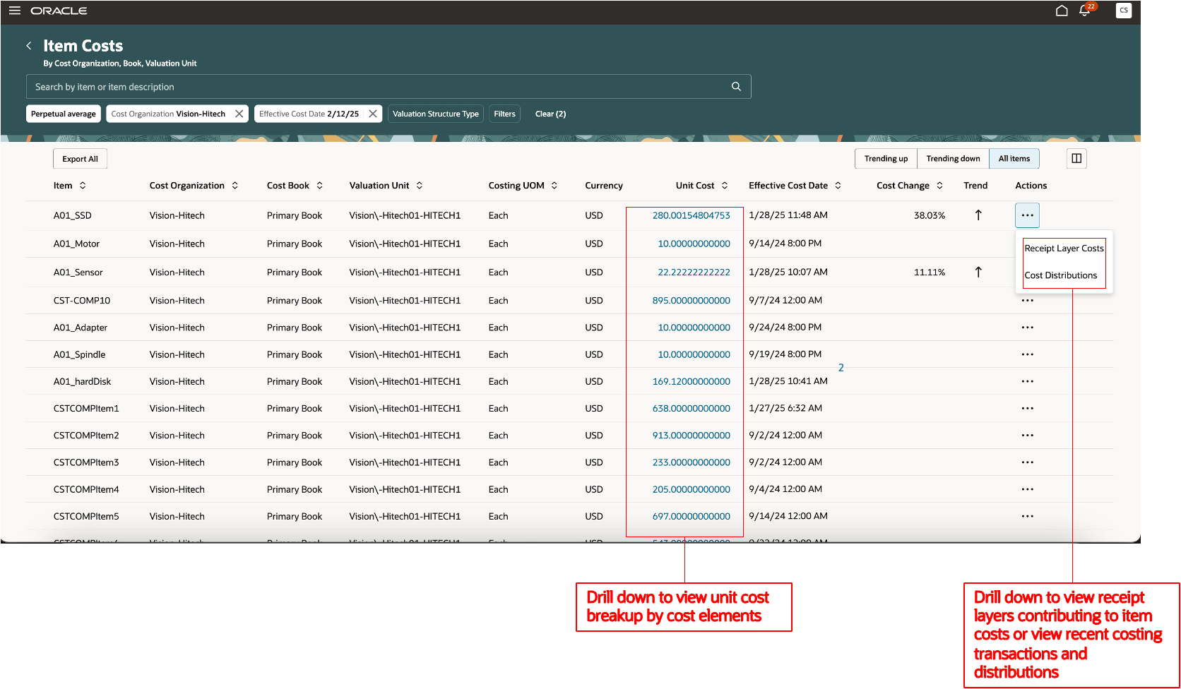

The Item Costs page helps you analyze and understand the as-of-date cost of an item for a valuation unit based on the cost method selected for the cost organization and cost book. You can also drill down to view receipt layers making up the item cost in case of perpetual average, actual cost, and periodic average cost method. The page has been enhanced in Redwood to now stripe search and search results by cost method for better usability and performance. You can now also drill down to view recent costing transaction and distributions for the item.
Data Striping of Item Costs by Cost Method to boost performance
Search Filters and Search Results are optimized for each cost method
Seamless navigation to drill down into details

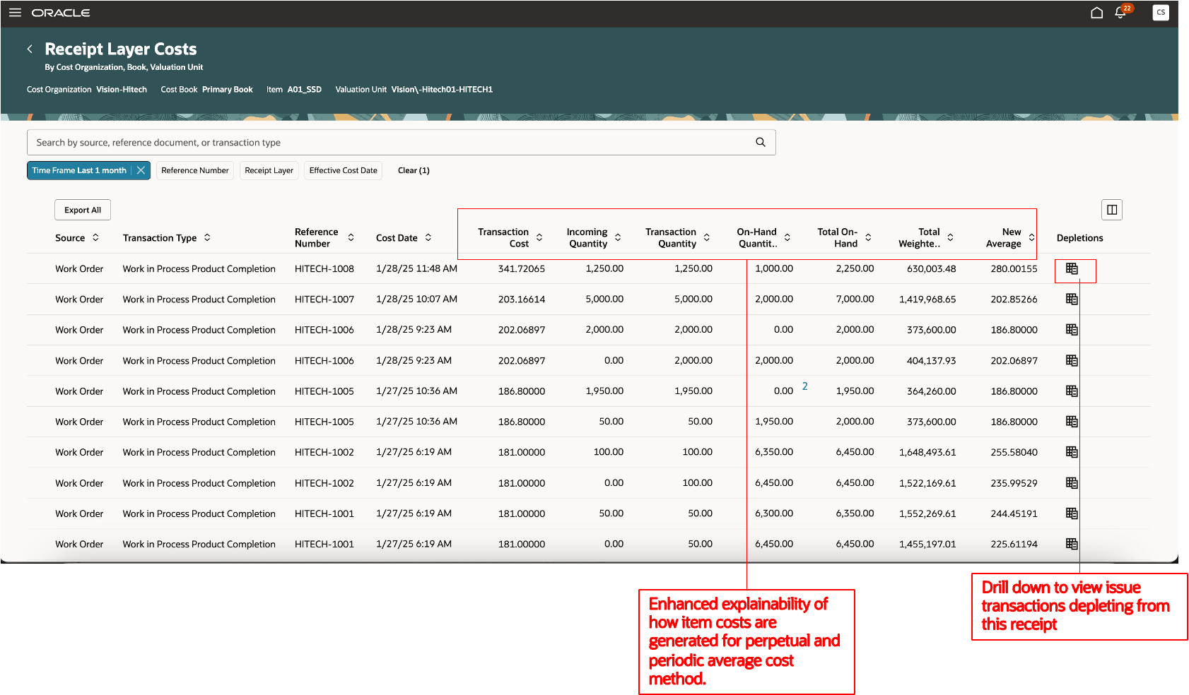

Enhanced explainability of data
Enhanced explanation of data
