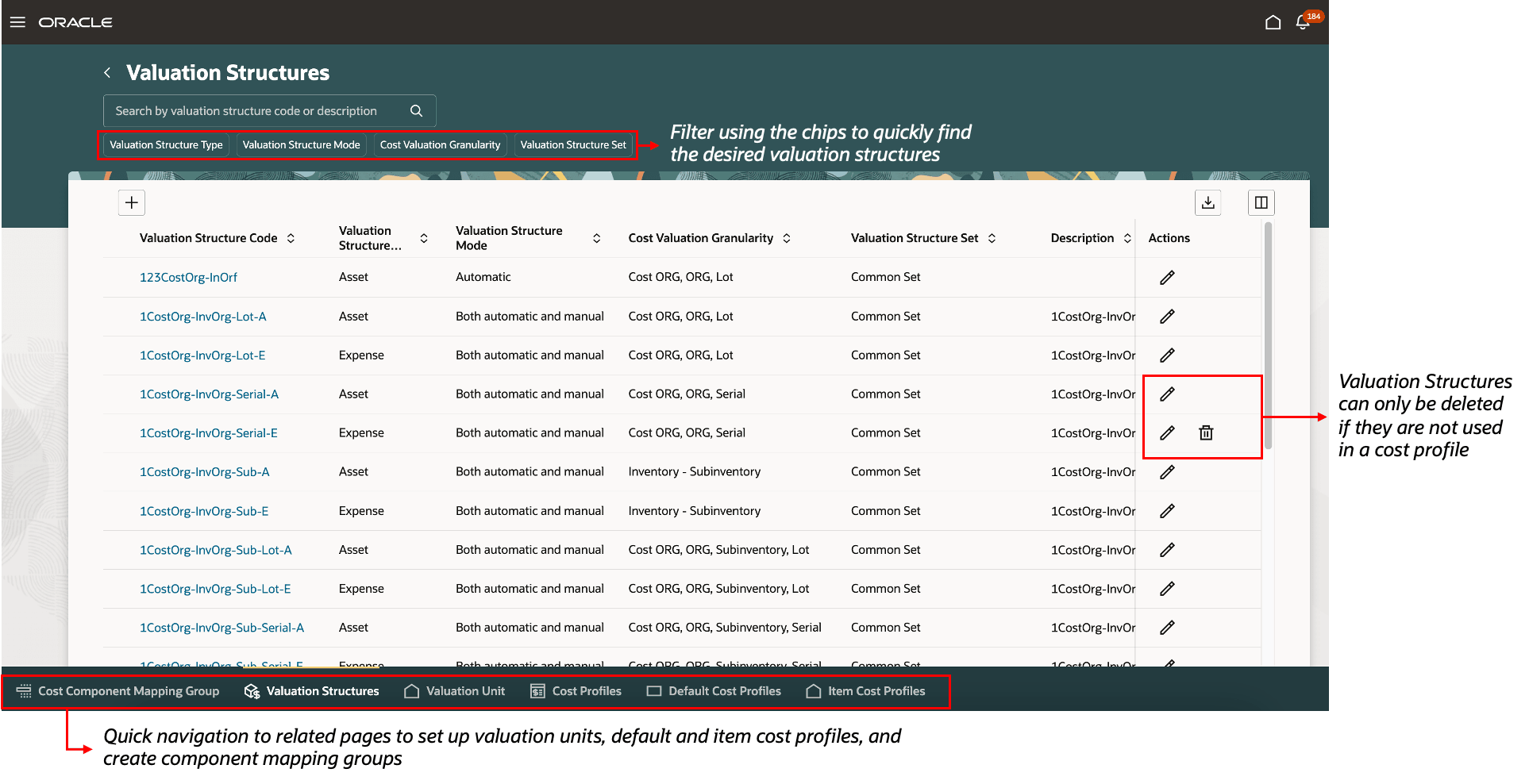

The Valuation Structures page displays all the valuation structures, sorted by last updated date in the descending order, by default. You can search for valuation structures and filter the results based on your requirements using these options:
  • Valuation Structure Type (Asset, Expense or Consigned)
  • Valuation Structure Mode (Automatic, Manual or both)
  • Cost Valuation Granularity
  • Valuation Structure Set
You can modify the valuation structure mode and description. You can delete a valuation structure only if it hasn't been used in a cost profile. You can easily access the related setup pages using the navigation links at the bottom of the page, which provides a holistic view of the valuation structures setup flow.
Figure 1: Valuation Structures Setup Page

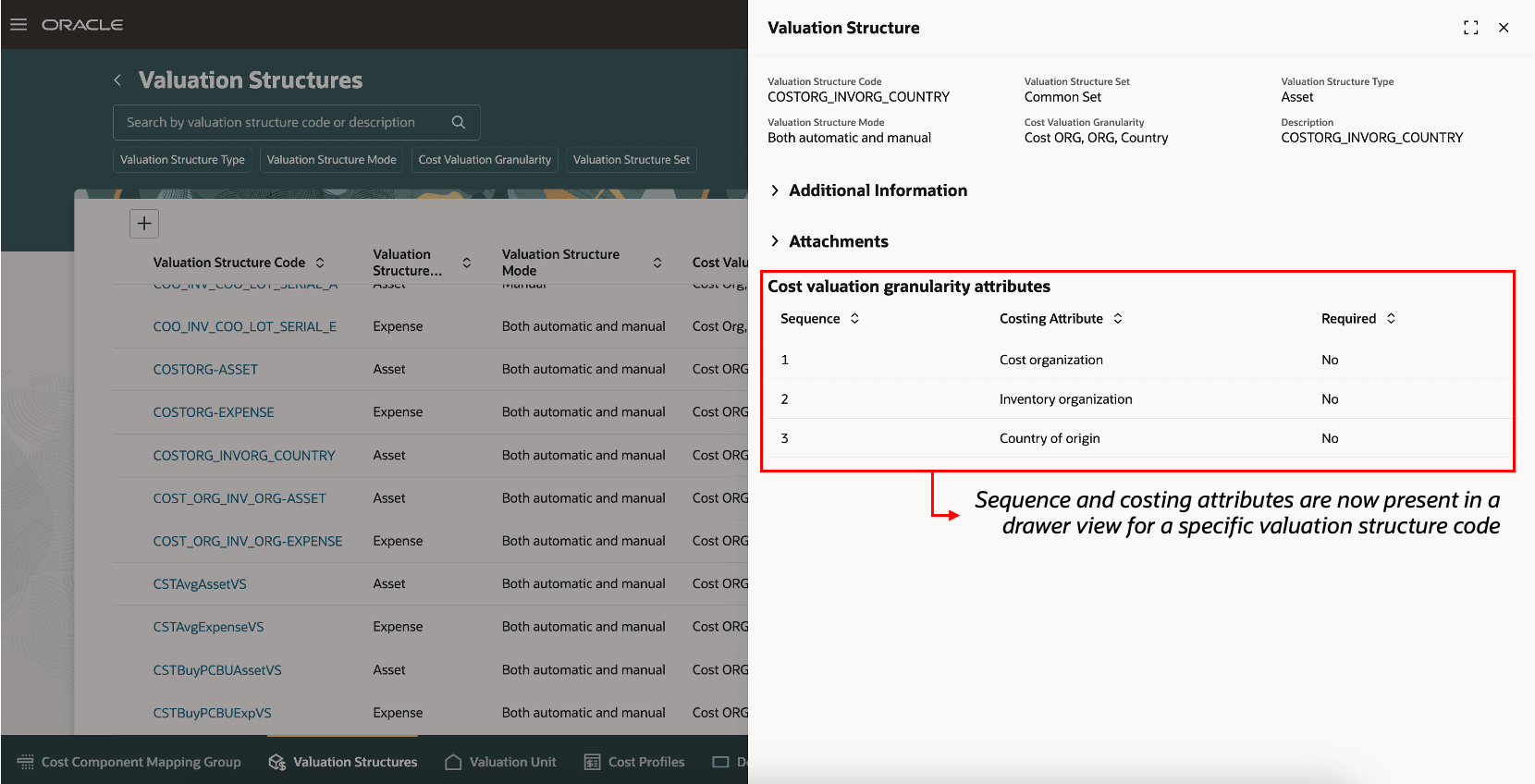

In the Redwood page, you can now view cost valuation granularity attributes by selecting the valuation structure code. The flexfield structure is referred to as Cost Valuation Granularity.
Figure 2: Valuation Structures Details with Granularity Attributes

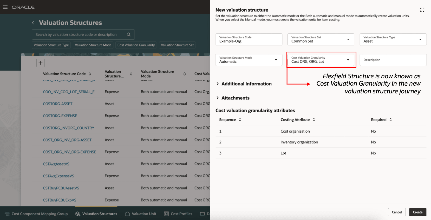

Create New Valuation Structure
Click the Add (+) button to create a new valuation structure.
Figure 3: Create New Valuation Structure
