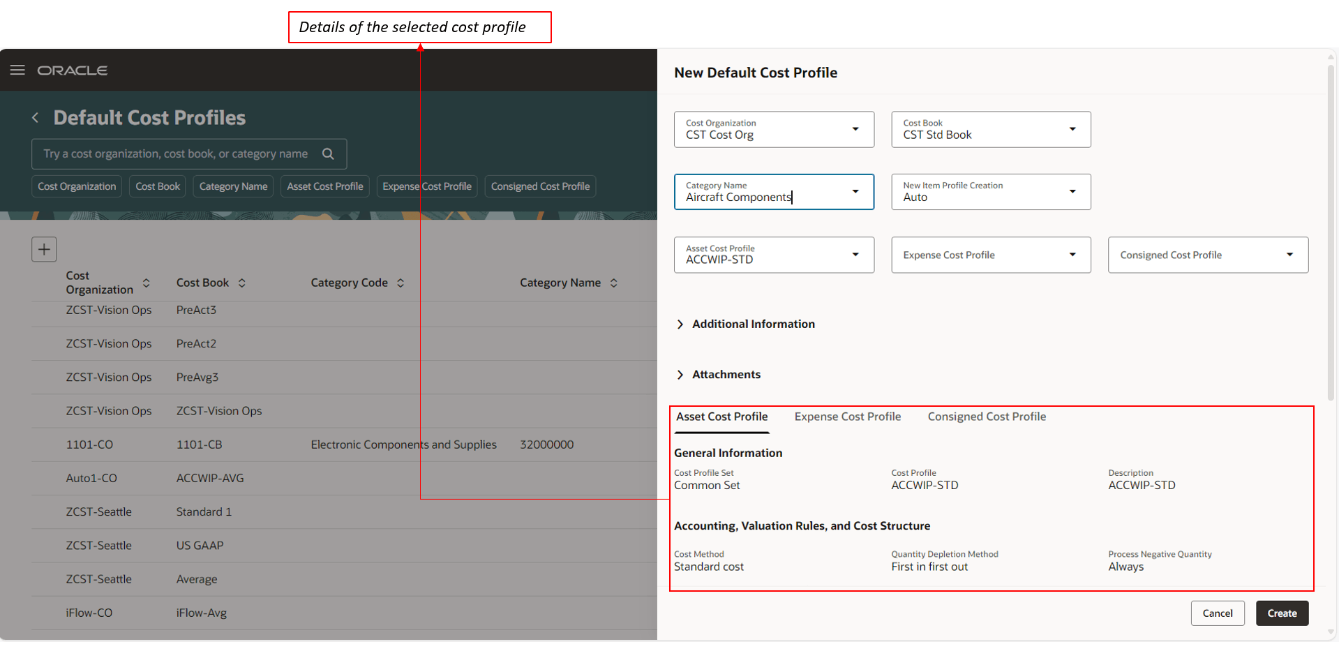

Create Default Cost Profile
Click the Add (+) button to create a default cost profile. You can see the details of the corresponding Asset, Expense, and Consigned cost profiles while you are creating the default cost profile.
Create Default Cost Profile page
