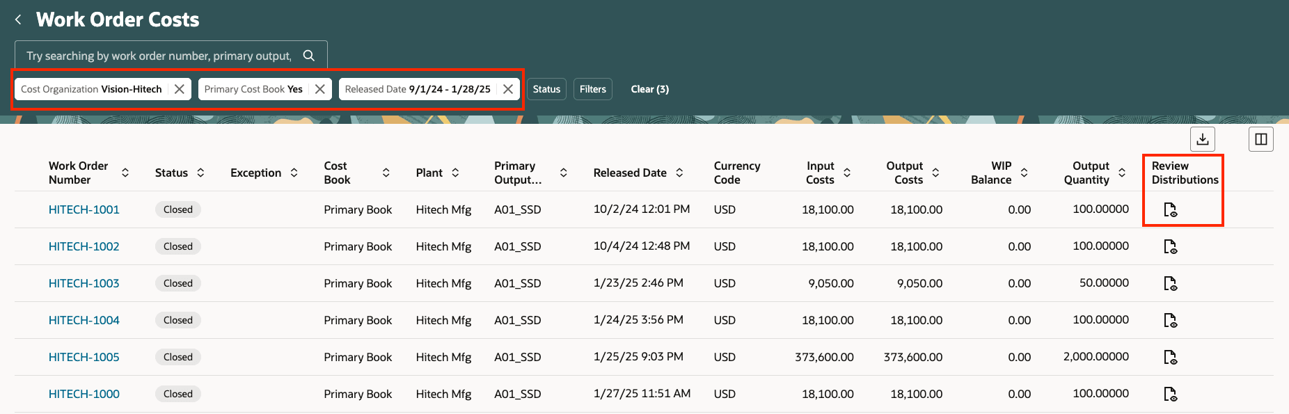

The landing page provides a quick summarized view of the costs with an option to add more columns that are hidden by default. You can also use the additional filters to add more context to your search results.
Work order costs landing page

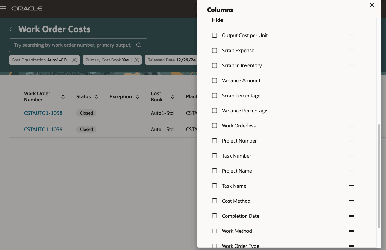

Use the Customize Columns option to hide or show additional columns that provide more information on the work order and the costs.
Additional columns in the work order costs page

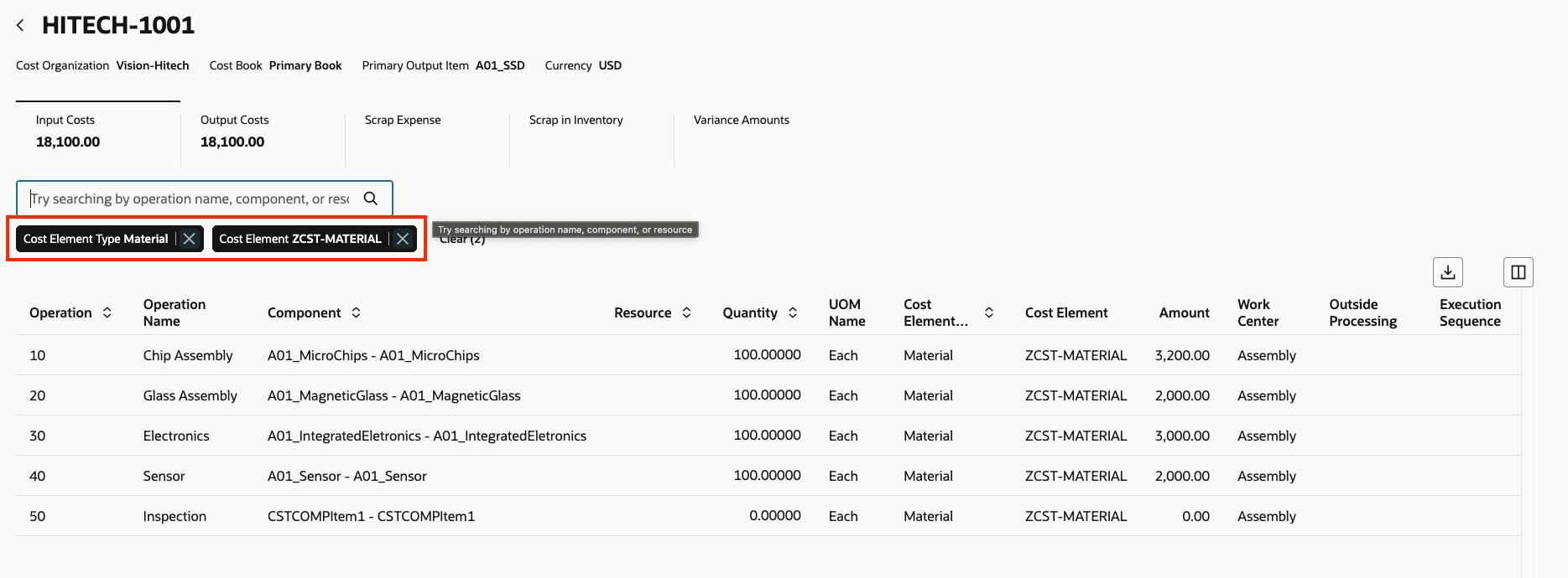

Click the work order number link to access the work order costs page where you can view more details on the inputs, outputs, scrap, and variance. Use the filter chips and smart search to quickly drill down to an operation, component, resource, cost element type, or cost element level details.
Input cost details
Input cost details

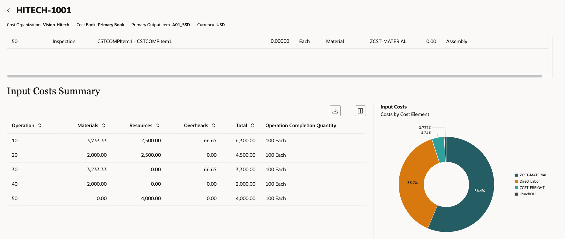

The Input Costs tab also provides a summarized view of material, resource, and overhead costs by each operation.
Input cost summary
Input cost summary

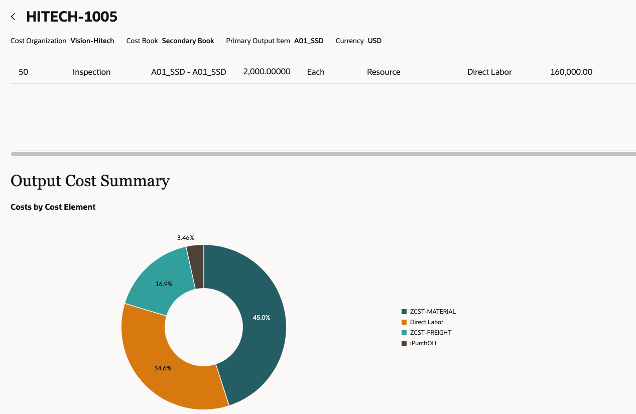

The Output Costs tab shows the summary view and the details view of the products completed in the work order.
Output Costs Summary and Details

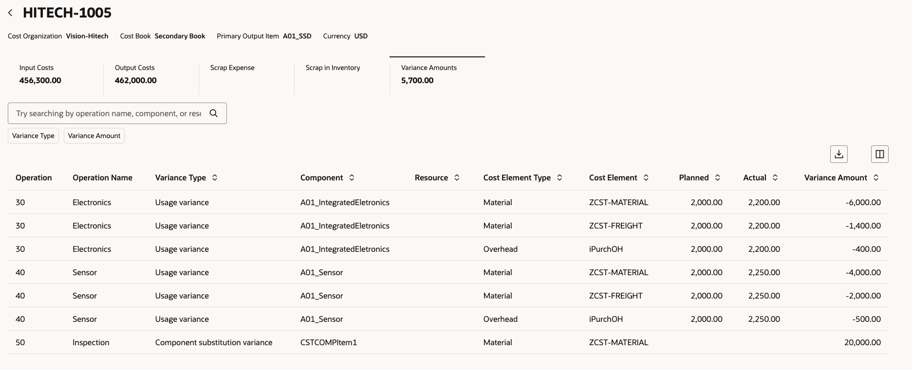

The Variance tab provides more insights on the type of variances, planned versus actual variances, and the variance amounts. You can narrow down the search results by operation name, item, resource, cost element type, and cost elements.
Standard Cost Variances
