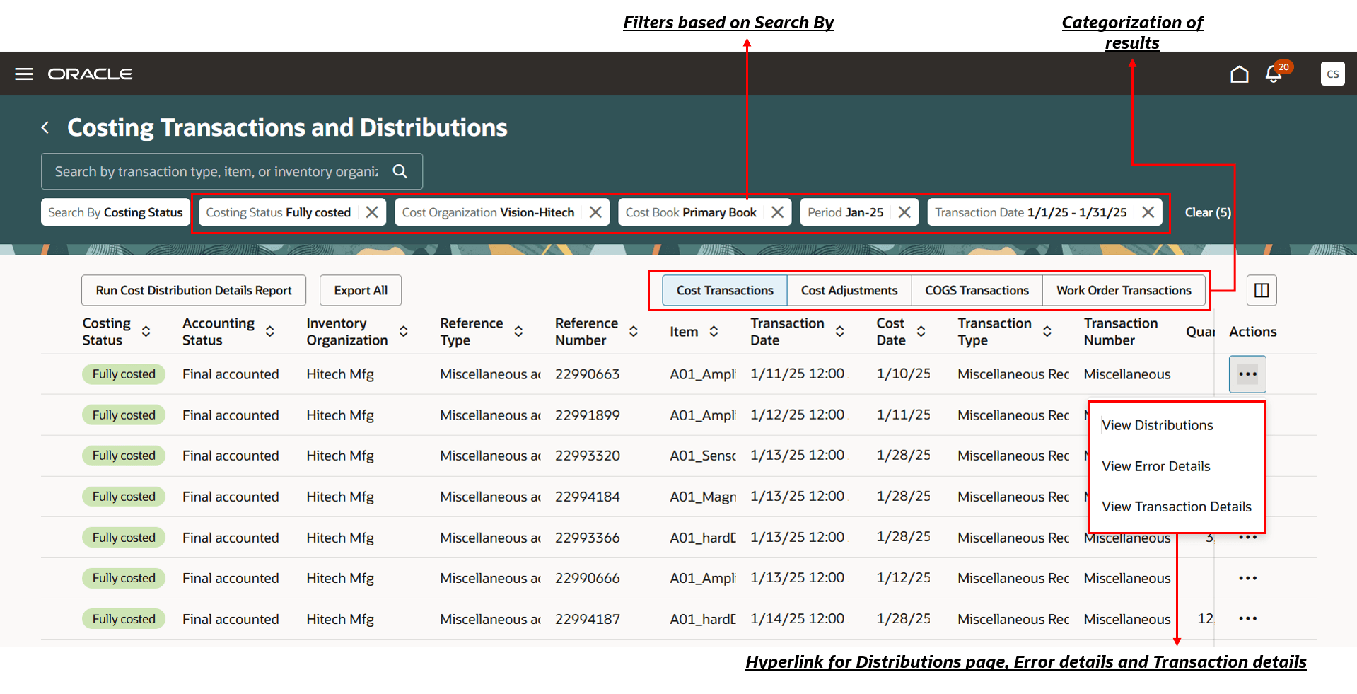

Search by Options and Data Categorization
The page offers versatile search options to locate transactions efficiently. You can search by the following options to review the details of the transactions and distributions:
  • Reference Number: Search based on specific reference numbers, such as purchase orders, transfer orders, sales orders, work orders, or transaction references.
  • Item Number: Find transactions within a specific period for a particular item.
  • Costing Status: Identify transactions based on their costing status. You can use this for spotting transactions that haven't been costed or are in error status.
  • Transaction Type: Filter transactions within a specified date range and by transaction type.
  • Accounting Status: You can use this to locate transactions that aren't accounted for or are in error status to resolve reconciliation issues. Supported statuses include Error, Not Accounted, Draft Accounted, Final Accounted, Multiple, Not Applicable, and Excluded from Accounting.
Each search by option has corresponding mandatory filters. After you set the mandatory filters, the results are categorized under different tabs:
  • Cost Transactions: Includes inventory and intercompany physical and logical transactions.
  • Cost Adjustments: Includes manual or automatic cost adjustments to receipt costs and inventory value.
  • COGS Transactions: Includes cost of goods sold recognition transactions.
  • Work Order Transactions: Includes resource, operation scrap, and work-in-process job close transactions.
From this page, you can run the Cost Distribution Details Report, which offers a list of cost distributions and accounting information alongside basic transaction information in a spreadsheet. This report can be generated for all search options except Accounting Status. You can also review the cost distributions, transaction details or errors for a specific transaction.
Costing Transactions and Distributions page

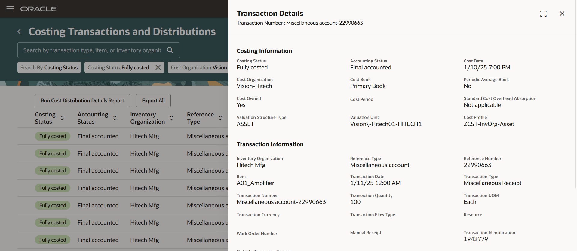

Transaction Details
Transaction details provide you more insights about the transaction parameters and all the essential information for the transaction are at one place. The information is categorized and presented in the Costing Information, Transaction Information, Inventory Control Attributes, and Fiscal Document Details sections.
Transaction Details Drawer

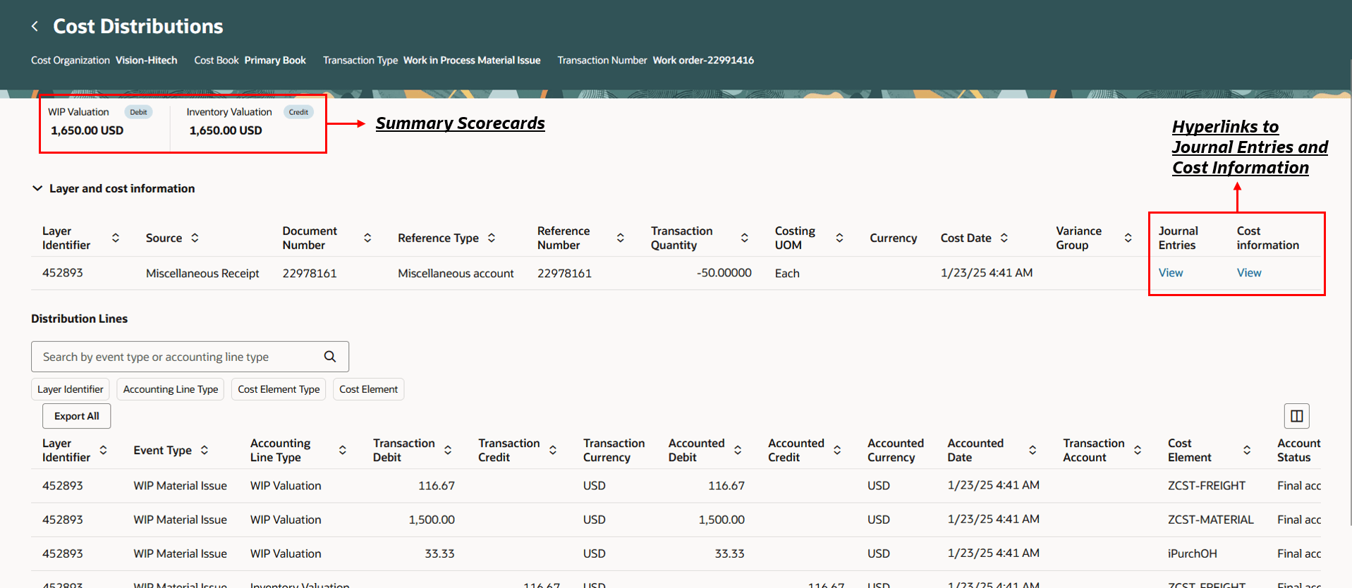

Distributions Page
Cost Distributions page provides you details about the costing and accounting distributions created for a particular transaction. You can find the following information for the transaction on this page.
  • Distributions Summary: You can now view the summary of all the distributions for a particular transaction by accounting line type and accounted amount.  This can help you to quickly identify anomalies, if any. You can also view detailed distributions.
  • Layer Details: This section is collapsed by default. You can expand it to get visibility into receipt layers for receipt transactions and depletion layers for issue transactions. You can view the cost information for the particular layer. You can also directly view journal entries for a particular layer for the transaction.
  • Distribution Details: You can now view details of all the distributions created for the transaction. By default, you will see distributions for all the layers of the transaction, but you can use the filter for layer identifier to filer the distributions for a particular layer. You can also export all the distribution lines into a spreadsheet for offline analysis.
Cost Distributions Page
