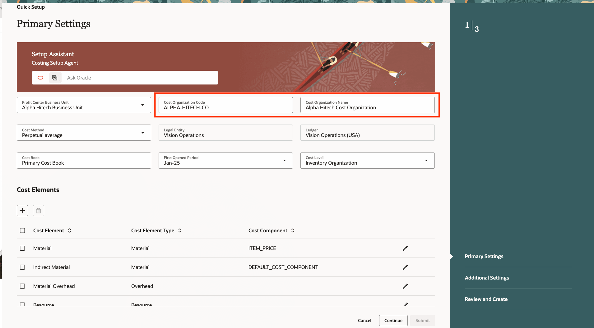

After you choose the profit center business unit, you need to enter a cost organization code and cost organization name as mandatory information.
The following information can be reviewed and modified in the Primary Settings page:
  • The legal entity, primary ledger, and first open period will be defaulted after you choose the Profit Center Business Unit.
  • You can choose the cost method that you would like to use for all items in the cost organization (options are the Standard Cost, Perpetual Average, Periodic Average, and Actual cost methods).
  • Based on the cost method , you can select the appropriate cost levels. For standard and periodic average cost methods, Cost Organization and Cost Organization + Inventory Organization will be available. For perpetual and actual cost methods, an additional option of the Subinventory cost level is available.
  • By default, five cost elements are added to the setup. You can add more cost elements or edit the existing cost elements and also edit the cost components to which they are mapped.
Quick Setup Primary Settings
After you've entered the mandatory information and have reviewed or edited the default values for other fields, you can move to the Additional Settings page.
Specify cost organization name and code

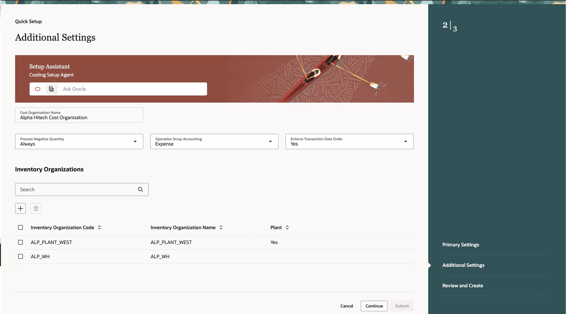

Depending on the cost method chosen, a few additional setup information are shown here with defaults chosen. You can review the information and edit them based on your requirements. All inventory organizations mapped to the profit center business unit and haven't been associated with a cost organization will be shown here. You can remove the ones that you don't want to associate with this cost organization and add the ones that you might have removed erroneously.
Additional Settings
Additional Settings

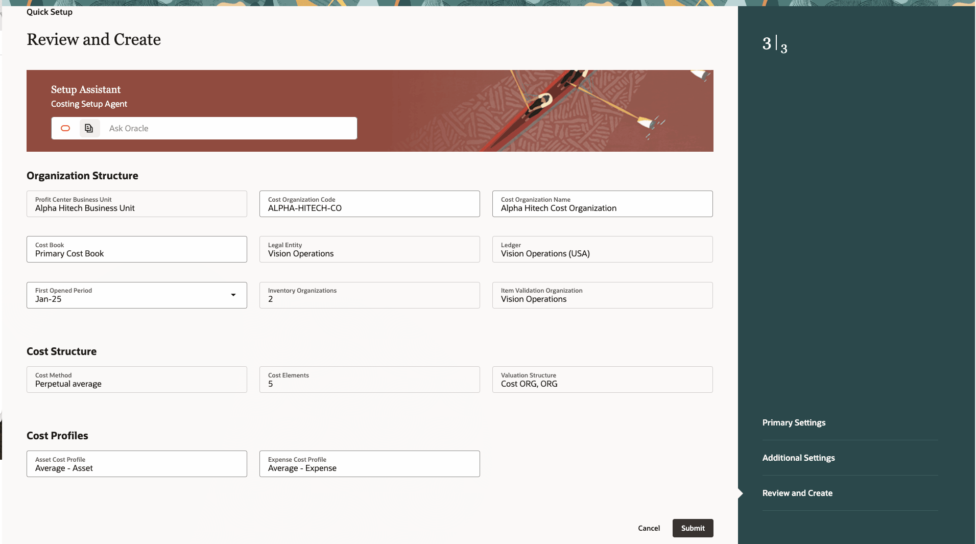

In the next step, you can review the information that has been collected by the quick setup process and edit any of the choices you have made. If you're satisfied with the configuration options, click Submit to create the cost accounting setups.
Review Setups
Review Setups

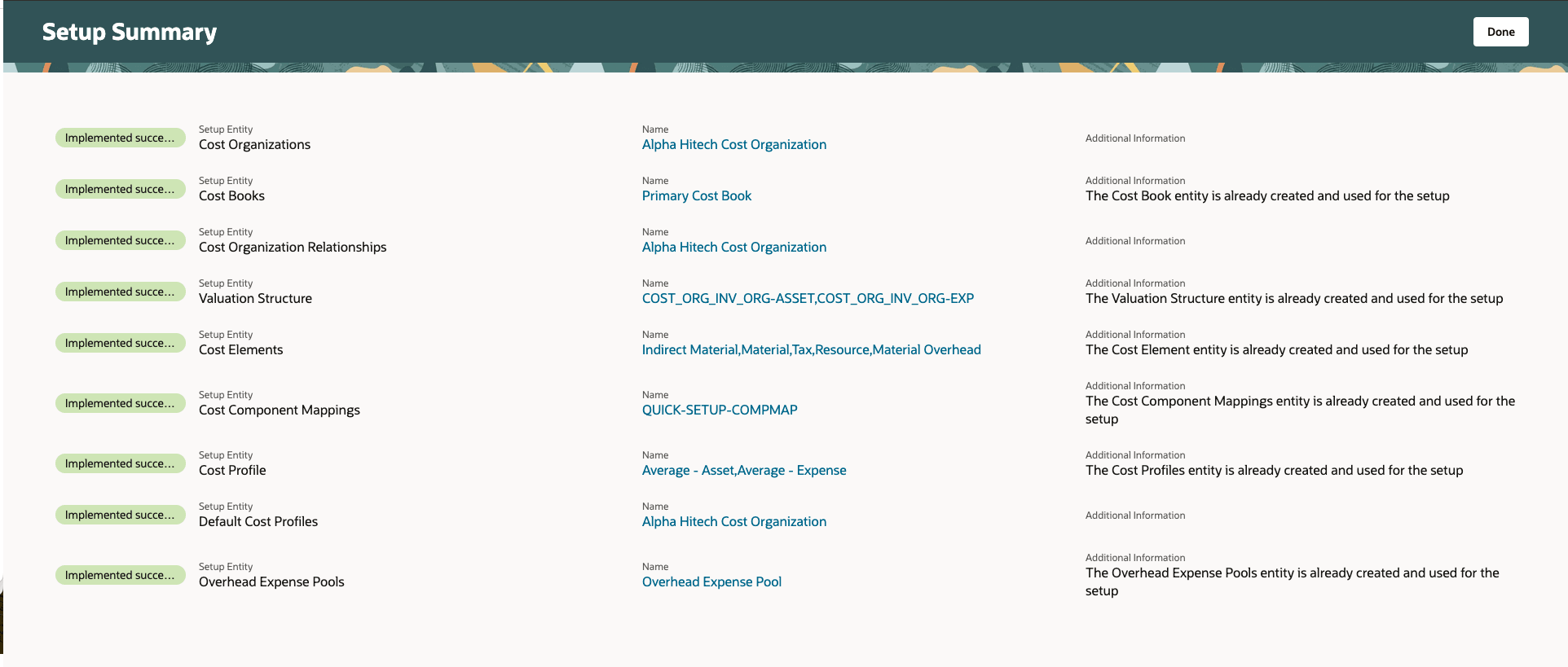

The quick setup will orchestrate all the setups based on the choices you've made and display the entities created. If any of the entities already exist, they're reused as part of the setup. You can navigate to the individual entities to review them and make changes as per your requirements.
Quick Setup Summary
Quick Setup Summary
