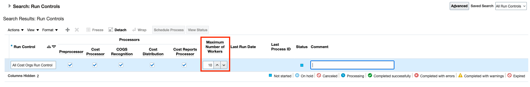

After you opt in to the feature, you can use the Maximum Number of Workers indicating the maximum number of subprocesses that would be used by the Create Cost Accounting Distributions process. If you have not configured this setting before, you can enter a value between 2 and 20 to indicate that you want to use parallel processing. If you use the same run control to run the cost processor stages as well as reports processor, you may set up the maximum number of workers on that same run control. If you use a separate run control for reports processor, you can set up the same value or a different value for the maximum workers setting that is appropriate for your needs. See below for additional considerations.
Select maximum number of workers

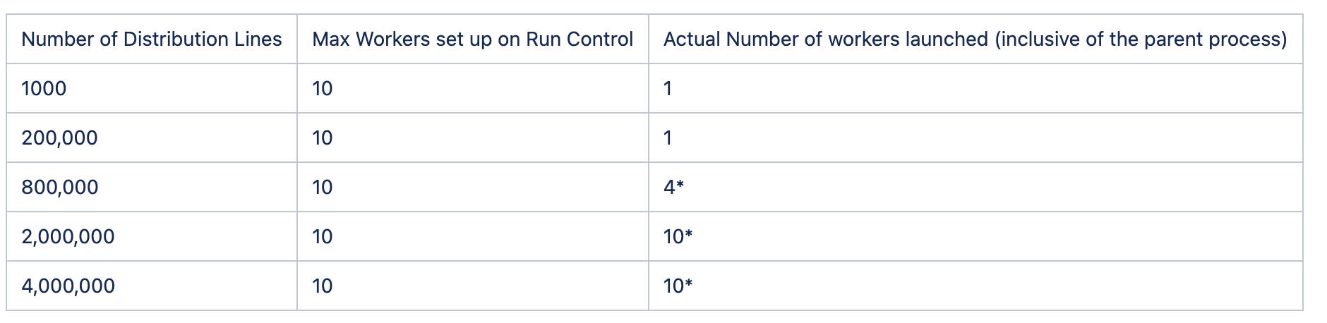

To ensure that the Create Cost Accounting Distributions process does not consume a lot of resources that will otherwise be required for other processing elsewhere in the system, some restrictions are placed on the number of workers that will be launched by the system. Regardless of the value for maximum workers set in the run control parameter, during runtime, the system dynamically reduces the number of concurrent workers that are run based on the data volume being processed to ensure that the processing times are optimized. Currently, the threshold is set to 100,000 transactions or distribution lines and a maximum of 20 workers.
The table below shows how the system decides on the number of workers dynamically during processing in Reports Processor.
Dynamic selection of workers during processing
* - Actual subprocesses may vary slightly from the number indicated based on actual volume and mix of transactions processed.
