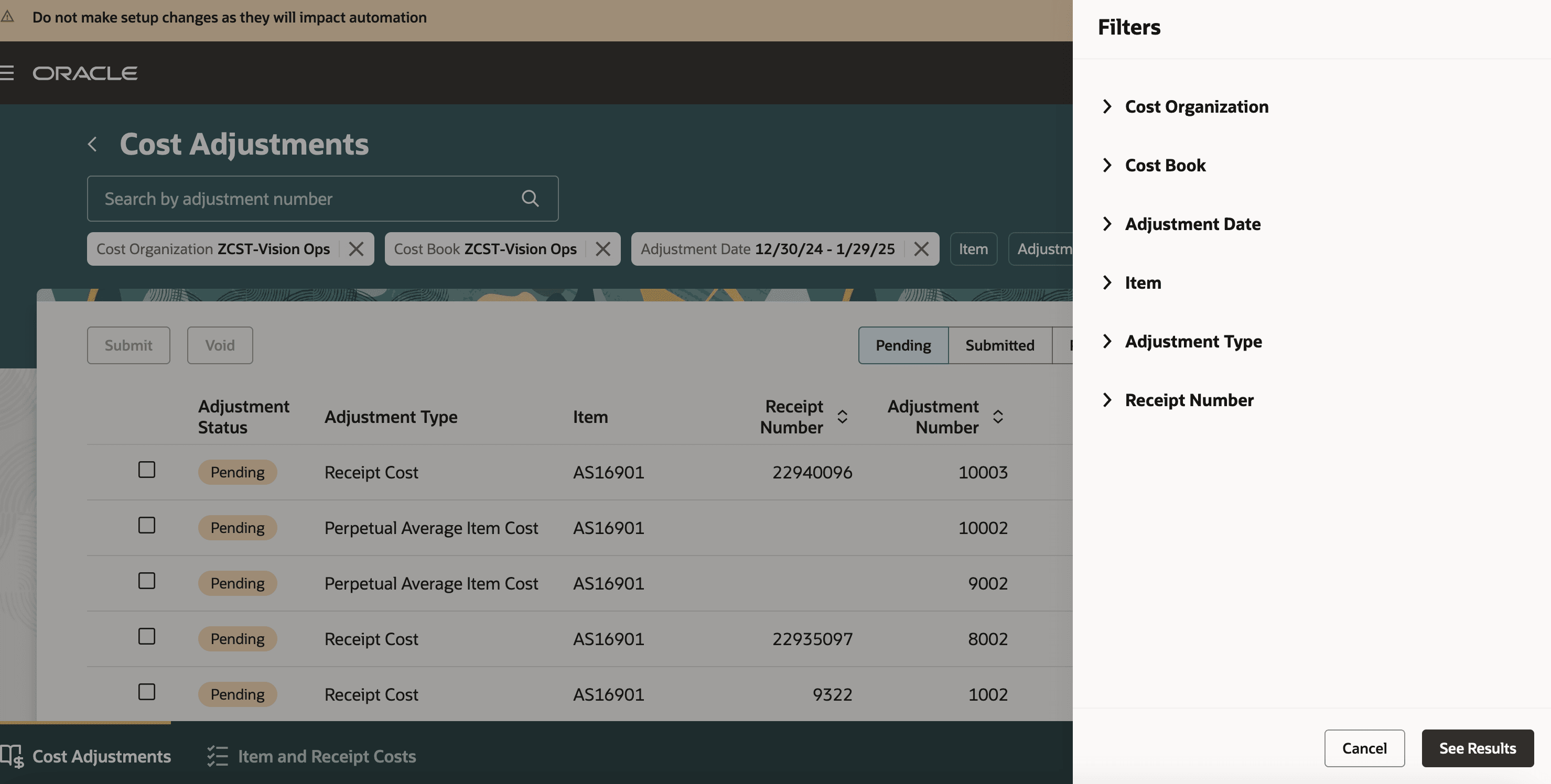

Additional filters are available for you to retrieve data based on your needs.
Filters for cost adjustments tab

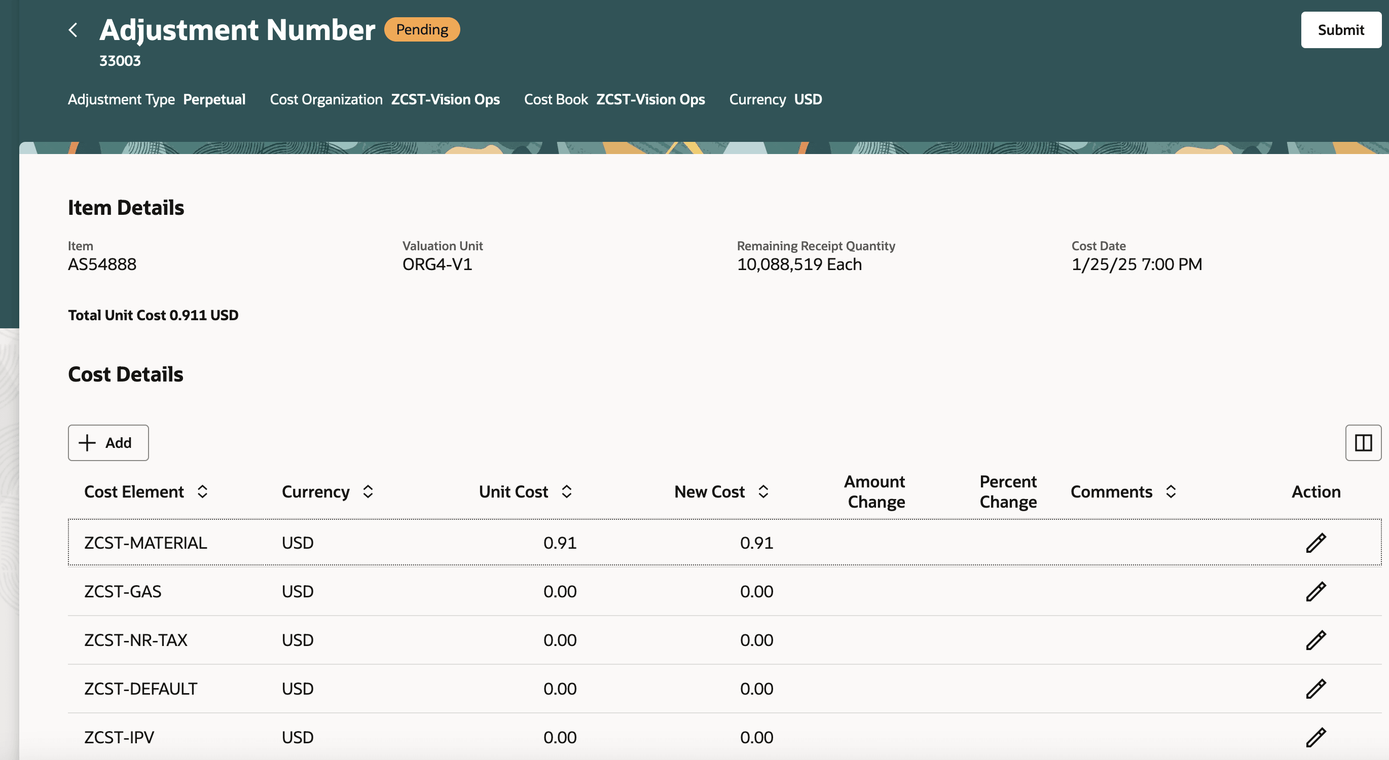

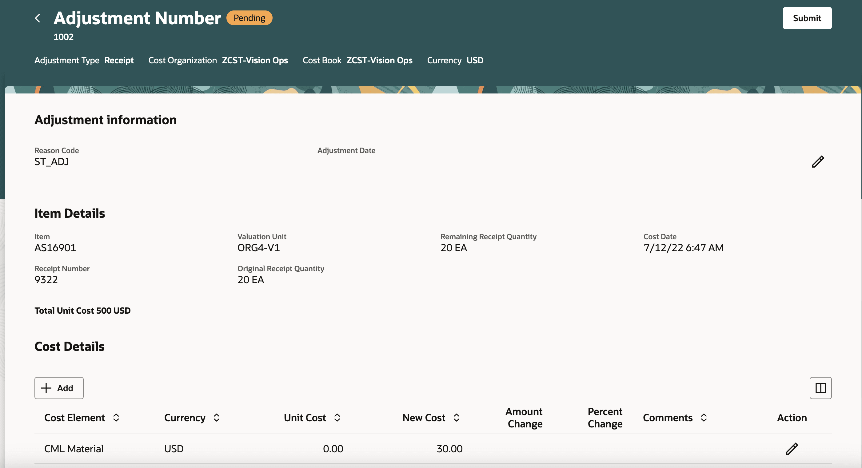

For a pending cost adjustment, you can edit the cost adjustment before submitting it.
Pending cost adjustment that can be edited and submitted

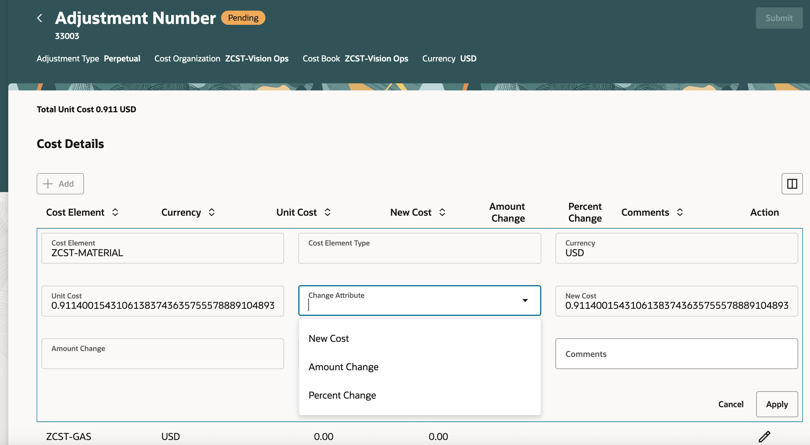

While editing a pending cost adjustment detail, you can choose to enter:
  • New Cost
  • Amount Change
  • Percent Change
Edit cost adjustment detail by entering new cost, amount change or percent change

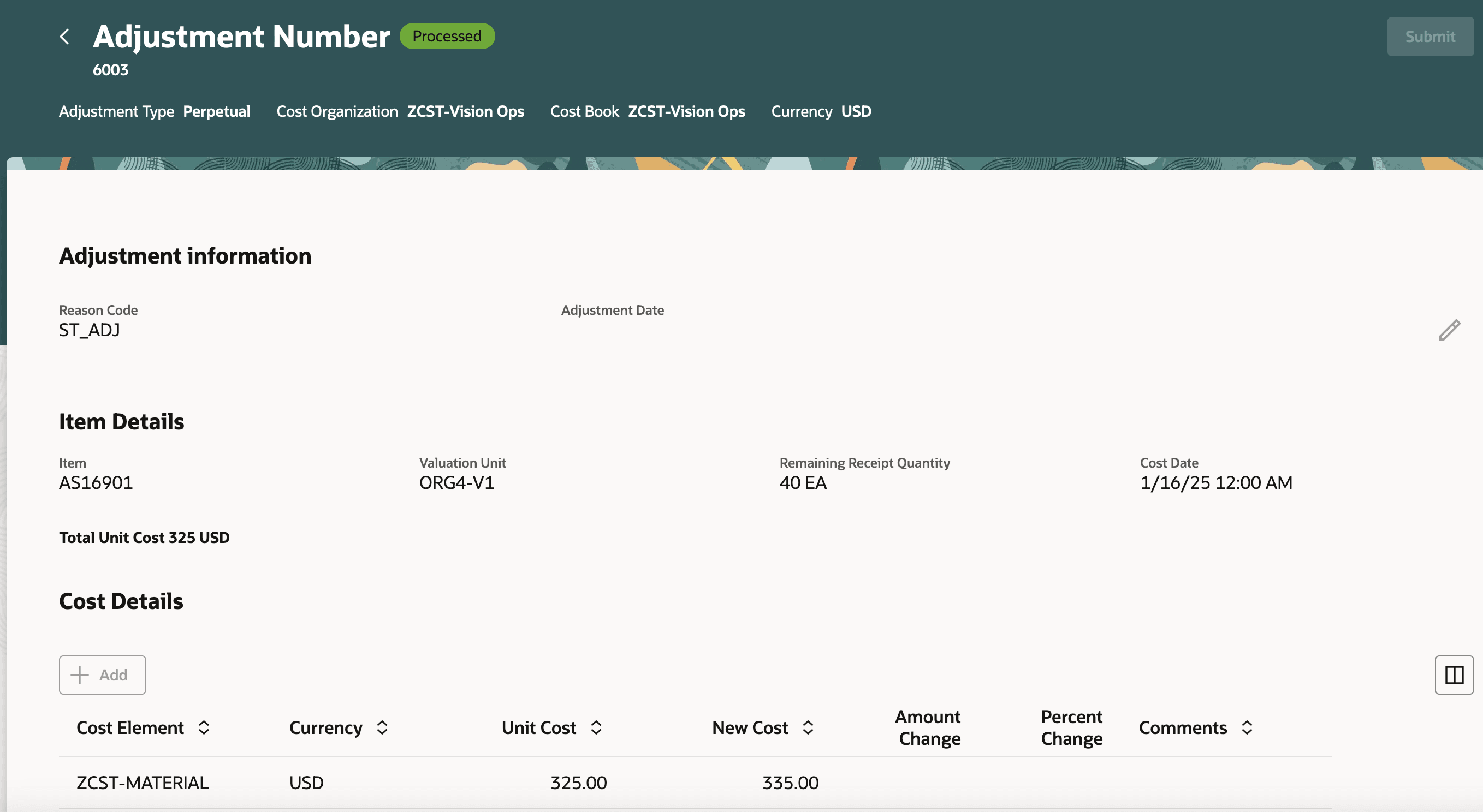

You can only edit and submit adjustments that are in the Pending status.
Processed adjustment can't be edited

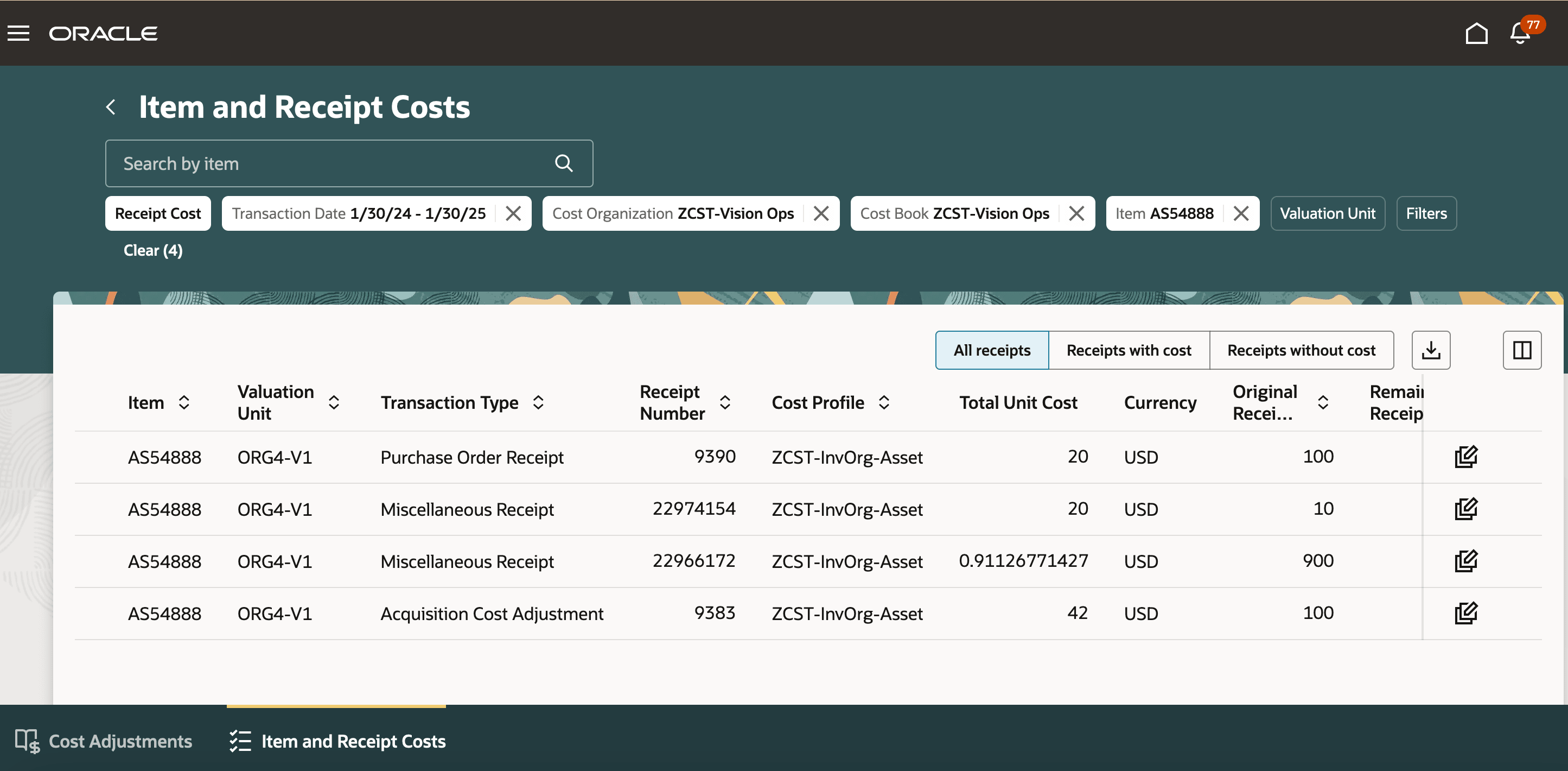

Item and Receipt Costs

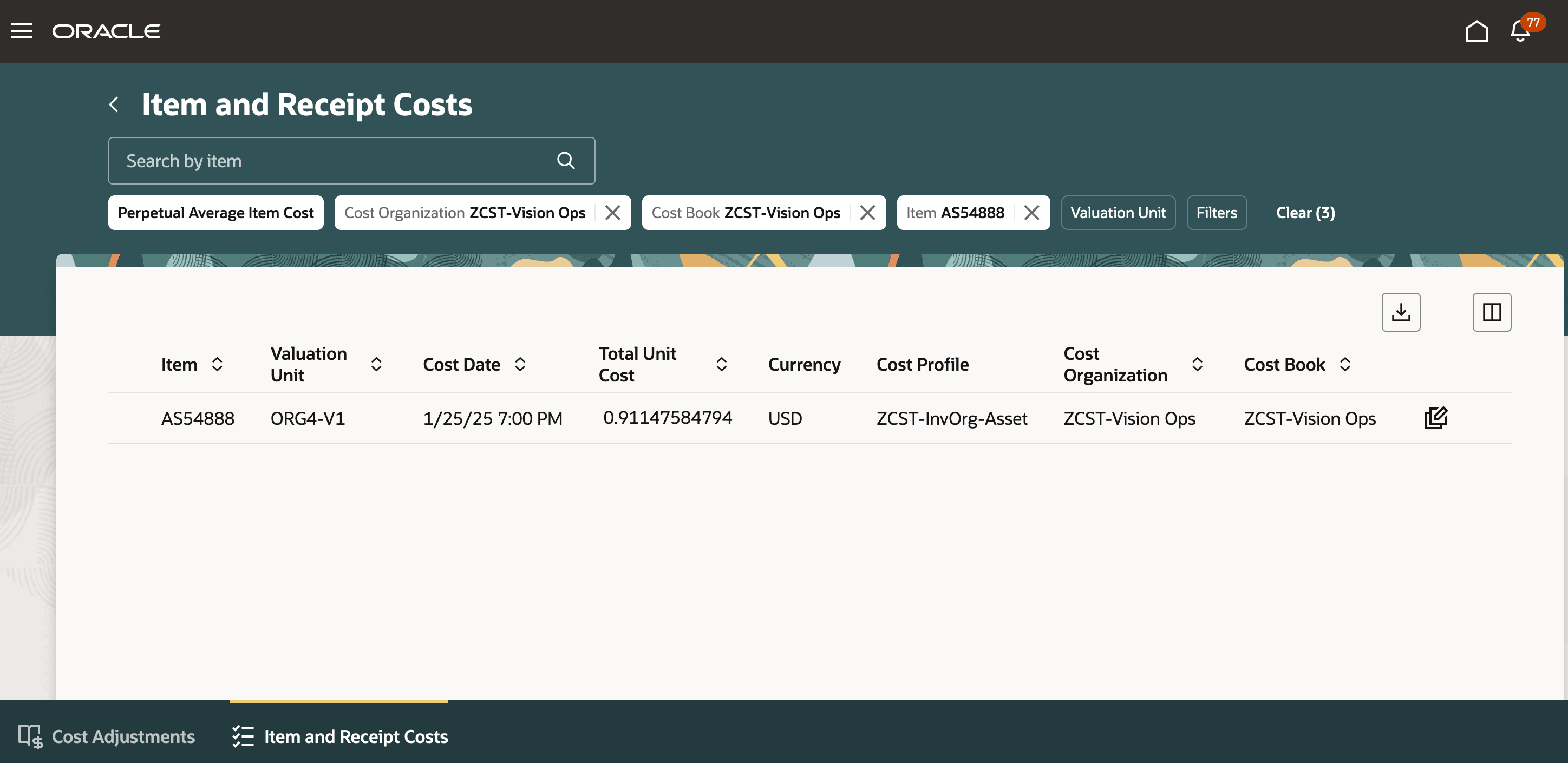

This tab is your starting point to choose costs that you intend to adjust. To ensure fast data retrieval, you need to enter cost type, cost organization, cost book, and item.
Item and Receipt Costs tab displaying the perpetual average cost eligible for adjustment
Receipt costs data include receipts with and without costs by default and transaction date range search criteria

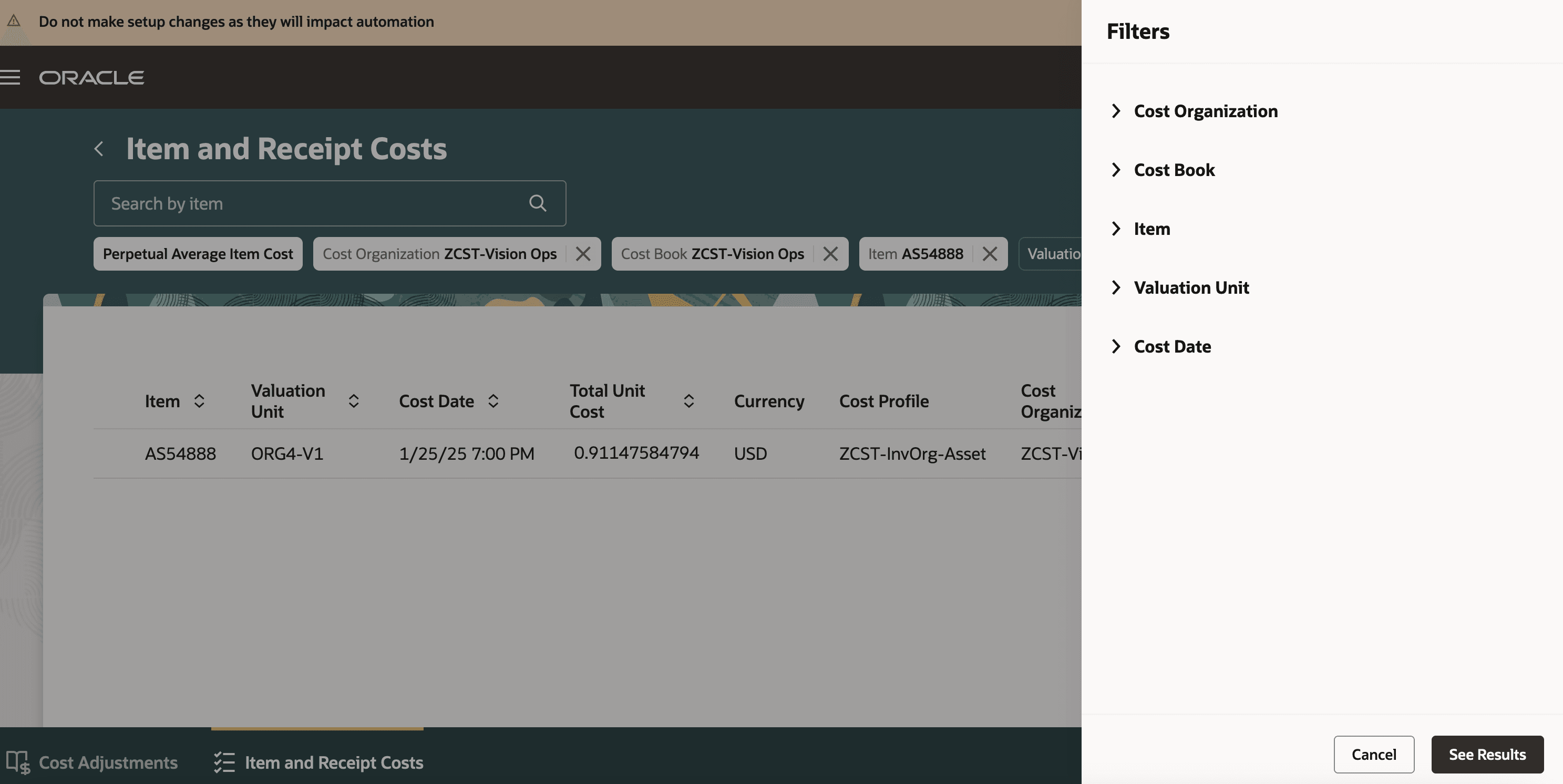

Additional filters are available for you to filter the costs based on your needs.
Filters for item and receipt costs tab

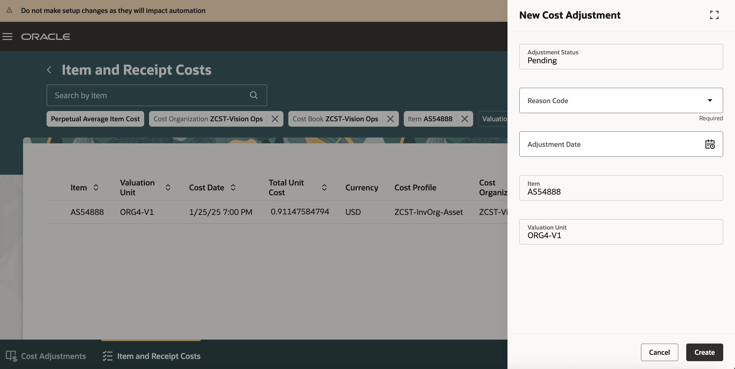

After you select the cost, you can create a new cost adjustment using the Adjust button.
Panel drawer to create a new cost adjustment
You can enter all the adjustment details and submit the cost adjustment to be processed by Cost Accounting or you can save the cost adjustment for further review.
Adjustment details
Adjustment details
