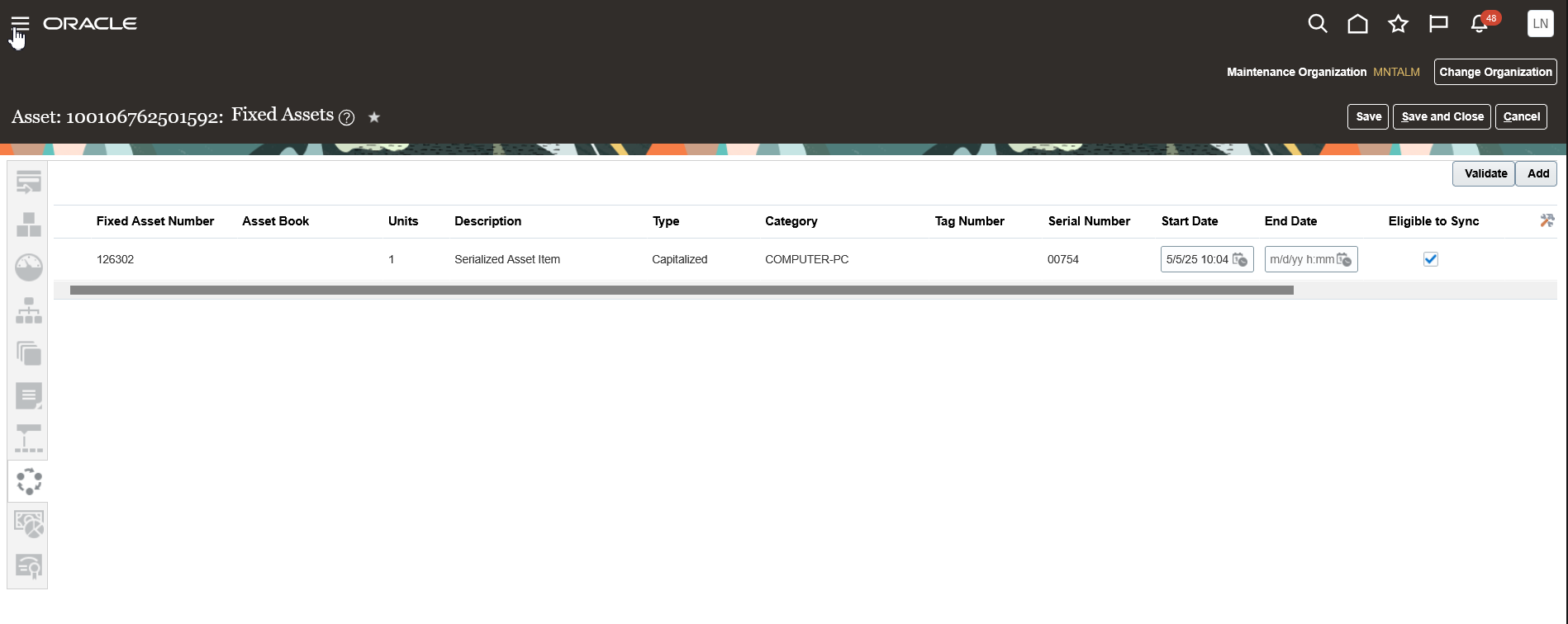

Here's a screenshot of the Fixed Asset Tab that shows a fixed asset associated to an installed base asset with the Eligible to Sync check box selected.
Fixed Asset Tab with a Fixed Asset that's Eligible for Sync
