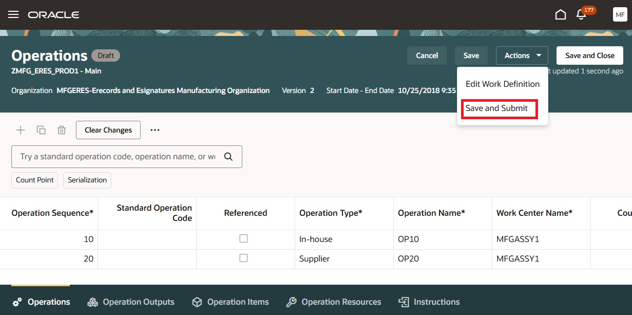

The following screenshot shows the submission of the work definition:
Submit Work Definition for Electronic Signature Approval

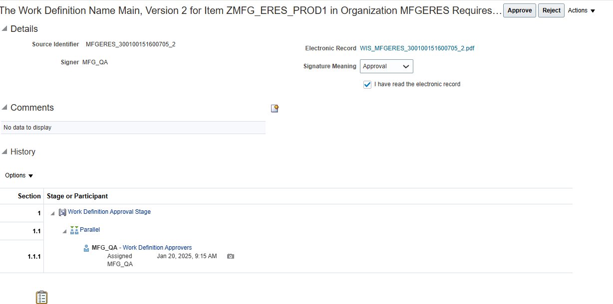

Review and approve the electronic record in the deferred approval window, as shown below:
Deferred Electronic Signature Approval Window
Work definition approval using electronic records and electronic signatures enforces final signoff, ensuring a proper stage gate before release to work execution, planning, and cost planning.

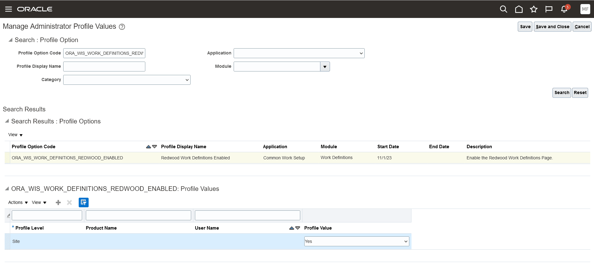

- Set up the Profile to enable the Redwood experience for work definitions, as follows:
- In the Setup and Maintenance work area, search for and select the Manage Administrator Profile Values task.
- On the Manage Administrator Profile Values page, search for and select the ORA_WIS_WORK_DEFINITIONS_REDWOOD_ENABLED profile option code.
- In the Profile Values section, set the Site level to Y or N. The default value of the profile option is N.
- Y = enables the feature
- N = disables the feature
- Click Save and Close. Changes in the profile value will affect users the next time they sign in.
Profile Option for Accessing Work Definition Using the Redwood User Experience
