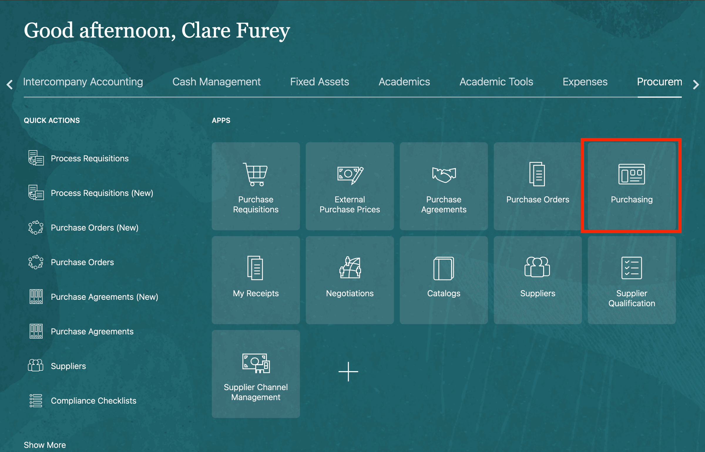

When you log into the application, you'll see an icon to launch the landing page:
New Tile to Access Purchasing Landing Page

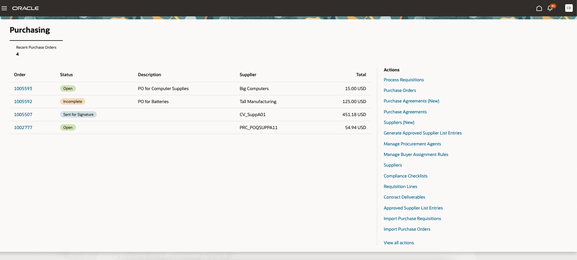

On the landing page, you'll see a list of your most recent purchase orders, up to 25. Purchase orders are added to this list when you view them or perform specific actions, such as opening the PDF or duplicating an order.
Landing Page
Landing Page

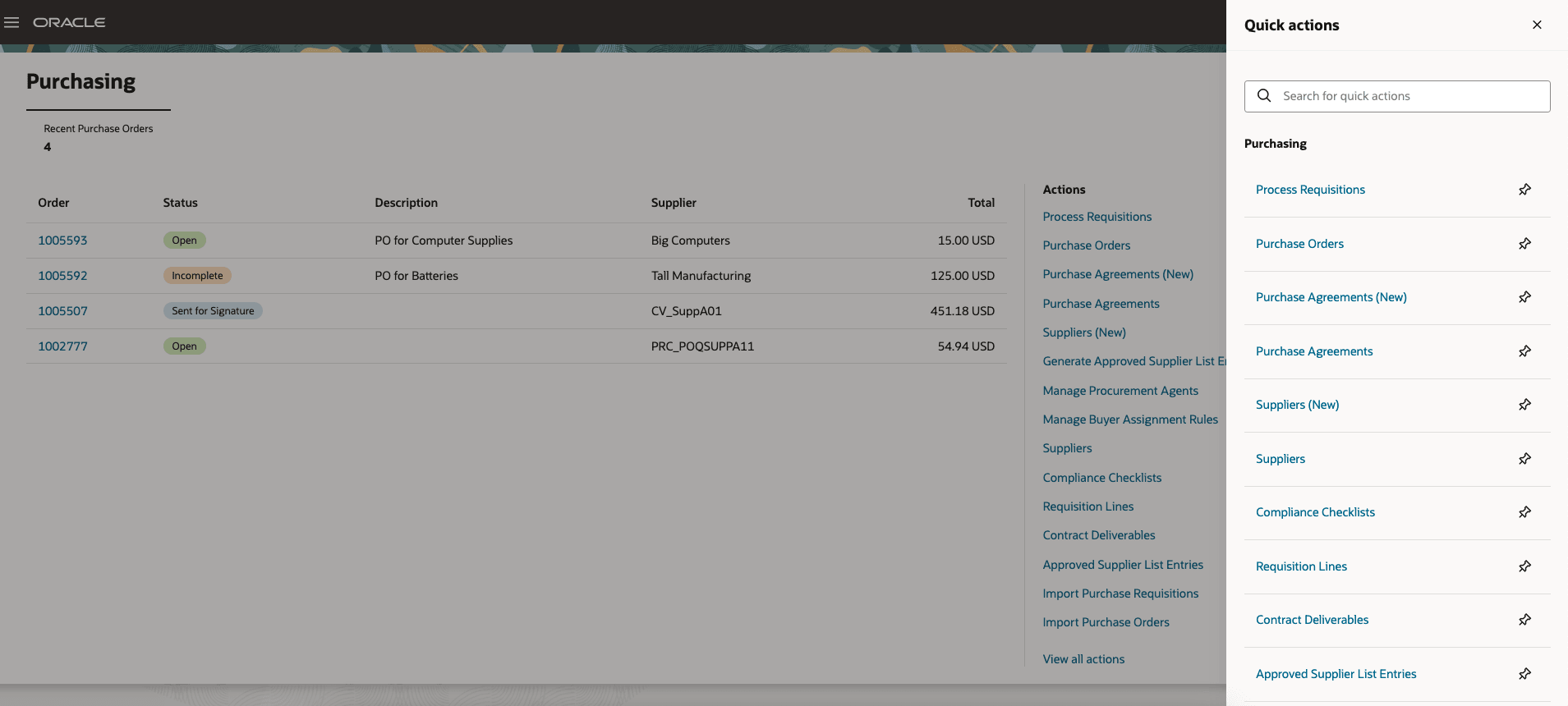

You will also see a list of quick actions or links to tasks you may need to access as part of your job. Selecting the View all actions link will allow you to pin your favorite links to this panel.
Pin Quick Actions
Pin Quick Actions

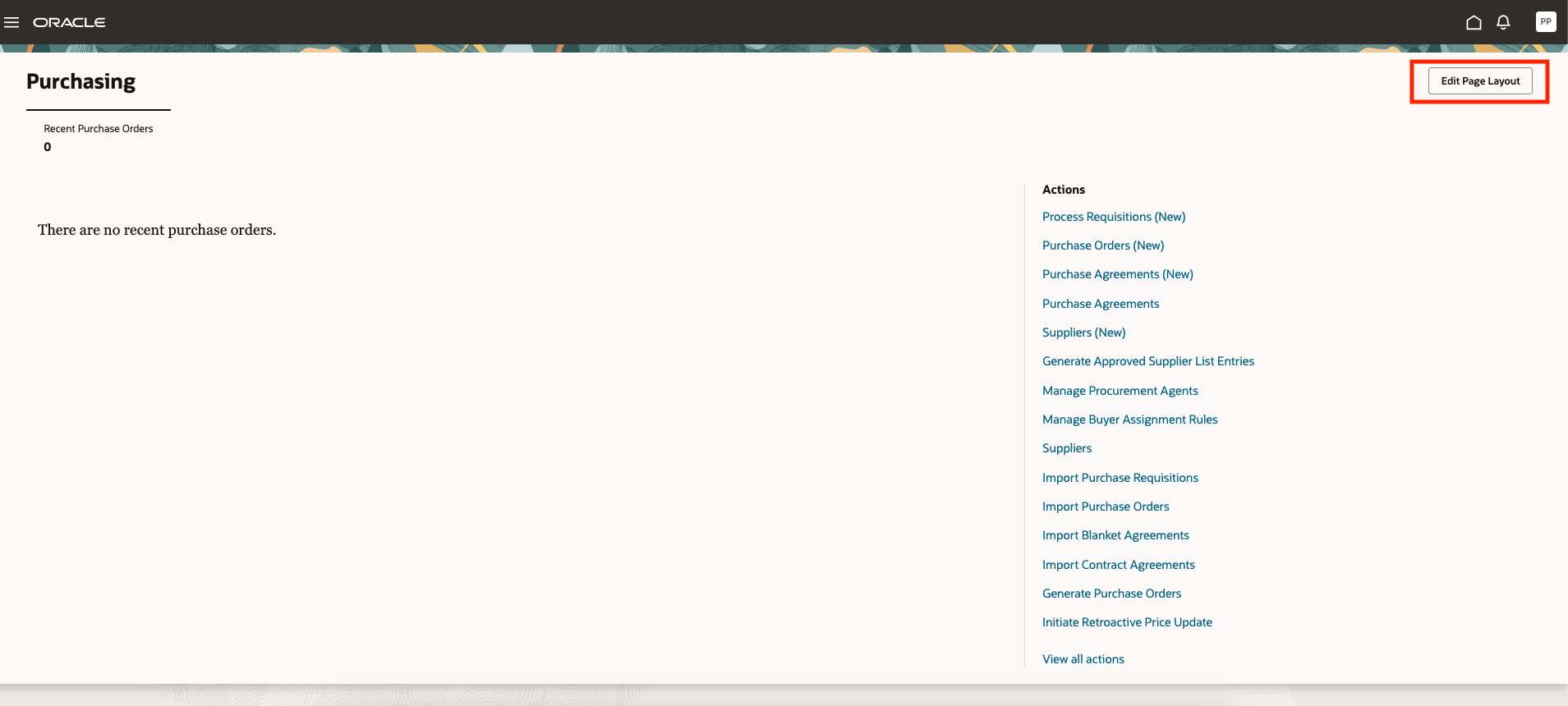

If you're an administrator, you can create your own scorecards by adding KPIs and data visualizations that best represent your business and are critical for your buyers to see. You can do this using the Edit Page Layout button on the landing page.
Edit Page Layout
Edit Page Layout

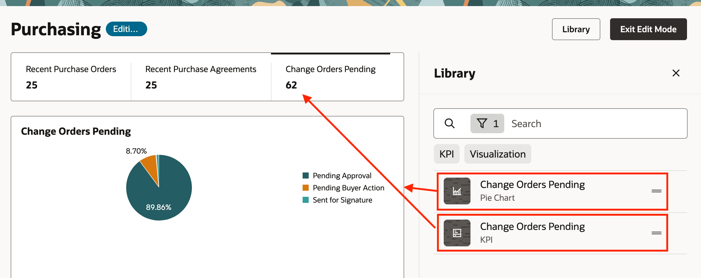

From the Edit Page Layout page, drag the KPI content to the scoreboard region. Drag the corresponding visualization to the area below the scoreboard.
Add OTBI-based KPIs and Visualization to Landing Page
Add OTBI-Based KPIs and Visualization to the Landing Page

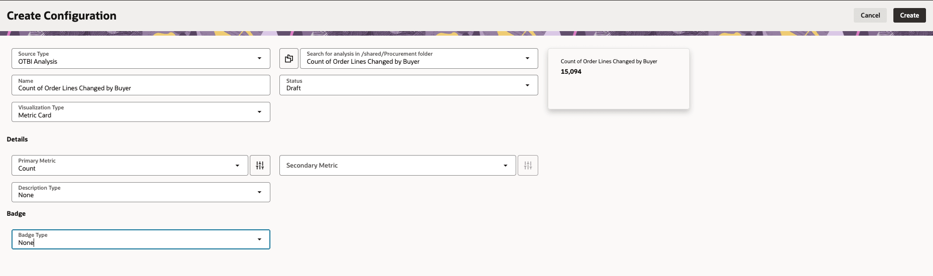

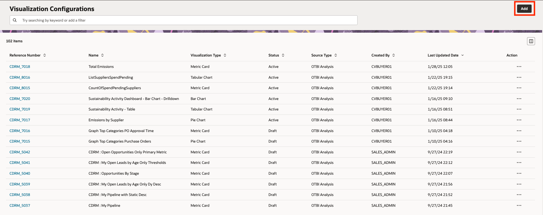

NOTE: In order for these KPIs and visualizations to appear as eligible options on the landing page, you must first add them to the Visualization Configurations page. This page can be accessed using this URL: https://<servername>/fscmUI/redwood/cx-analytics/application/container/dvconfig
Visualization Configurations Page
From this page, you will need to Add your OTBI KPIs and Data Visualizations:
Add OTBI KPIs and Data Visualizations
