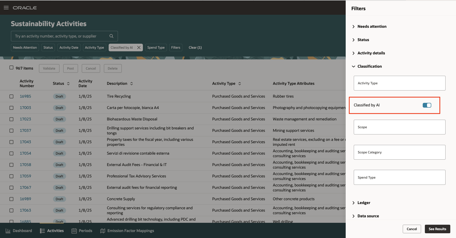

Reviewing Activities Classified by AI
Oracle recommends that you review activities automatically classified by AI to ensure that they have been created correctly. Make necessary corrections before posting them to the ledger. Over time, the model learns from the corrected activities and can predict more accurately in the future.
To facilitate reviewing these activities, you can apply a filter to see all activities that were classified by AI.
Sustainability Activities Page Showing Activities Classified By AI and the Classified by AI Filter

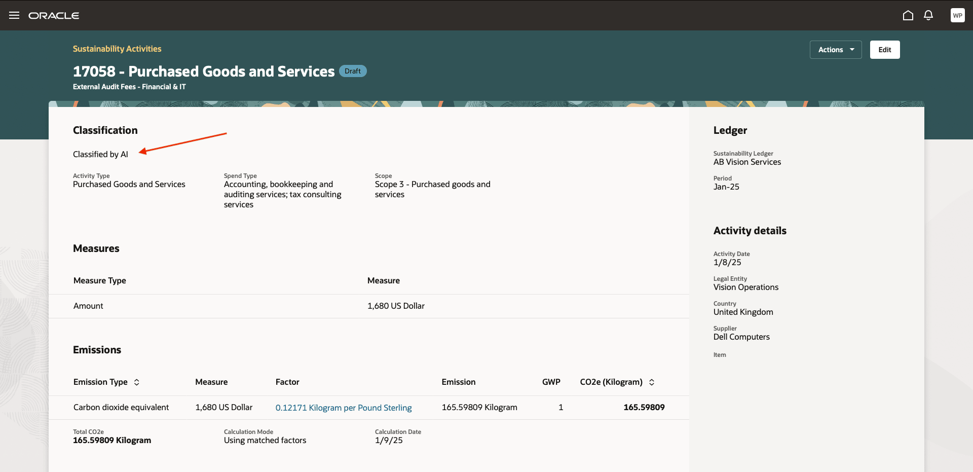

When you view or edit an activity, you can also see that the activity was classified by AI.
View Activity Page Showing That the Activity was Classified By AI
If the activity was incorrectly classified, then you must do one of the following before proceeding to post the activity to the ledger:
  • If the activity type is correct, but the activity type attributes are incorrect, then edit the activity and make corrections.
  • If the activity type is incorrect, then create a rule to cover invoice distributions like this one and delete the activity. In the next run of the scheduled process, a new activity will be generated in its place.

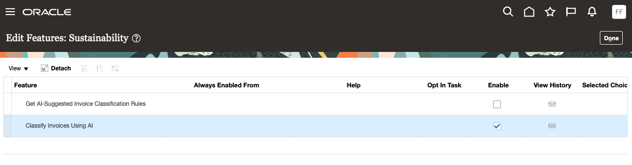

Steps to enable and configure
Use the Opt In UI to enable this feature. For instructions, refer to the Optional Uptake of New Features section of this document.
Offering: Procurement
The Sustainability functional area is shared under the Procurement, Product Management, and Manufacturing and Supply Chain Materials Management offerings.
To opt-in to this feature:
  1. Go to the Opt In page for your offering and find the row for Sustainability.
  2. Click the corresponding Edit icon under the Features column.
  3. On the Edit Features page for Sustainability, in the Features column, look for Classify Invoices Using AI, and then select the corresponding checkbox in the Enable column.
  4. Click Done.
The next time the Generate Sustainability Activities from Payables Invoices scheduled process runs, any invoice distributions that couldn't be classified using rules will be considered for classification by AI.
Edit Features Page for Sustainability
