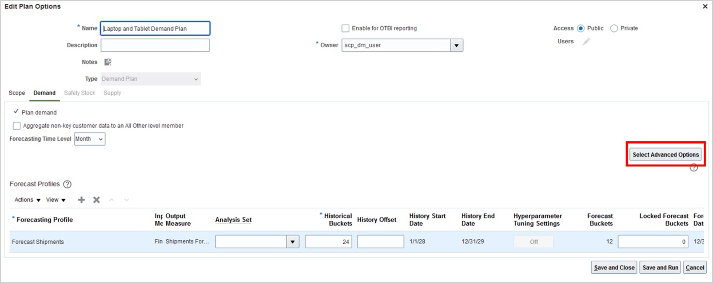

To enable this feature for a demand plan, edit the plan options and click Select Advanced Options on the Demand tab to open the Demand: Advanced Options dialog box.

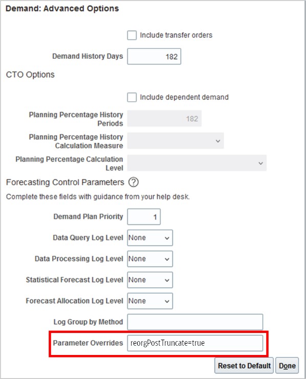

In the Demand: Advanced Options dialog box,
  1. Enter the text reorgPostTruncate=true in the Parameters Overrides field. Make sure to enter the text with the same capitalization and spaces. If there are other entries in the Parameters Overrides field, enter this value at the end, using a # to separate it from the existing values. For example: REFRESH=TRUE#reorgPostTruncate=true.

  1. Click Done to close the Demand: Advanced Options dialog box. You must save the plan to save this setting.
  2. Click  Save and Close or click Save and Run on the Edit Plan Options page to save the plan and setting.

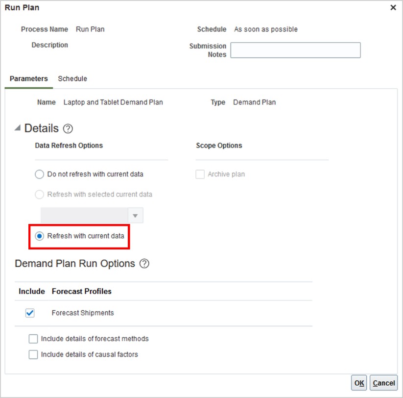

  3. To apply the settings, select the Refresh with current data checkbox on the Run Plan page and click OK.
