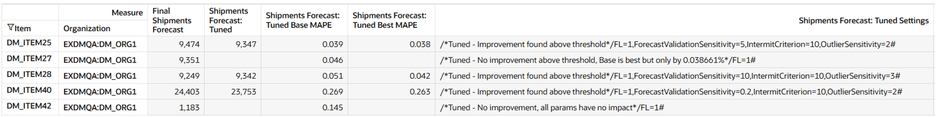

The Tuned Settings measures now also indicate the level in the forecast tree that the tuning was performed at. This information is shown in the FL=n# format where FL is the initialism for forecast level, and n is the level in the forecast tree.
Example of Information in Shipments Forecast: Tuned Settings Measure
