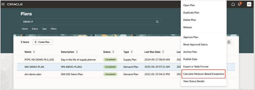

  1. In the Redwood work area named Supply Chain Planning, click More Actions > Plans.
The Plans page opens on a new web browser tab and displays a list of plans that you own or have permission to access. Multiple plan actions are available for each plan based on the plan type.
  1. For the plan for which you want to submit the scheduled process, in the Action column, click the More Actions icon (ellipses), and select Calculate Measure-Based Exceptions.
A confirmation message is displayed.
More Actions Icon for Plan on Plans Page
Menu Item for Calculating Measure-Based Exceptions

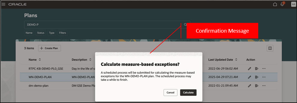

Confirmation Message for Calculating Measure-Based Exceptions
  1. Click Calculate.
The scheduled process named Calculate Measure Based Exception is submitted, and a confirmation message with the process ID is displayed.

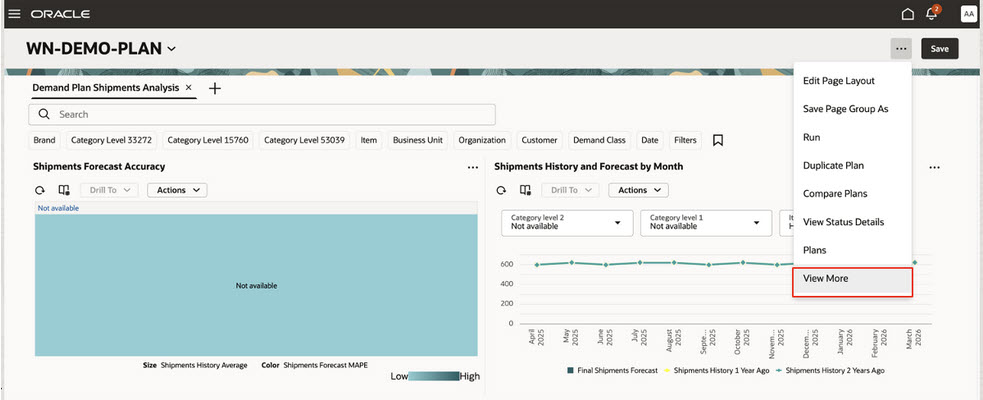

Follow these steps to submit the scheduled process from an open plan:
  1. In your plan, click More Actions > View More.
The Actions drawer will open.
More Actions Menu for Plan

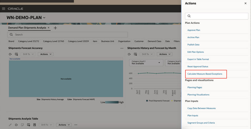

Actions Drawer
Actions Drawer
  1. In Plan Actions, click Calculate Measure-Based Exceptions.
A confirmation message will be displayed.
