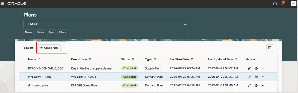

  1. In the Supply Chain Planning work area, navigate to More Actions > Plans.
The Plans page opens in a new web browser tab and displays a list of plans that you own or have permission to access. Multiple plan actions are available for each plan based on the plan type.
Options on Plans Page

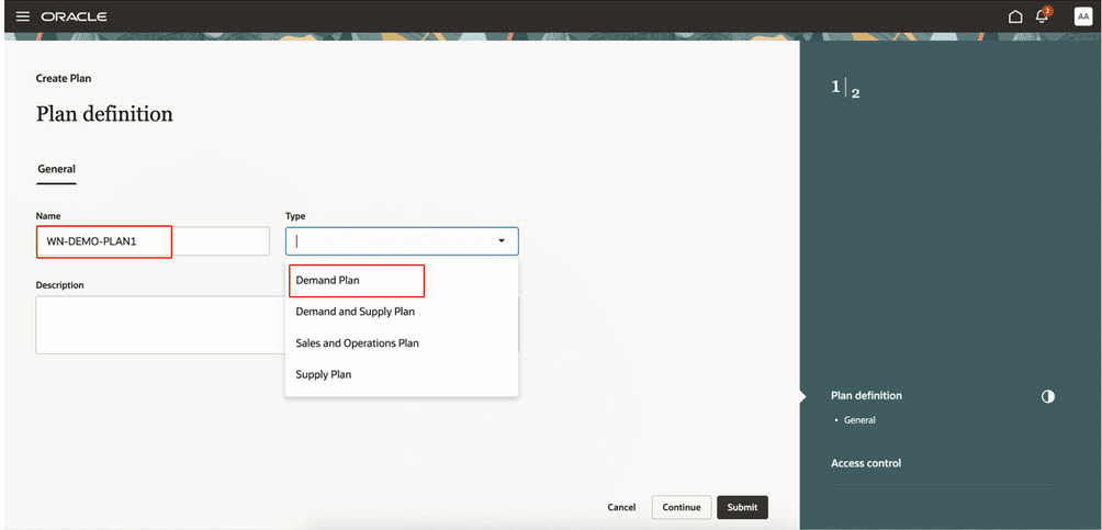

  1. Click Create Plan.
A guided process opens in a new browser tab, displaying Name, Type, and Description.

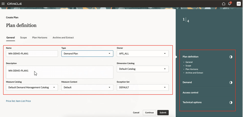

  1. Enter Name and Description and select Type as Demand Plan.
Create Plan Guided Process
The expanded guided process displays default plan options applicable to a demand plan. The process consists of four steps:

  1. On the General tab, specify the Dimension Catalog, Measure Catalog, Exception Set, and Measure Context as needed.
General tab settings

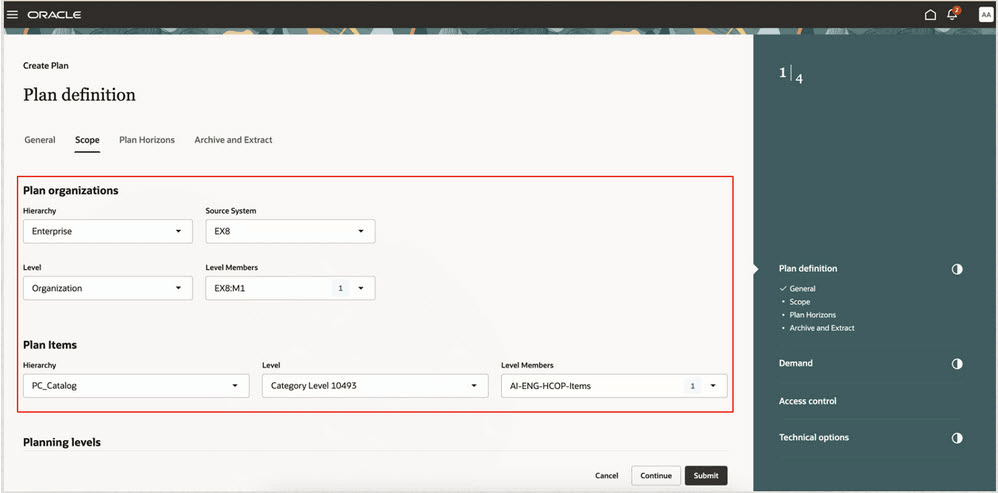

  1. On the Scope tab, select Source System, Organization dimension Level, and Level Members for plan organizations. Then, select Hierarchy, Product dimension Level, and Level Members for plan items, if needed.
Scope tab selections
Click the Plan Horizons tab to continue.

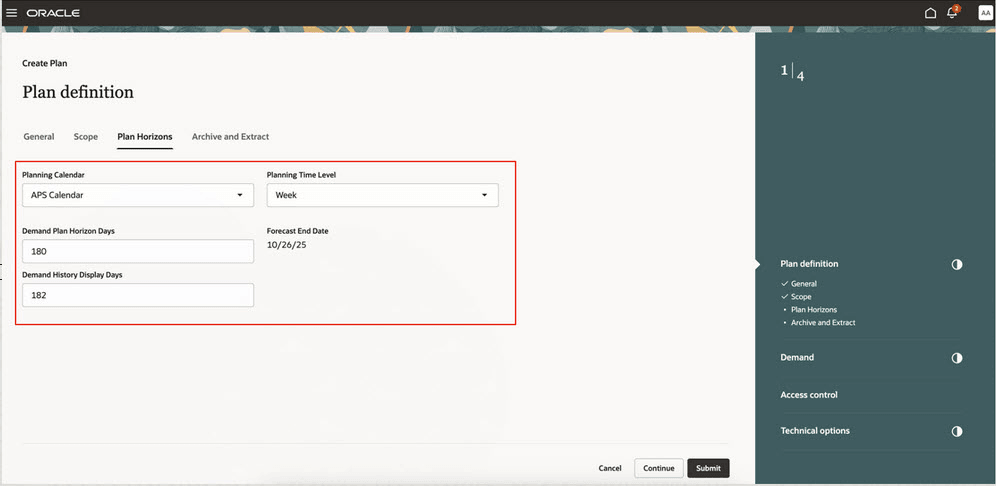

  1. On the Plan Horizons tab, select Planning Calendar and Planning Time Level, then specify Demand Plan Horizon Days. Use Demand History Display Days to define the time horizon for displaying historical measure data.
Horizons tab selections

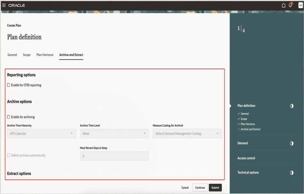

  1. On the Archive and Extract tab, select the Archive Options and Extract Options. For example, enable archiving for the plan and modify the measure catalog for archiving.

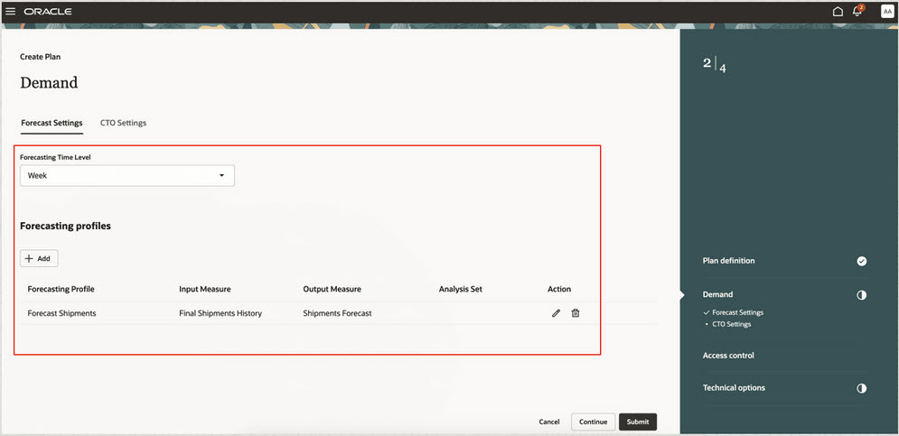

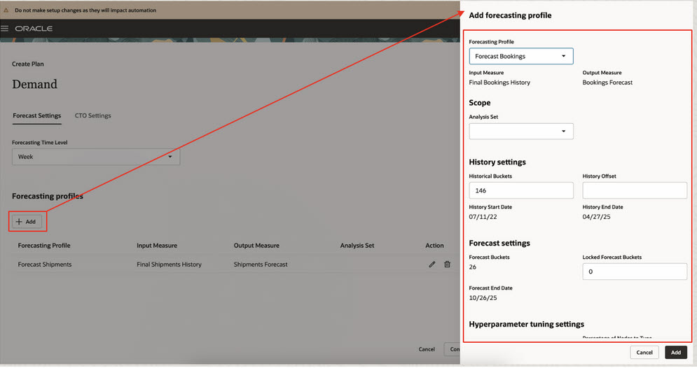

  1. In the Demand step, you can select Forecasting Time Level for forecasting and add, remove, or edit forecasting profiles in the demand plan.
Click Add to add a forecasting profile to the plan.
Adding forecasting profile to the plan

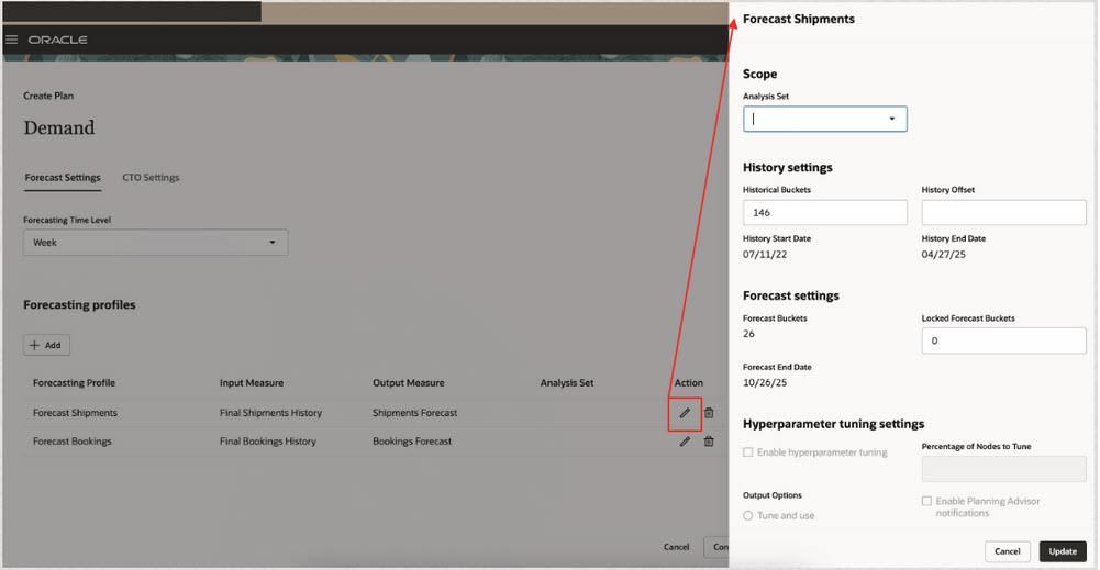

  1. To edit a forecasting profile in a demand plan, click the Edit icon next to the forecasting profile. The profile details open in edit mode. Review and update the settings as needed, then click Update to save your changes.
Editing a forecasting profile in a demand plan
  1. To remove a forecasting profile from a demand plan, click the Delete icon next to the forecasting profile.

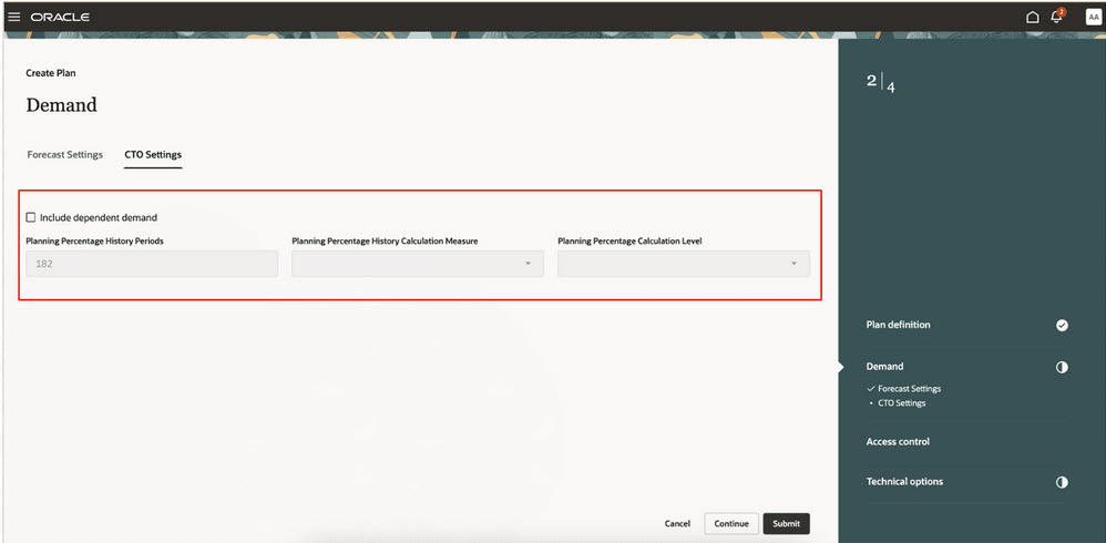

    Click the CTO Settings tab to continue.
  2. On the CTO Settings tab, update the details to create a Configure to Order type demand plan.
CTO Settings tab

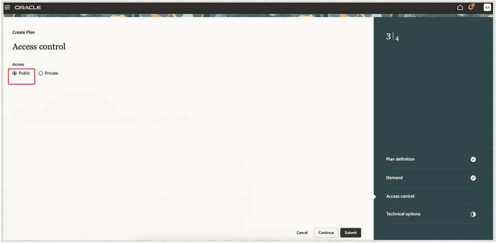

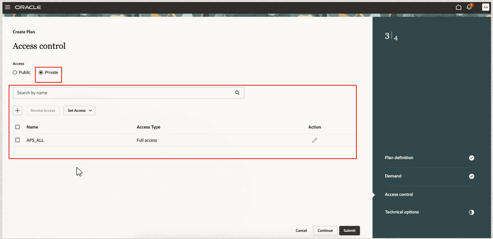

  1. In the Access control step, you can manage user access to the plan. By default, access is set to Public. To restrict access, you can configure the plan as Private and grant access only to specific users, either with limited or full access, using the set access type selection options. The plan will then be accessible only to the selected users.
Access control set to public
Access control set to private

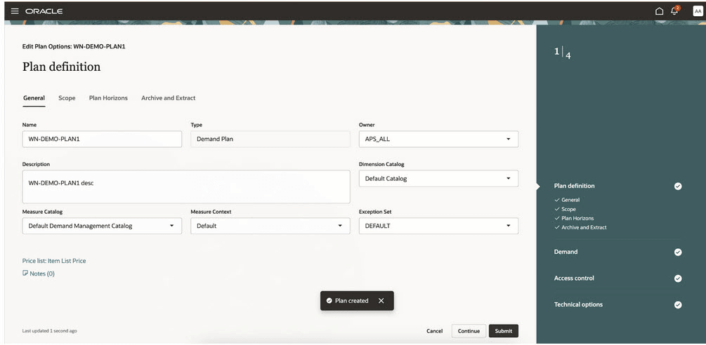

A message is displayed upon successful plan creation. Close the browser tab after creating the plan.
The page is refreshed to display the Edit icon for the newly created plan.
Refreshed page to display edit icon for newly created plan
  1. To edit the plan, click the right step or tab, then click Submit to save your changes.

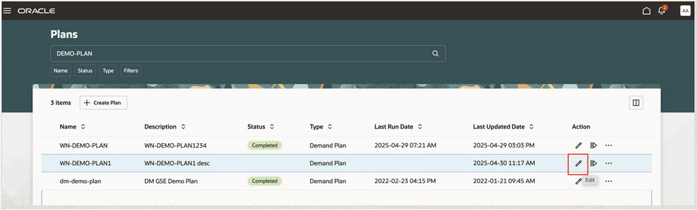

  1. In the Supply Chain Planning work area, navigate to More Actions > Plans. The Plans page opens in a new web browser tab and displays list of plans you own or have access to. Available actions depend on the plan type.
Plans page

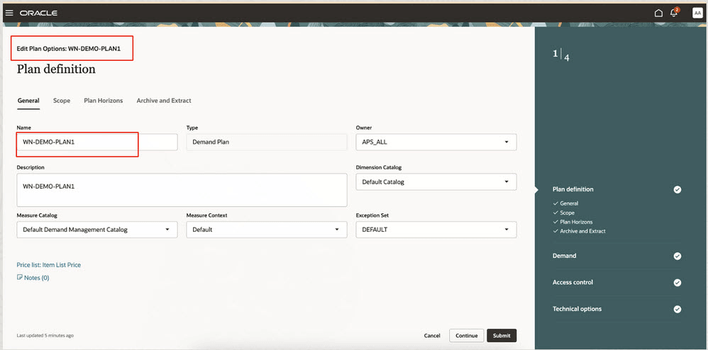

  1. Use the search bar or filters to find your demand plan in the list. Select the plan row and click the Edit icon to view or edit plan options.
  1. The Edit Plan Options page opens in a new browser tab. If you have edit access, you can update the plan definitions. If you have view only access, the page opens in view mode and you won't be able to make any changes.
Edit Plan Options Guided Process
  1. Review the plan definitions in the guided process and make changes as needed to meet your business requirements. When you're done, click Submit to save your changes.

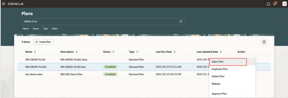

  1. To open a plan for demand analysis, select the desired plan and click the ellipses icon in the Action column. Then, select Open Plan from the menu.
Selecting Open Plan
The plan will open in a new browser tab.

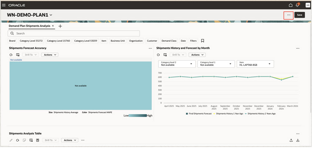

You can open various visualizations to review and analyze the demand plan output.

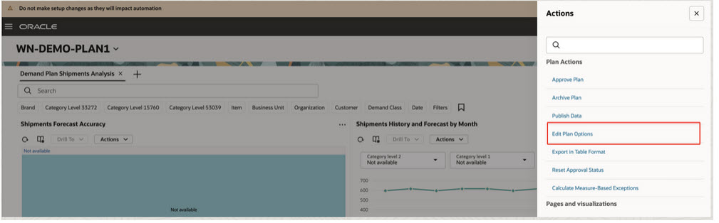

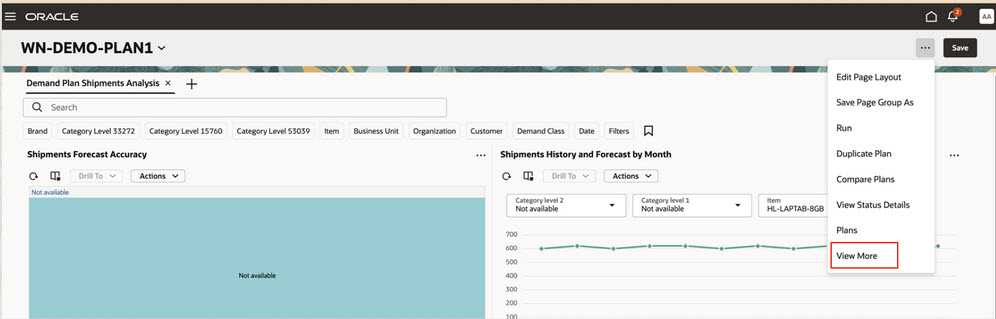

  1. If needed, you can access the Edit plan options page for the currently opened plan. Click the ellipses icon to open the More Actions menu, then select View More. Under Plan Actions, click Edit Plan Options. The page will open in a new browser tab.
Click ellipses icon to open more actions by selecting View More
Click on Edit Plan Options
