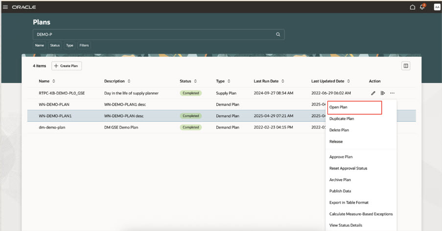

  1. On the Plans page, search for the plan that you want to open by using the keyword search or suggested filters.

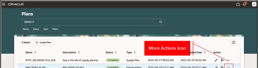

  1. For the plan that you want to open, in the Action column, click the More Actions icon (ellipses), and select Open Plan.

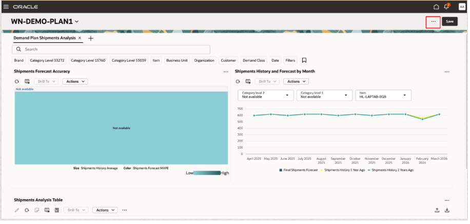

The plan will open on a new tab of your browser.
You can open the same plan on multiple browser tabs or different plans on different browser tabs.
More Actions Icon for Plan on Plans Page
Menu Item for Opening Plan
Opened Plan
Opened Plan
