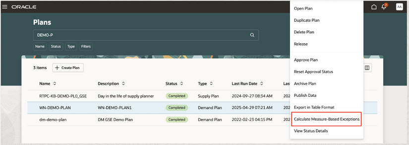

Follow these steps to submit the scheduled process from the Plans page:
  1. In the Redwood work area named Supply Chain Planning, click More Actions > Plans.
The Plans page opens on a new web browser tab and displays a list of plans that you own or have permission to access. Multiple plan actions are available for each plan based on the plan type.
  1. For the plan for which you want to submit the scheduled process, in the Action column, click the More Actions icon (ellipses), and select Calculate Measure-Based Exceptions.
A confirmation message is displayed.

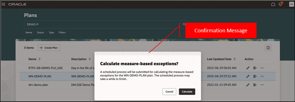

Confirmation Message for Calculating Measure-Based Exceptions
  1. Click Calculate.
The scheduled process named Calculate Measure Based Exception is submitted, and a confirmation message with the process ID is displayed.
When the scheduled process is completed, another confirmation message will be displayed.

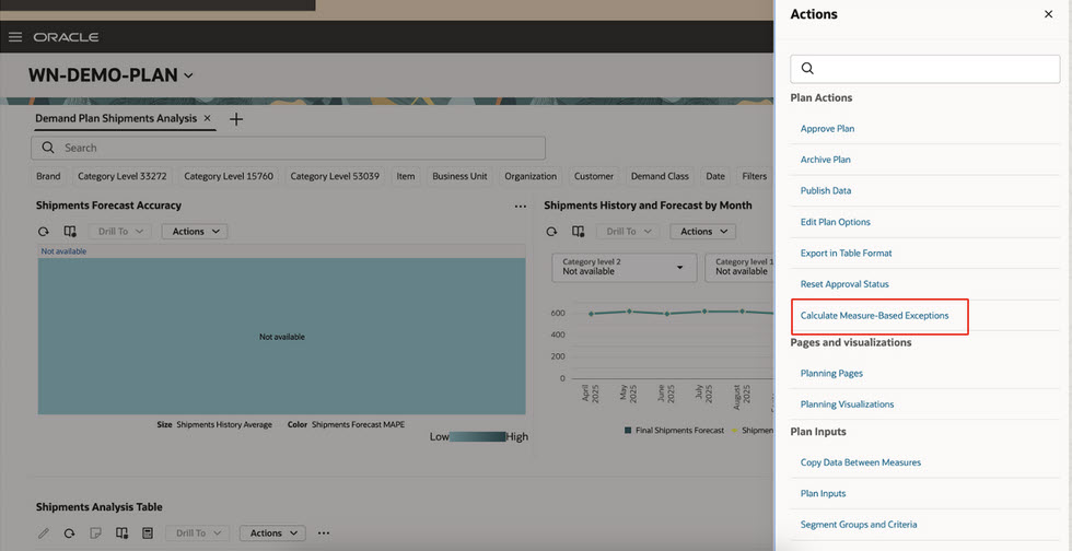

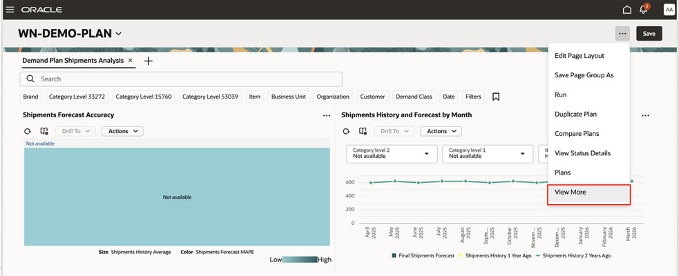

Follow these steps to submit the scheduled process from an open plan:
  1. In your plan, click More Actions > View More.
The Actions drawer will open.
More Actions Menu for Plan
Actions Drawer
Actions Drawer
  1. In Plan Actions, click Calculate Measure-Based Exceptions.
A confirmation message will be displayed.
  1. Click Calculate.
If any errors or warnings occur, then a message will be displayed at the top of the page.
