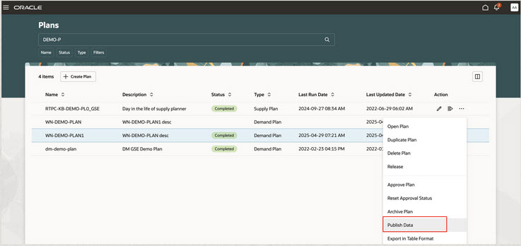

Follow these steps to submit the scheduled process from the Plans page:
  1. In the Redwood work area named Supply Chain Planning, click More Actions > Plans.
The Plans page opens on a new web browser tab and displays a list of plans that you own or have permission to access. Multiple plan actions are available for each plan based on the plan type.
  1. For the plan for which you want to submit the scheduled process, in the Action column, click the More Actions icon (ellipses), and select Publish Data.
The Publish data drawer opens.

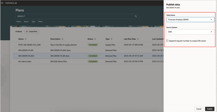

Publish Data Drawer
Publish Data Drawer
  1. Select the table and source system for which you want to publish data.
If you want to append the request ID for the scheduled process to the file name, select the checkbox.
  1. Click Publish.
The scheduled process named Publish Plan is submitted, and a confirmation message with the process ID is displayed.

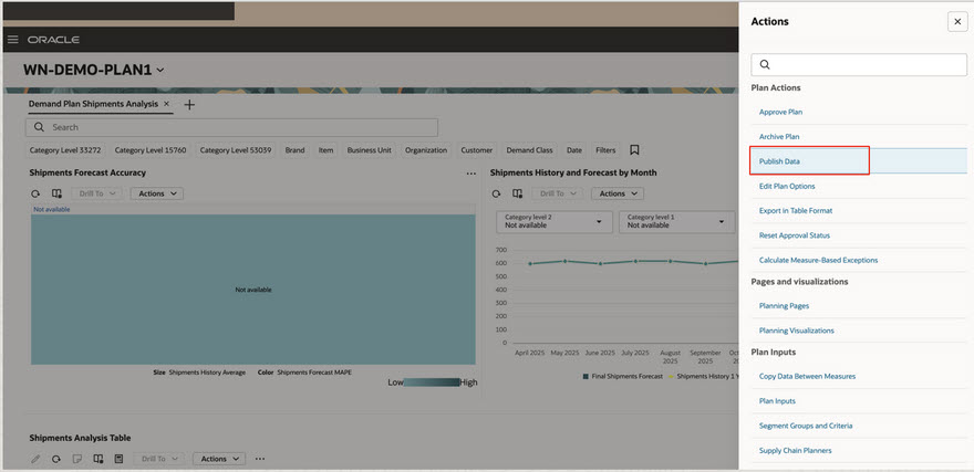

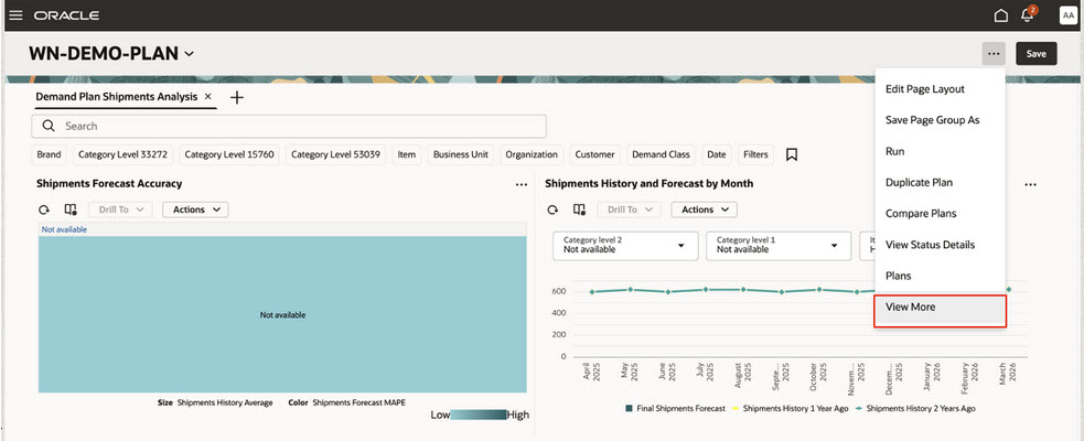

Follow these steps to submit the scheduled process from an open plan:
  1. In your plan, click More Actions > View More.
The Actions drawer will open.
More Actions Menu for Plan
Actions Drawer
Actions Drawer
  1. In Plan Actions, click Publish Data.
The Publish data drawer will be displayed.
  1. Click Publish.
