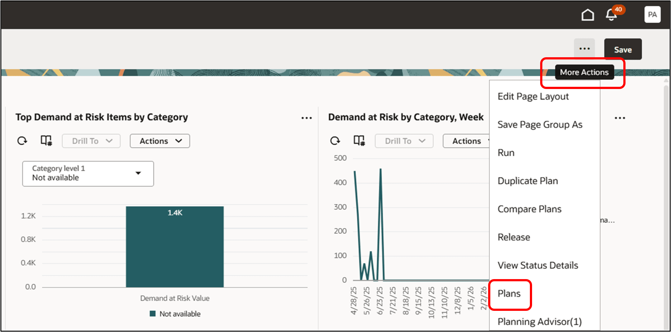

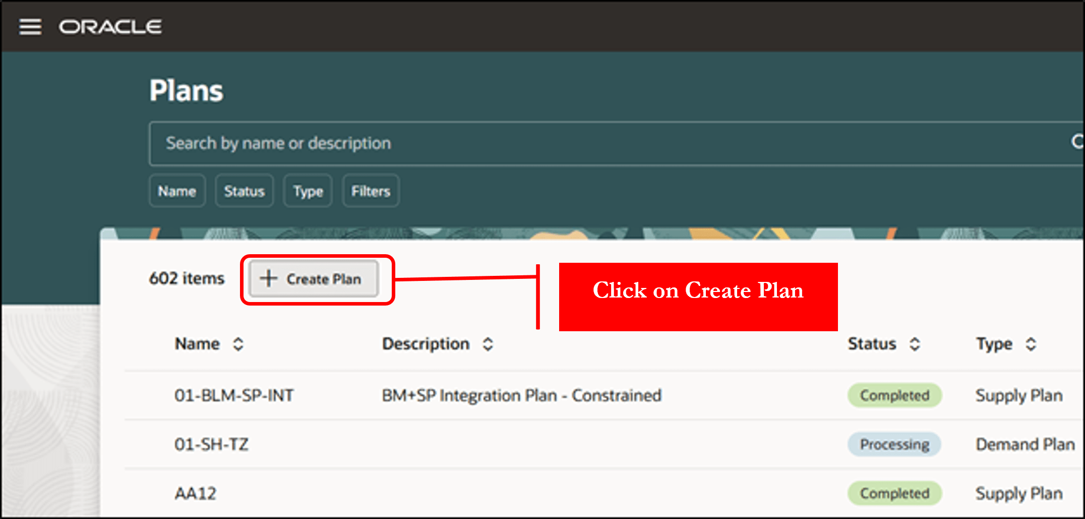

To create a demand and supply plan from the Redwood Supply Chain Planning work area:
  1. In the Supply Chain Planning work area, navigate to More Actions > Plans.
    The Plans page opens on a new web browser tab and displays a list of plans that you own or have permission to access. Multiple plan actions are available for each plan based on the plan type.
Select Plans in the Redwood Supply Chain Planning Work Area
  1. Click Create Plan.
Create a Plan from the Plans Page

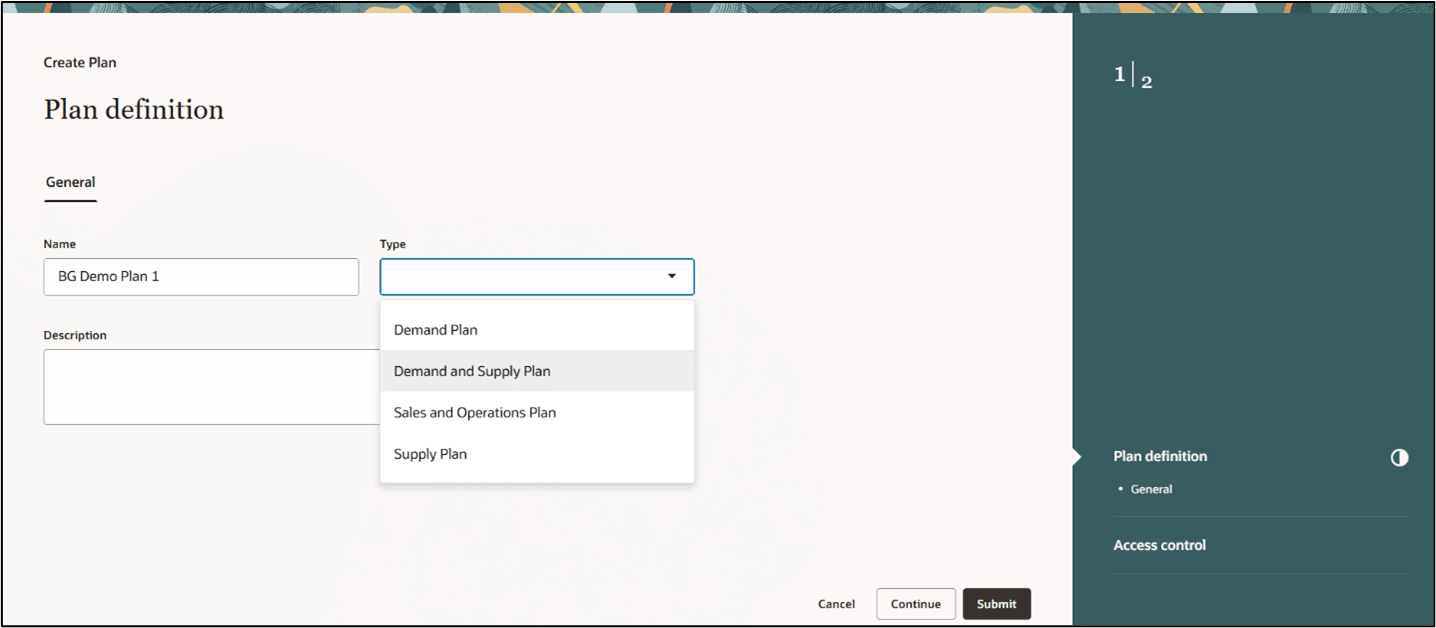

           A guided process opens in a new browser tab, displaying Name, Type, and Description.
  1. Enter a Name and Description and select Type as Demand and Supply Plan.
Create a Demand and Supply Plan in the Guided Process

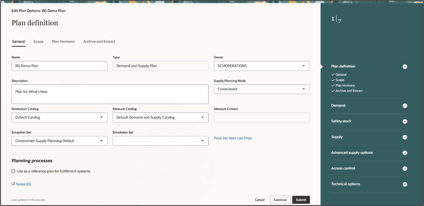

Plan Definition General Tab Plan Options
  1. In the Plan definition page, use the General tab to modify the following plan options as needed:
  • Name
  • Type
  • Owner
  • Description
  • Supply Planning Mode
  • Exception Set
  • Simulation Set
  • Dimension Catalog: A selected list of hierarchies in different dimensions enabled for use in plans.
  • Measure Catalog: A collection of predefined and user-defined measures for use in plans.
  • Measure Context: Measure contexts are categorized into three types:
    • Default: Predefined and user-defined measures with only predefined dimensions and stored levels.
    • Project: Predefined measures include project dimensions. User-defined measures can include project dimensions either during creation or through Change Granularity.
    • Planning Attributes: Predefined measures can be deployed with planning attribute dimensions. User-defined measures can include planning attributes during creation or through Change Granularity.
           Click the Scope tab to continue.

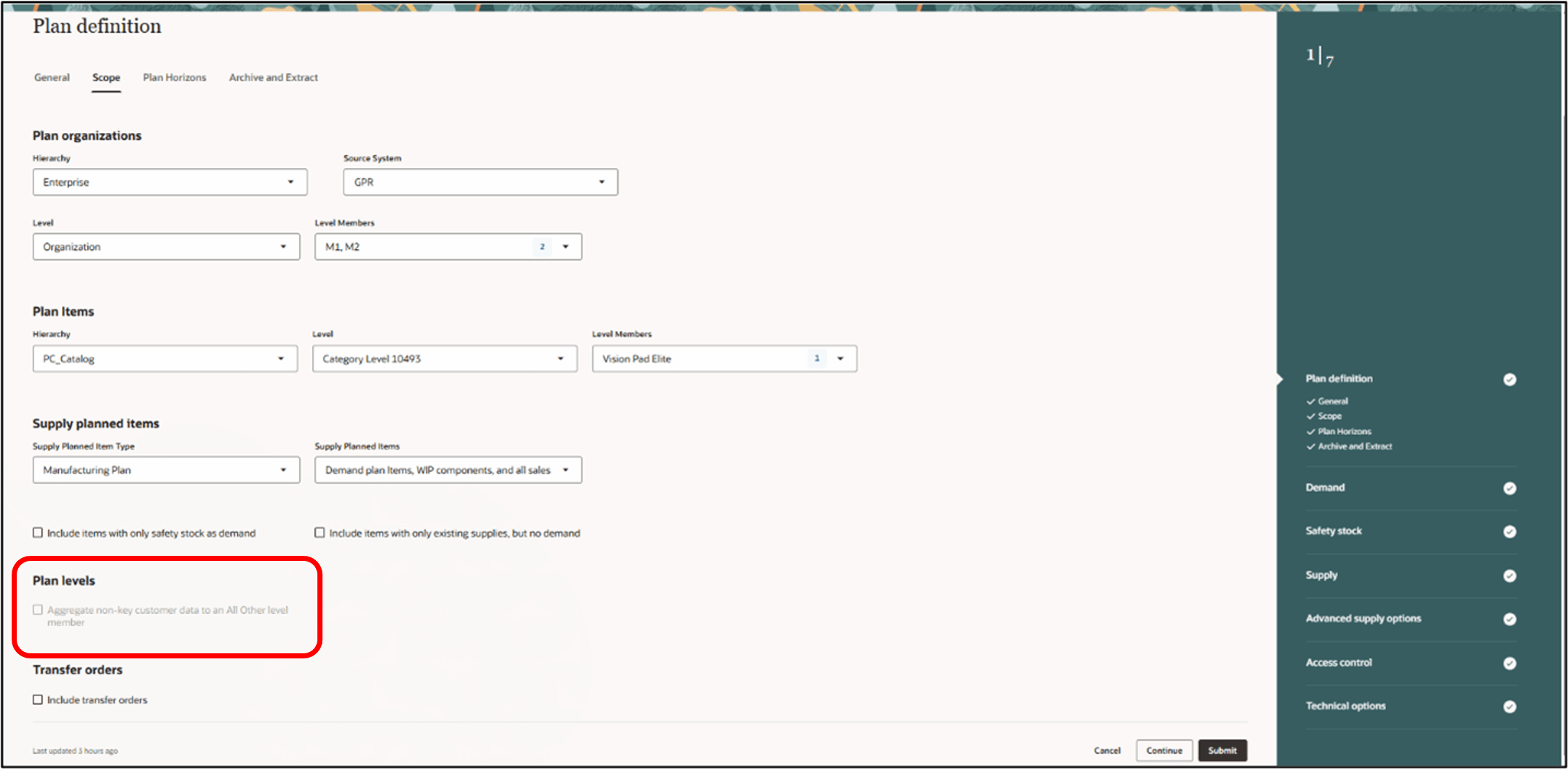

  1. On the Scope tab, select Source System and Level Members for plan organizations. Then, select Hierarchy, Level, and Level Members for plan items.
The Aggregate non-key customer data to an All Other level member checkbox applies only to demand planning. To enable this feature, upload a file that identifies key customers and run collections. Click the Plan Horizons tab to continue.
Plan Definition Scope Tab Plan Options

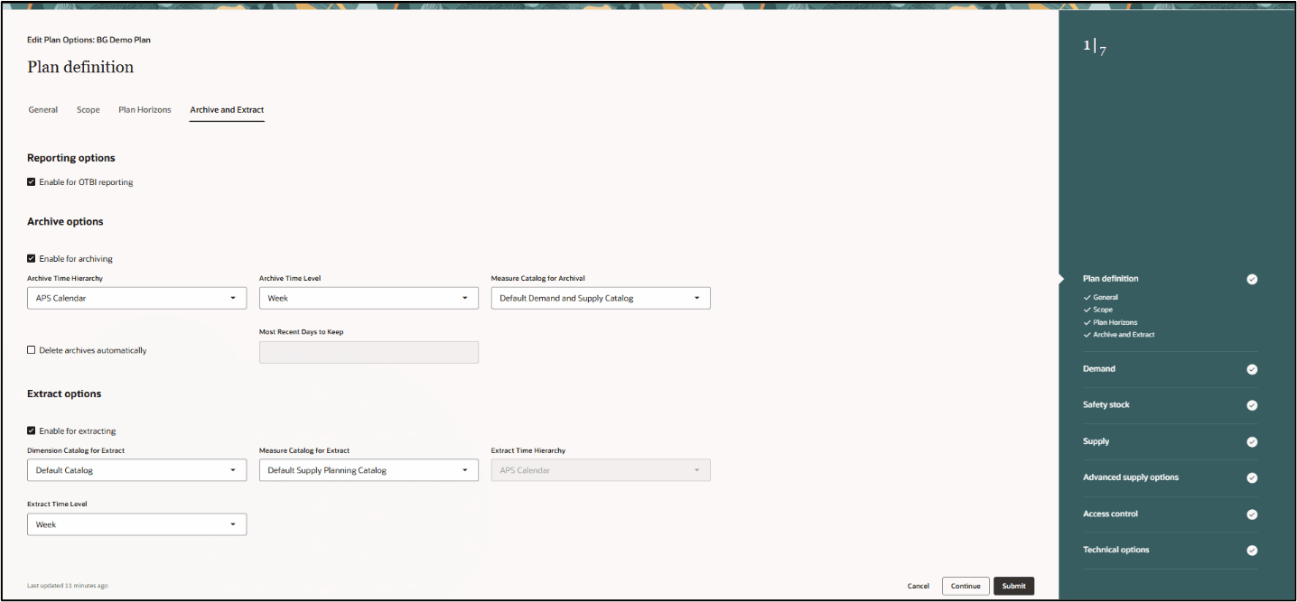

Click the Archive and Extract tab to continue.
  1. On the Archive and Extract tab, select the Archive options and Extract options.
Archiving saves multiple versions of a plan's measures over time, while extracting lets you pull data for offline reports or external system integration.
Plan Definition Archive and Extract tab Plan Options

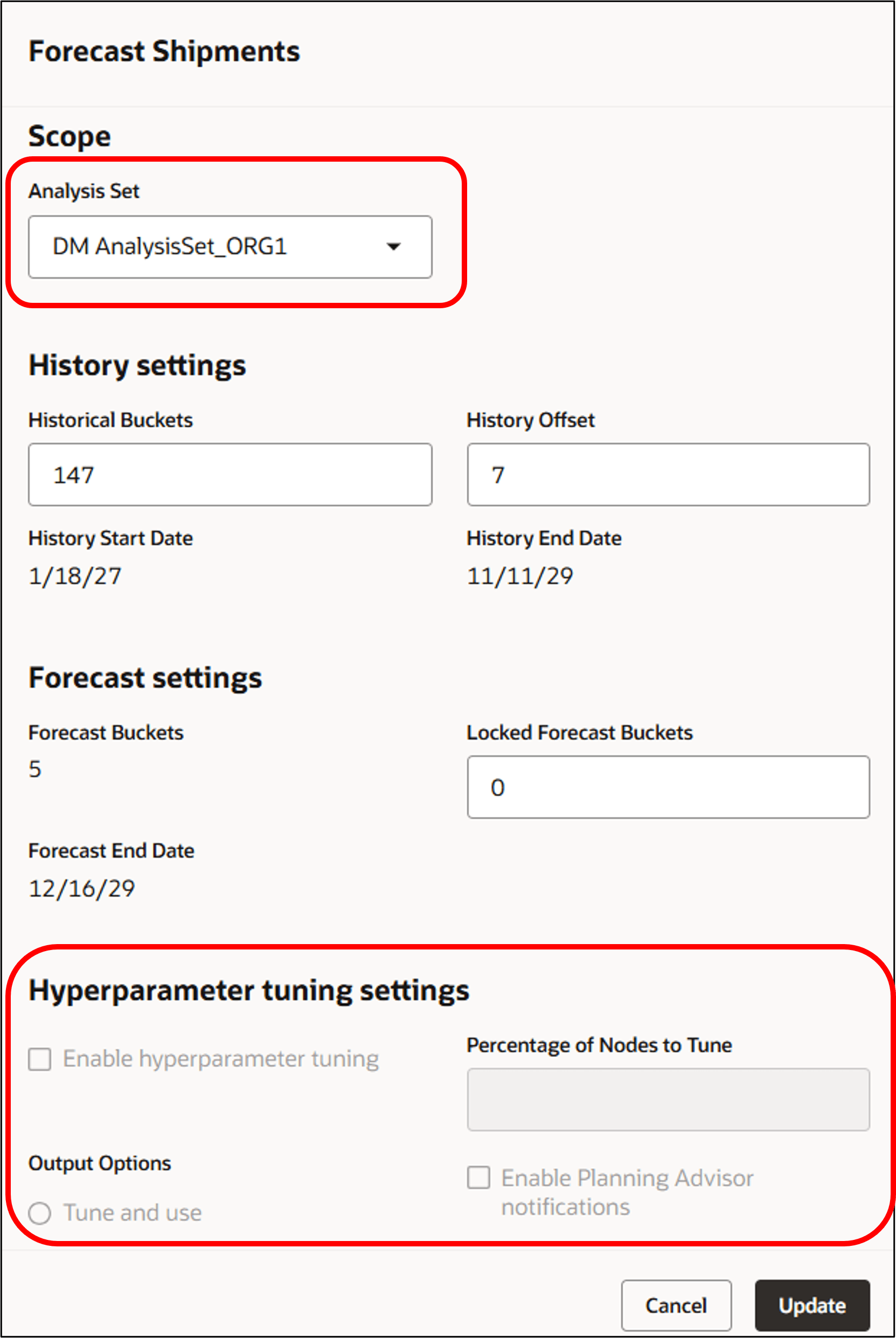

In the Forecast Settings Details Panel, update the following options:
  • Analysis Set: You can use an analysis set to apply a forecasting profile to a specific subset of the plan scope to focus on specific items and organizations.
  • Hyperparameter tuning settings: Hyperparameter tuning uses machine language to automate the forecast tuning process to optimize forecast parameters.
Forecast Settings Plan Options

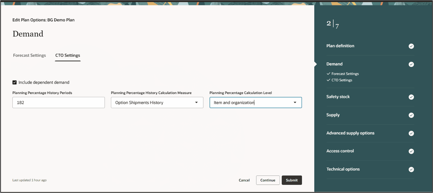

Click the CTO Settings tab to continue.
  1. In the CTO Settings tab, specify the following planning percentage attributes:
  • Planning Percentage History Period
  • Planning Percentage History Calculation Measure
  • Planning Percentage Calculation Level
CTO Settings Plan Options

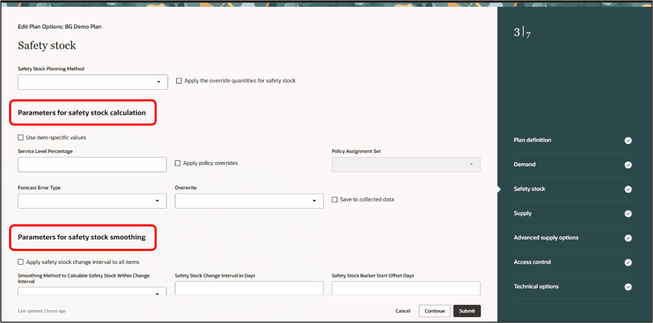

Click Continue to go to the Safety Stock step.
  1. In the Safety Stock step, configure calculation and smoothing parameters, select Safety Stock Planning Method, and apply override quantities.
Safety Stock Plan Options
  • Parameters for safety stock calculation: Define key parameters, including Service Level Percentage and Forecast Error Type.
  • Parameters for safety stock smoothing: Planners often aim to minimize safety stock fluctuations, as daily changes can be difficult to manage. Even minor adjustments can significantly impact projected available balances due to order modifiers. Safety stock smoothing plan options help control daily and weekly variations, improving stability.

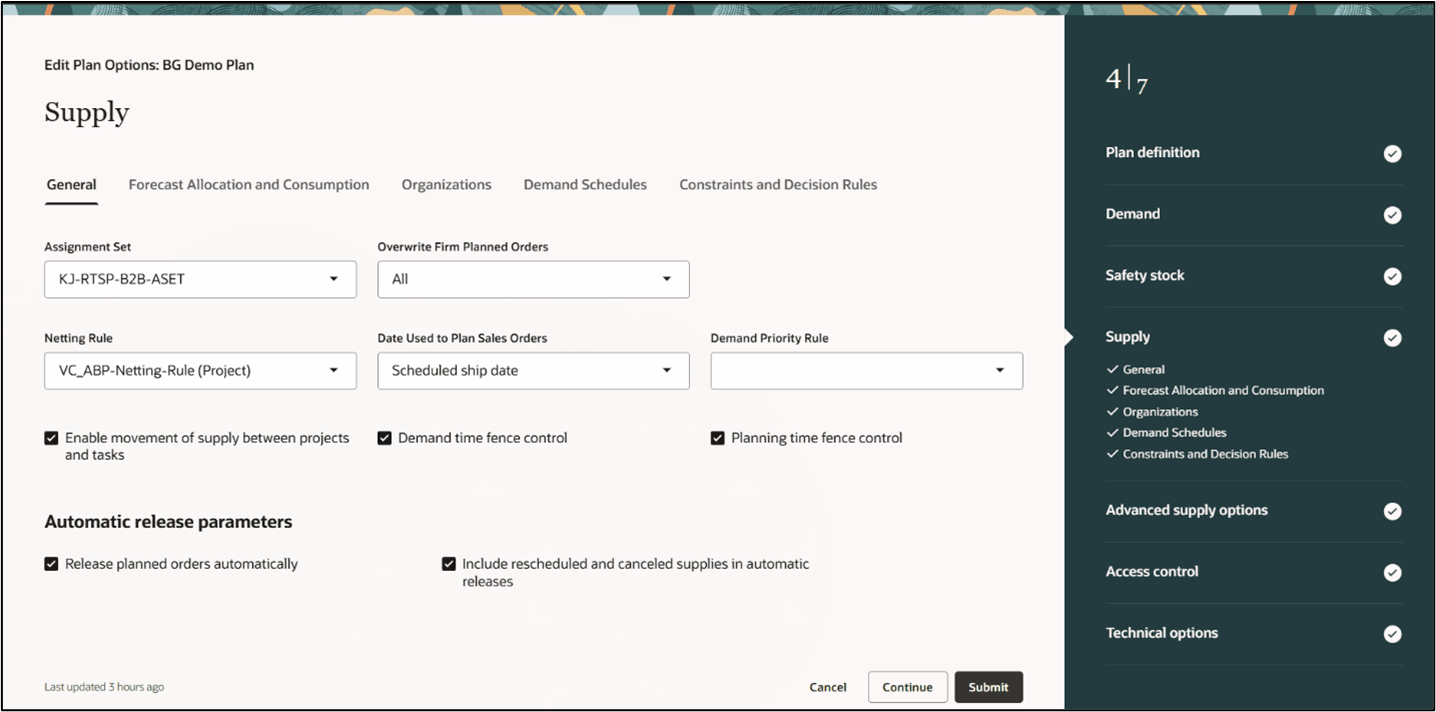

Click Continue to go to Supply step.
  1. In the Supply step, go to General tab and select an Assignment Set.

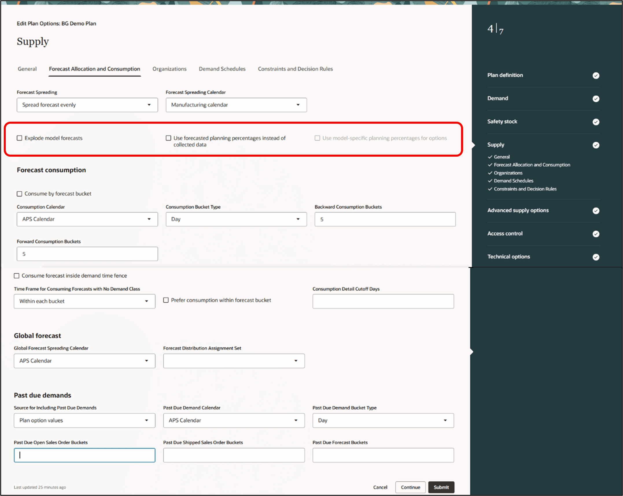

Click the Forecast Allocation and Consumption tab to continue.
Supply General Tab Plan Options
  1. On the Forecast Allocation and Consumption tab, you can see the options for forecast spreading and model forecasts. It also covers forecast consumption, global forecast, and past due demands.
When exploding model forecasts with forecasted planning percentages, you can use model-specific planning percentages for options.
Forecast Allocation and Consumption Plan Options

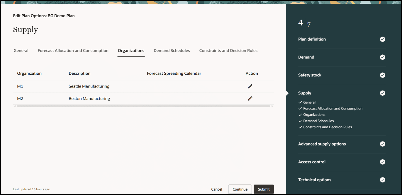

Click the Organizations tab to continue.
  1. The Organizations tab includes the Organization, Description, Forecast Spreading Calendar, and Action columns. To update the organization parameters, click the Edit icon in the Action column.
Supply Step with Organizations Tab

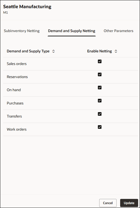

These parameters primarily relate to Subinventory Netting, Demand and Supply Netting, and Forecast Spreading Calendar.
Organization Subinventory Netting
Organization Demand and Supply Netting

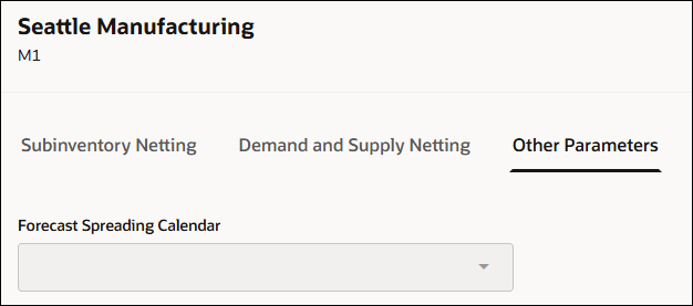

Organization Forecast Spreading Calendar

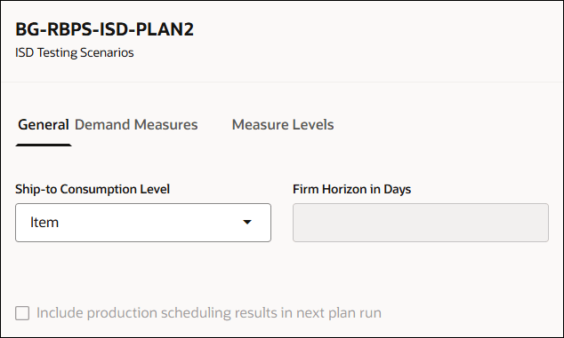

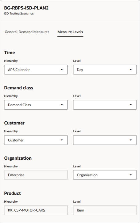

Demand Schedule Parameters
Demand schedule parameters are organized into three tabs: General, Demand Measures, and Measure Levels.
Demand Schedule General Parameters

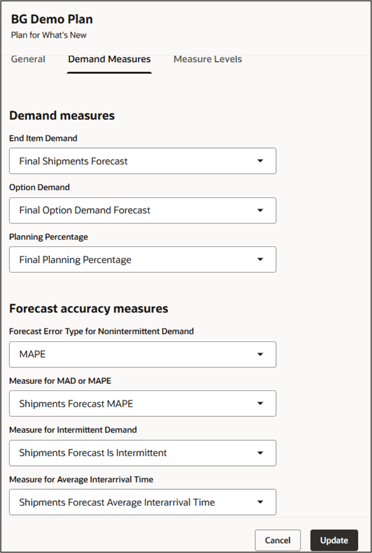

Demand Schedule Demand Measures
Forecast accuracy measures require the Safety Stock Forecast Error Type to be set to Demand schedule specific.
Demand Schedule Measure Levels

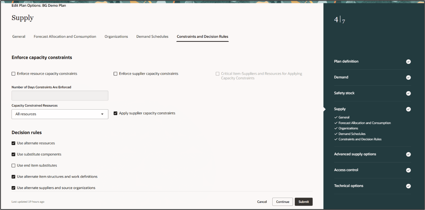

Click the Constraints and Decision Rules tab to continue.
  1. The Constraints and Decision Rules tab is enabled only for constrained supply plans.
The Constraints and Decision Rules tab includes options to set Enforce capacity constraints and Decision rules.
  • Enforce capacity constraints: Use this section to specify constraints for resource capacity, supplier capacity, and other capacity attributes.
  • Decision rules: Use this section to specify decision rules such as alternate and substitute sources.
Constraints and Decision Rules Plan Options

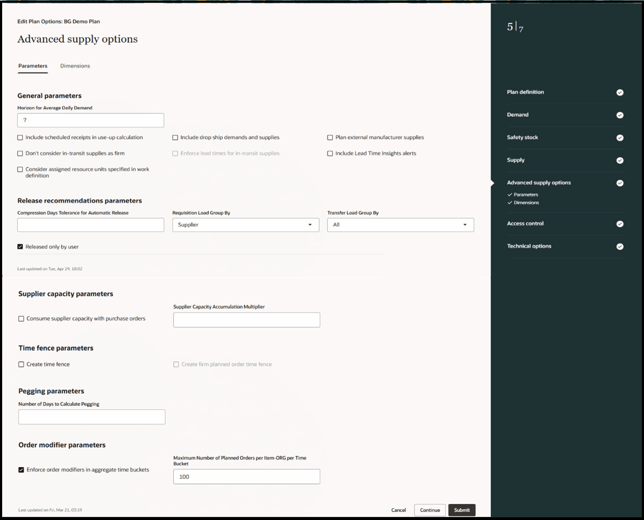

Click Continue to go to the Advanced Supply Options step.
  1. In the Advanced supply options step, go to the Parameters tab.
Advanced parameters cover release recommendations, supplier capacity, time fences, pegging, and order modifiers. Additionally, you can enforce order modifiers in aggregate time buckets to control the planning cycle time by applying order policies to defined time periods, such as weeks or periods.
Advanced Supply Options Parameters Tab

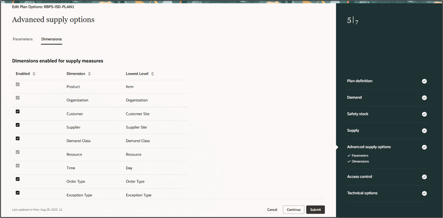

Click the Dimensions tab to continue.
  1. On the Dimensions tab, enable tracking for supply measures such as Customer, Supplier, Demand Class, and Order Type.
Advanced Supply Options Dimensions Tab

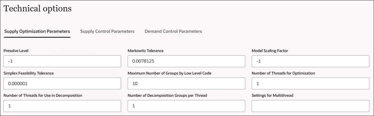

  1. In the Technical options step, go to the Supply Optimization Parameters tab.
Don't modify these default values unless explicitly advised by your Oracle Help Desk.

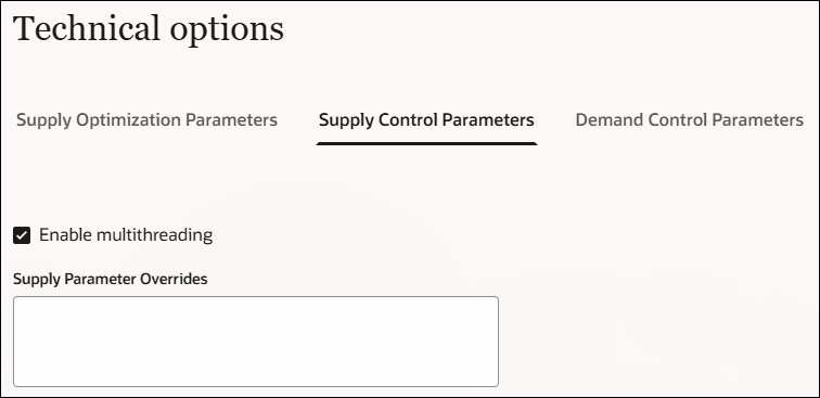

Click the Supply Control Parameters tab to continue.
  1. On the Supply Control Parameters tab, specify the following:
  • Enable multithreading: Use multithreading to reduce the overall runtime of a supply plan.
  • Supply Parameter Overrides: You can override the default planning behavior using the Parameter Overrides field. Use this option only when instructed by the Oracle Help Desk, typically to address specific issues raised in a service request.

  1. Forecast Spreading Calendar
The forecast spreading calendar in the Other Parameters tab is enabled when:
  • Forecast Spreading is set to Spread forecast evenly in the Forecast Allocation and Consumption tab.
  • A Demand and Supply type of forecasts is defined in the Demand and Supply Netting tab.
