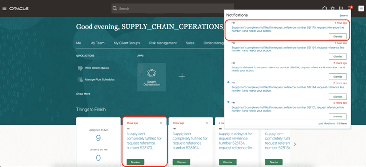

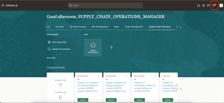

In this example, a supply chain manager can click the bell to view the alert:
Click bell to view alert
View the alerts in the Notifications dialog, then click one. . .
Click a notification

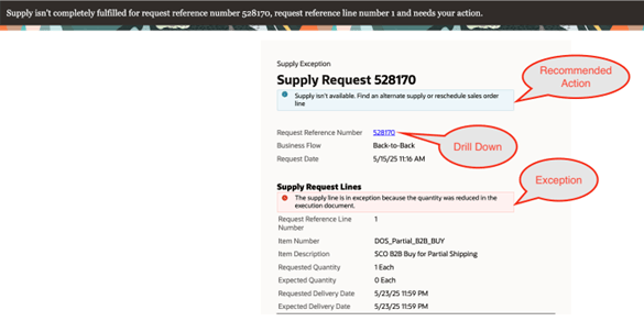

. . . to examine details:
Details
