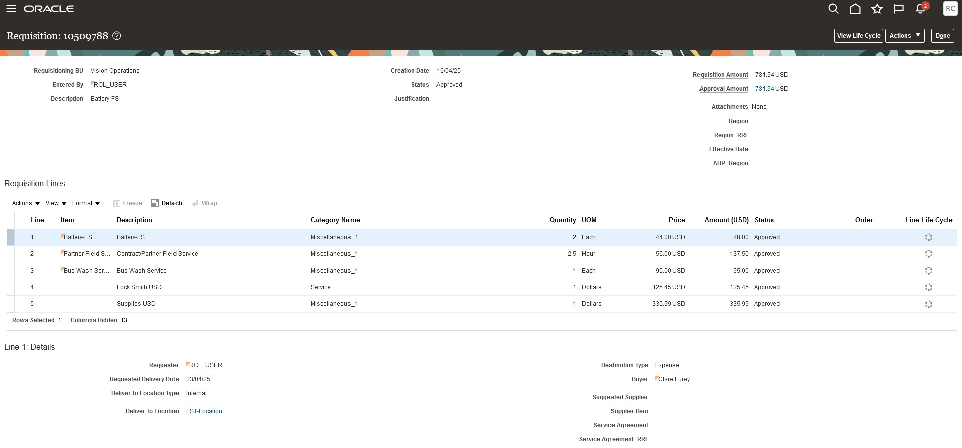

With this new feature, you can associate purchase requisition lines to service work order expense charges to capture all of the work order's costs and bill the customer for the services and/or materials purchased to execute the service work order.
The screen shot below displays a purchase requisition created for services and materials needed to execute a service work order.  You will reference these requisition lines when creating expense charges in the Work Order Charges page.
Purchase Requisition for Services and Materials needed for a Service Work Order

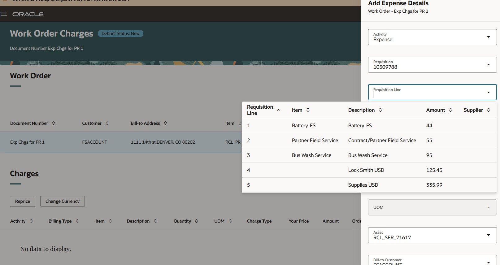

On the Add and Edit Expense Charge pages, you can now select the purchase requisition and purchase requisition line.  As you can see in the screen shot below, the requisition line list of values (LOV) displays the requisition item (if entered), the supplier, and the requisition amount.
Add Expense Charge UI with Requisiton Line Drop Down
Add Expense Charge Page with Requisition Line Drop Down List

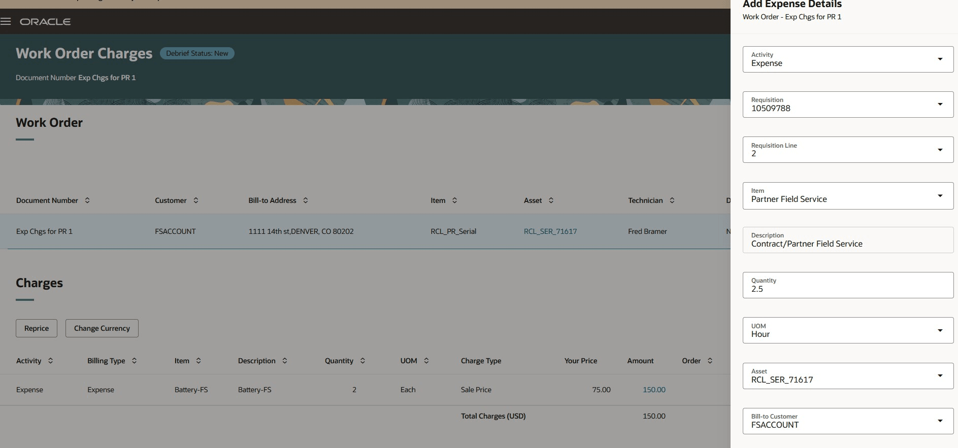

Once the line is selected, if the requisition has an item, it defaults, along with the quantity and UOM.
Expense Charge associated to Requisition Line with an Item
Expense Charge for a Requisition Line with an Item

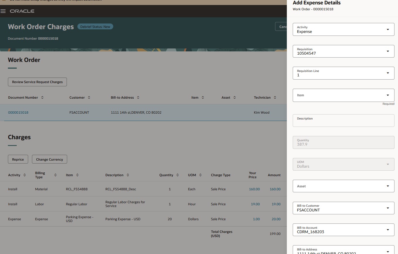

When there isn't an item on the requisition line, the UOM defaults from the currency on the requisition and the quantity defaults from the requisition amount.  In this case, the user will have to select the item that will be used to capture costs and bill the customer when the charges are posted.  Note: You can use a service activity code that will capture the costs without billing the customer when you are not passing along the requisition costs to the end customer.
Expense Charge for a Requisiton Line wihout a Item
Expense Charge for a Requisition Line without an Item

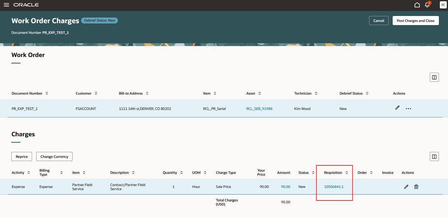

When these expense charges are created, the price is calculated and the charge is displayed along with the associated requisition and line numbers.
Expense Charge with Requisition
The user can drill down on the requisition number to open the purchase requisition page.
Purchase Requisition Drill Down
