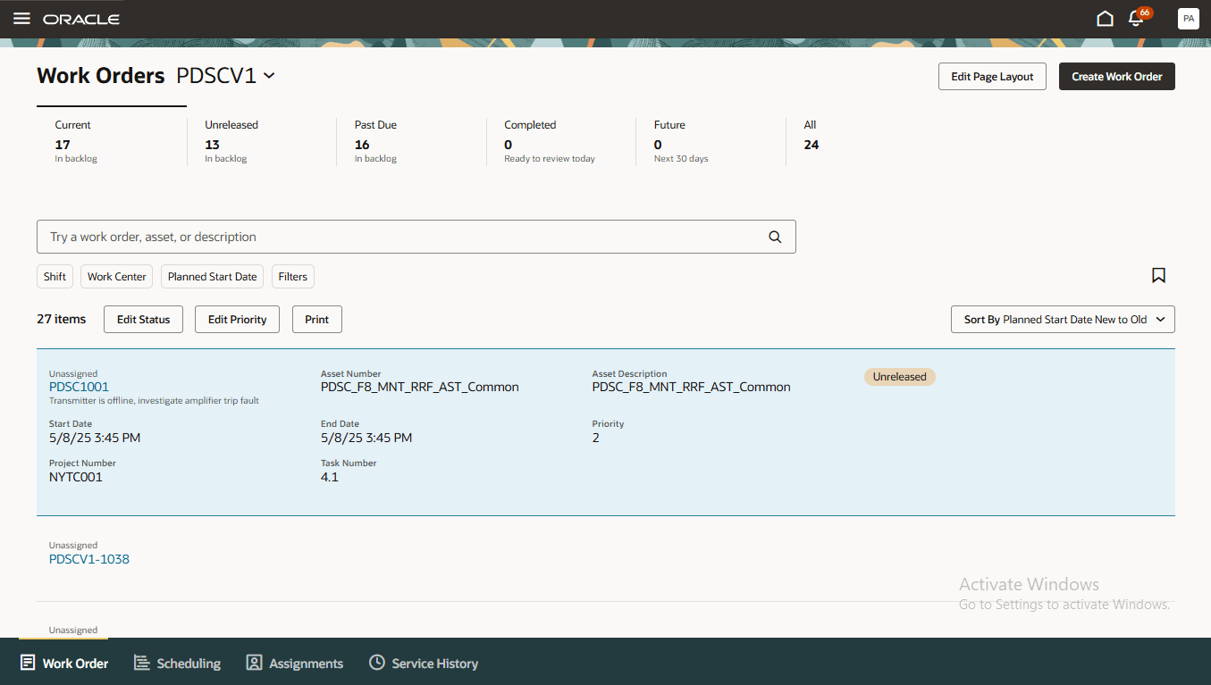

Manage project-based work orders in project-enabled organizations in Maintenance Supervision. The Work Orders tab now has two new attributes for Project Number and Task Number. These fields allow you to map work orders to their projects and tasks. Here's a screenshot of the Work Orders page, that shows a sample work order mapped to a sample project and its task via the Project Number and Task Number fields.
Work Orders tab with Project Number and Task Number

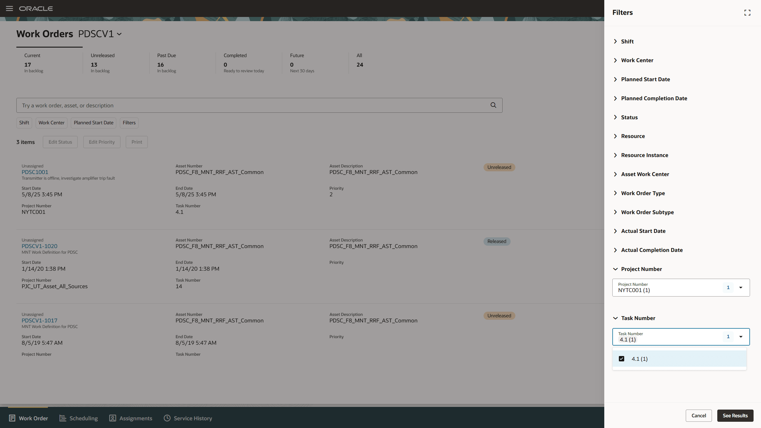

You can also use project number and task number as filters to quickly locate the project-specific work orders.
Here's a screenshot of the Filters drawer that shows the new search filters for Project Number and Task Number.
Screenshot showing new filters for Project Number and Task Number
Project Number and Task Number Filters for Work Orders

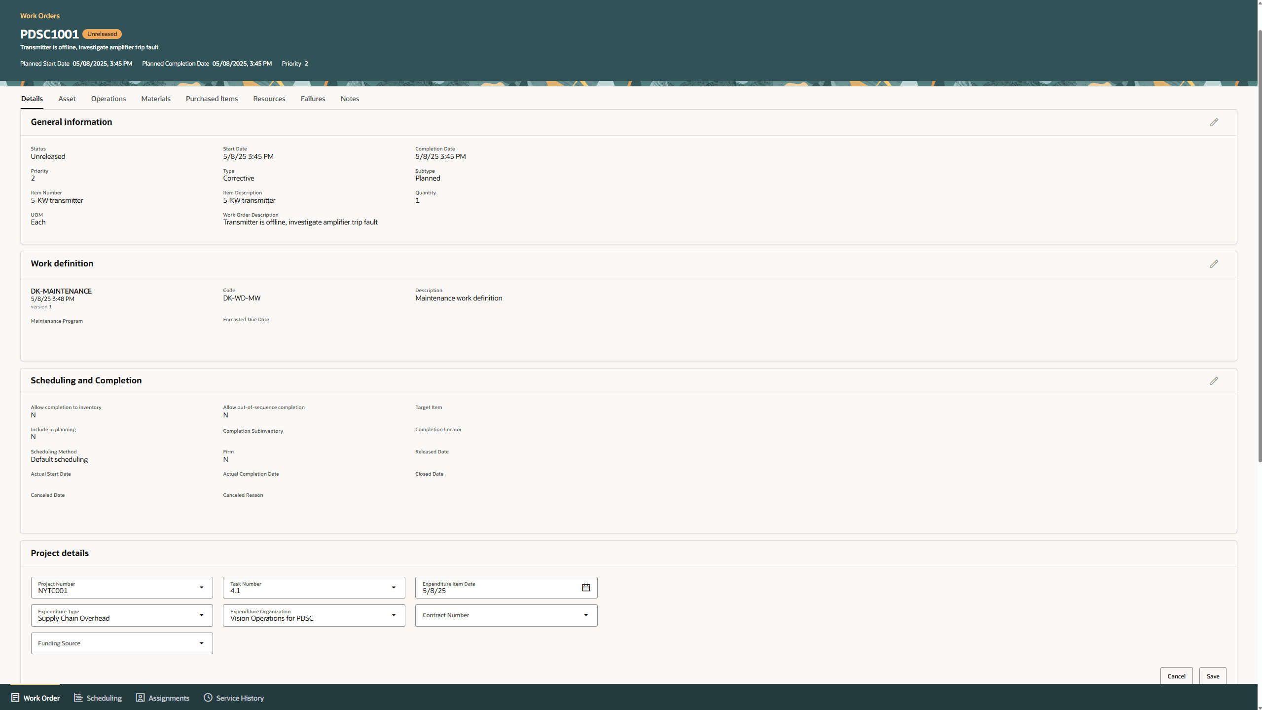

The Work Orders details page contains a new section for Project details and has the following new attributes: Project Number, Task Number, Expenditure Item Date, Expenditure Type, Expenditure Organization, Contract Number, and Funding Source. After you select values for Project Number and Task Number, other fields automatically default. You can modify these details when you create or edit an unreleased maintenance work order.
Here's a screenshot of the Work Orders edit page with the new section for project details.
Edit Maintenance Work Order with new section for Project Details
Edit Maintenance Work Order with New Section for Project Details

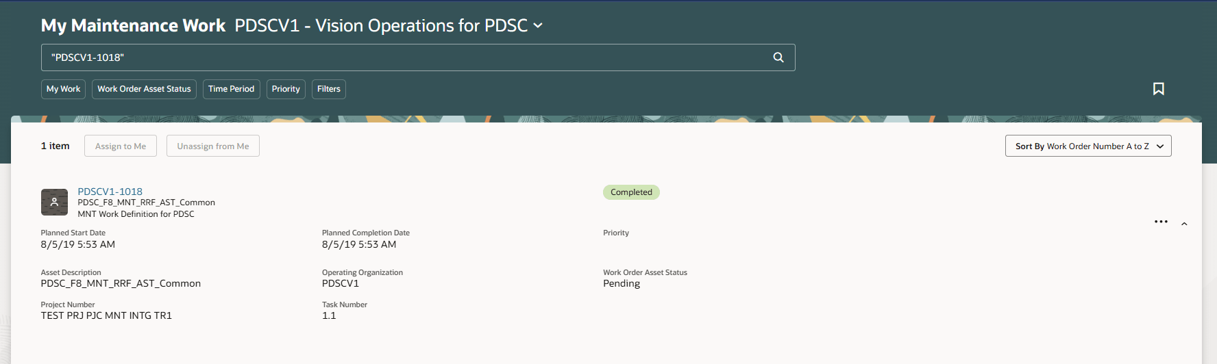

Search for work orders and operations with new filters for Project Number and Task Number to quickly locate project-specific work orders. The work order rows in My Maintenance Work page also contain new attributes for Project Number and Task Number. Here's a screenshot of a work order that's associated with a project and a task related to a project-enabled organization.
My Maintenance Work page with the new attributes for Project and Task Number
My Maintenance Work Page with the New attributes for Project and Task Number

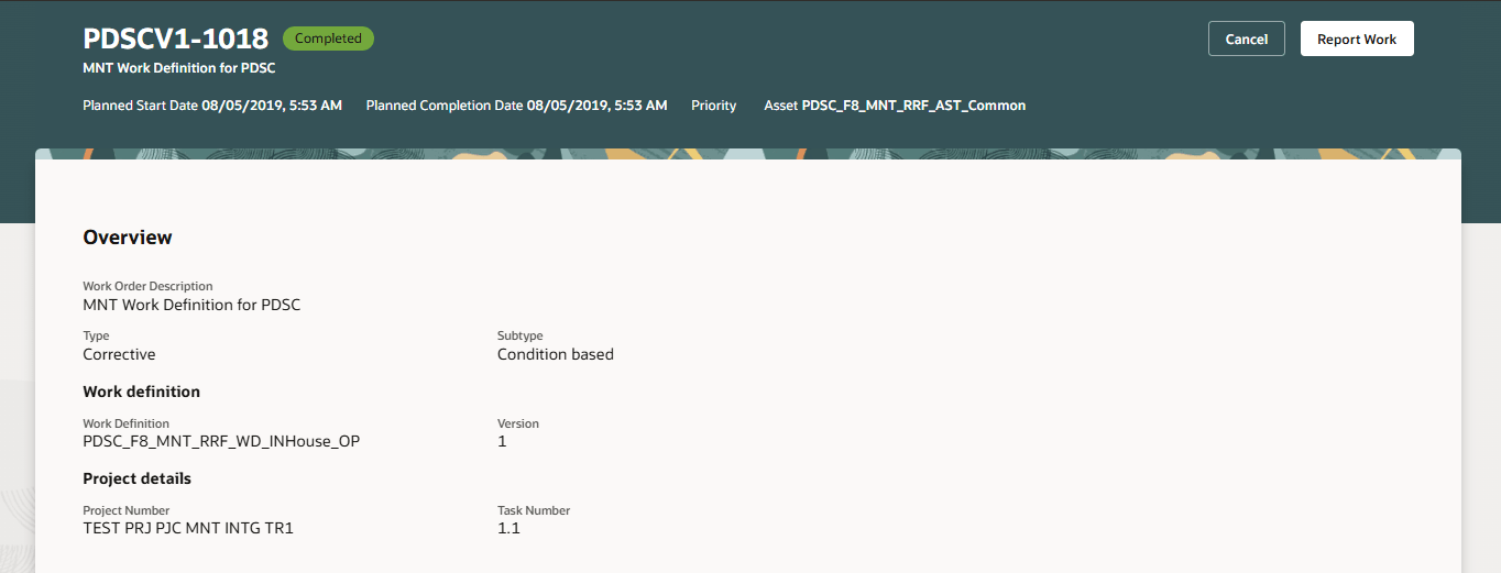

View Project Number and Project task on the Preview Work Order under a new section for Project Details. The screenshot here, shows the preview of a work order with a new section showing the project details.
Preview Work Order with a new section for Project Details

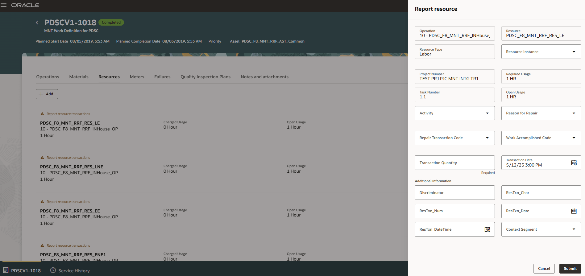

Reference the project and task number when issuing materials on the Materials tab and when reporting resource transactions on the Resource tab during work execution. The new Use Common Inventory check box for a component, highlighted in the screenshot below, is selected based on the item setup, and if selected, the material is transacted from the common stock to the project-based maintenance work order.
Materials tab with Project and Task Number references for Work Execution
Rescources tab with Project and Task Number references for Work Execution
Resources tab with Project and Task Number references for Work Execution
