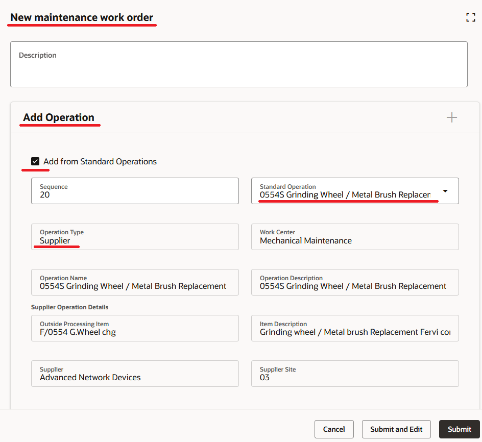

In Maintenance Supervision, you can create a single-asset-maintenance work order with supplier operations.
You can add supplier operations to a work order from:
  • Create New maintenance work order drawer
  • The Operations tab in work order details
Here's a screenshot that shows the create New maintenance work order drawer with the addition of an OSP operation.
Maintenance Work Order Drawer with an OSP Operation

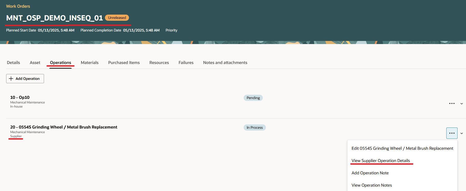

The screenshot here shows the Operations tab in work order details with the OSP operation.
Work Order Details with the Operations tab

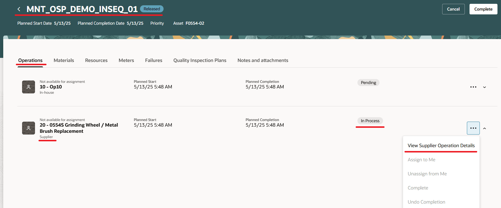

My Maintenance Work
In My Maintenance Work, technicians now have the visibility into Outside Processing (OSP) operations in a maintenance work order. The OSP operation status before receiving the outside processing item will be In Process. After receiving the outside processing item, the status changes to Pending and then can be completed. However completion of the operation depends on various factors like out-of-sequence work order and materials requirements.
Here's a screenshot that shows a work order in My Maintenance Work with an OSP operation.
My Maintenance Work with OSP Operations
During Work Order Preview, technicians can view all operations including supplier operations.
View Supplier Operations Details

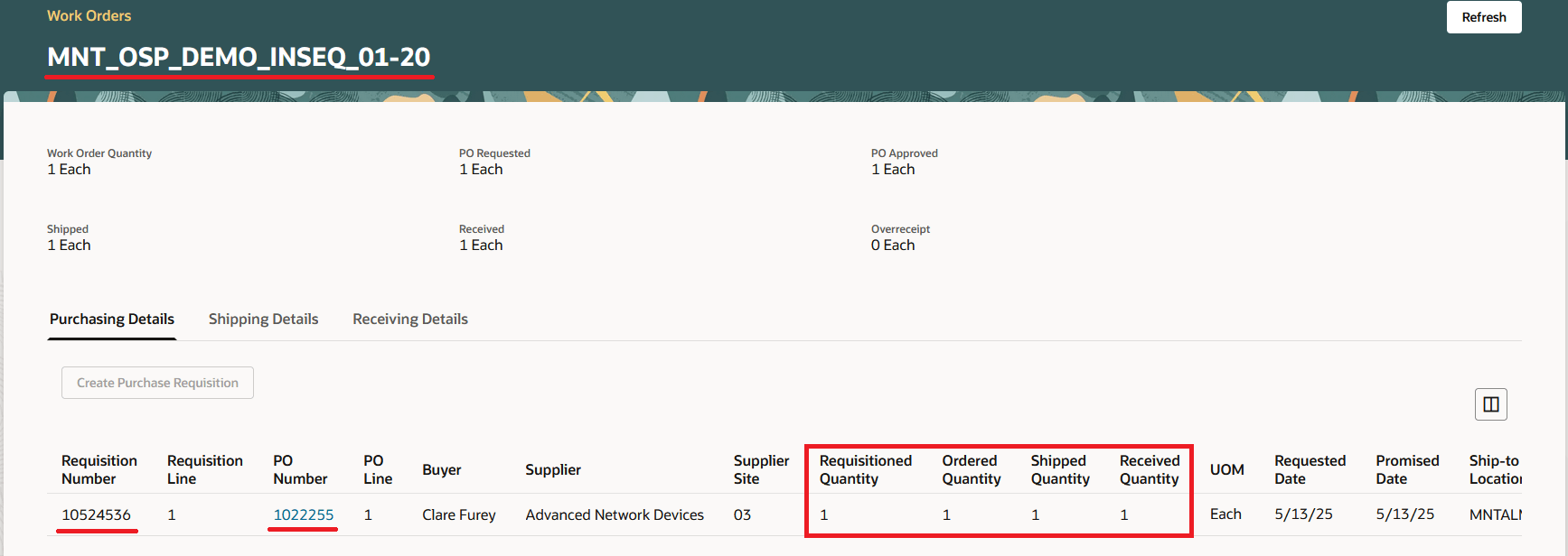

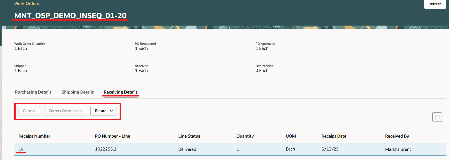

A new action, View Supplier Operation Details, is available for supplier operations in both My Maintenance Work and Maintenance Supervision. You can view supplier operation details like automated purchase requisition, purchase order created for the outside processing service item, and the corresponding shipment line for the goods sent to the supplier. You can perform certain actions against the receipt like correction and returns.
The screenshot here shows the Supplier Operation Details page with the purchasing details.
Supplier Operation Details page with Purchasing Details tab
Here's another screenshot that shows the Supplier Operation Details page with the receiving details.
Supplier Operation Details page with Receiving Details tab
