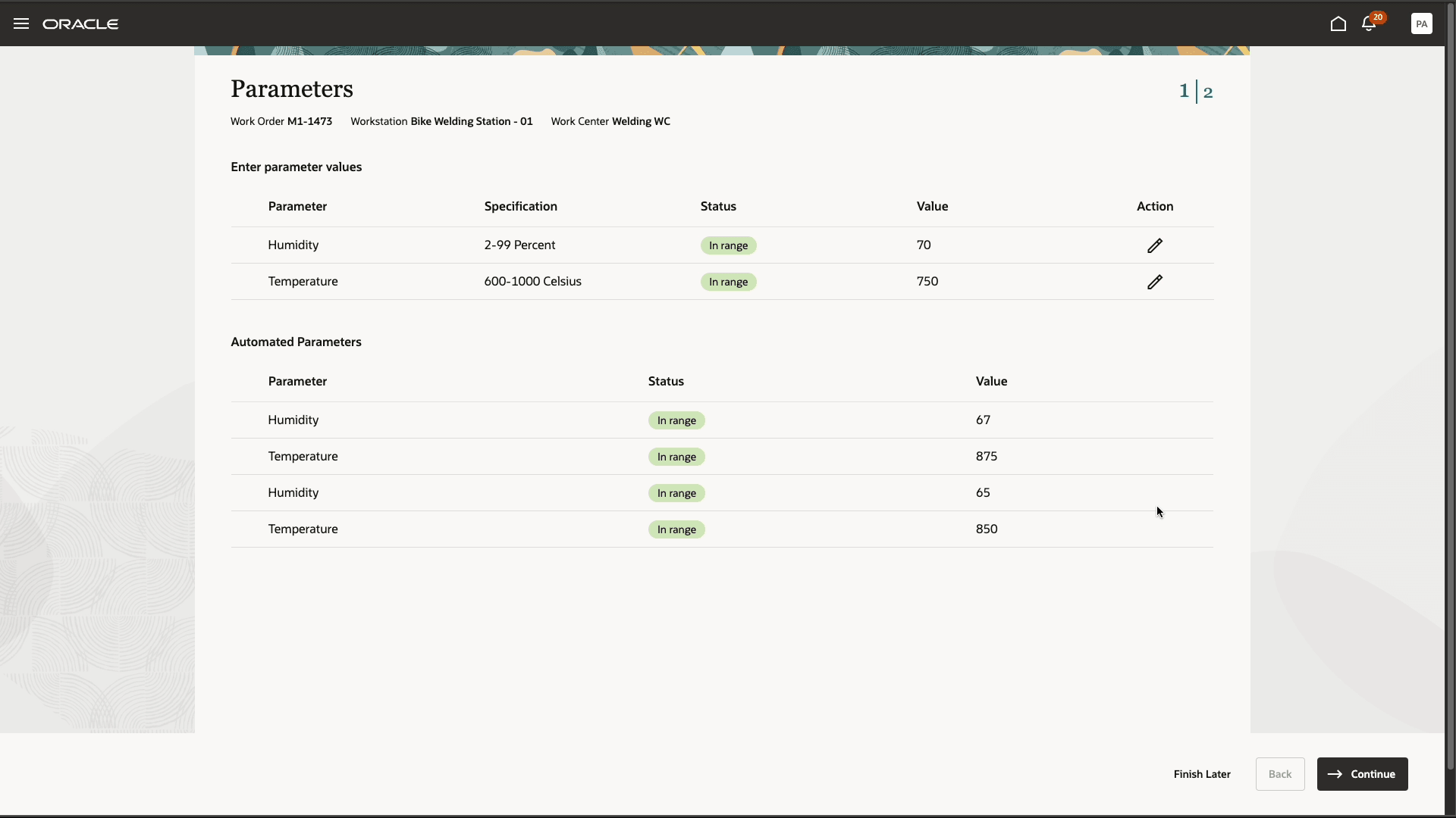

With this update, you can now record process data as operational parameter values when completing a work order operation at a workstation. The operational parameters are predefined for the work definition operation by the manufacturing engineer. When an operator is completing the operation at a workstation, the operator records the parameter values in context of the work order operation.  The process operational parameters data is stored as part of the production record. You can also view the automatically collected operational parameters in the Production Transaction History tab in the production supervisor workbench.
Enter Operational Parameters Manually

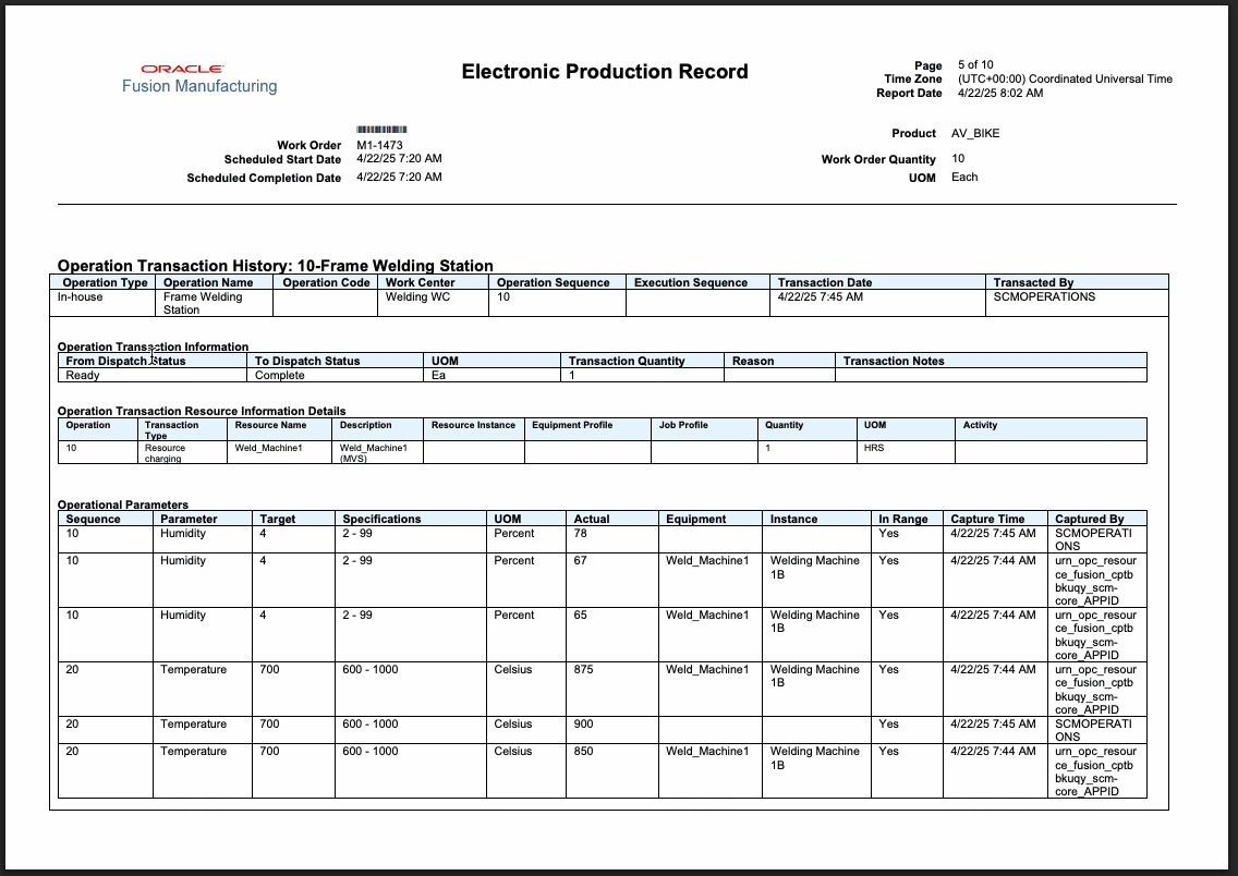

Operational Parameters in Electronic Production Record
Operational Parameters in the Electronic Production Record

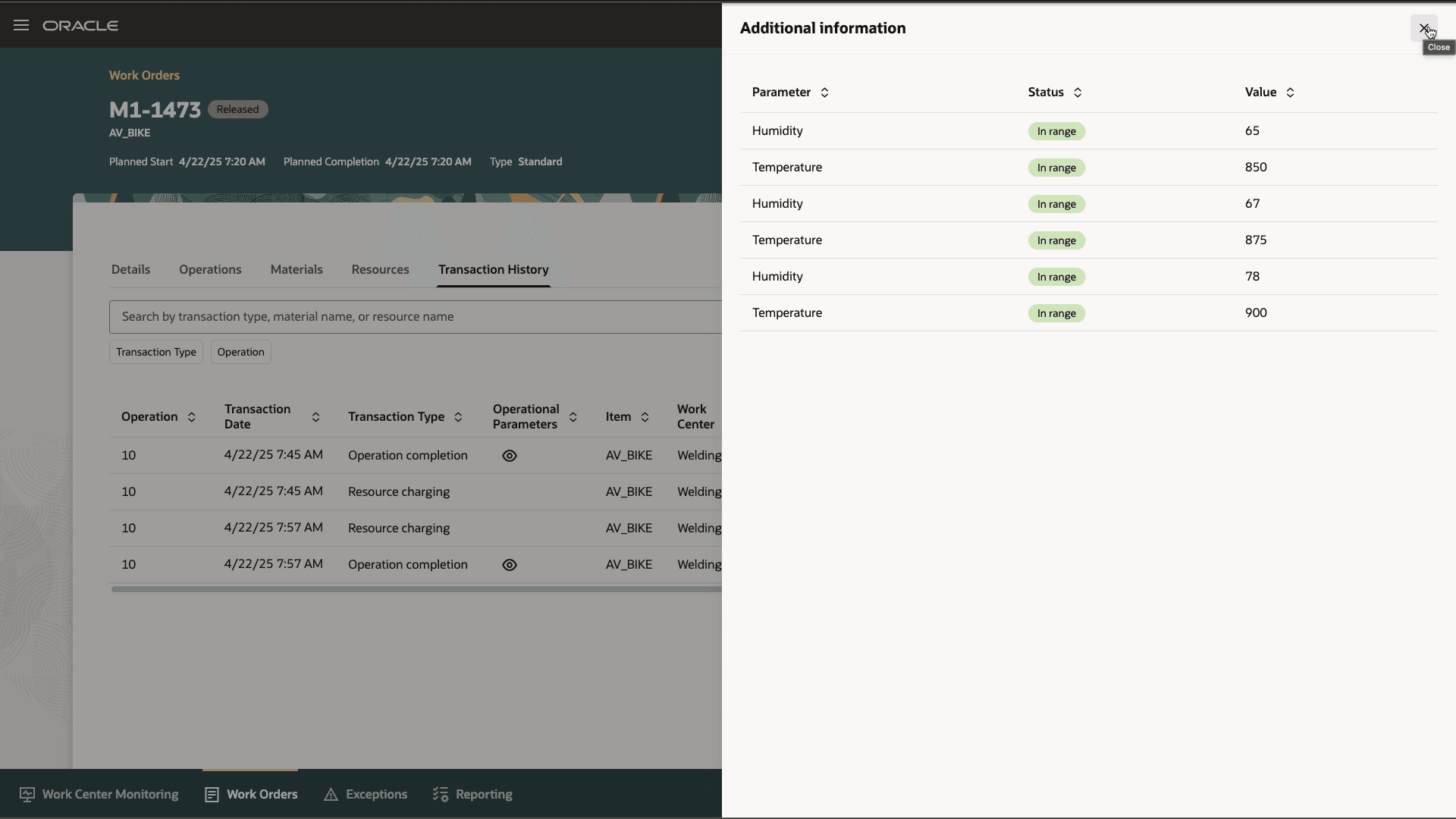

View Operational Parameters in Production Supervisor Workbench
View Operational Parameters in the Production Supervisor Workbench

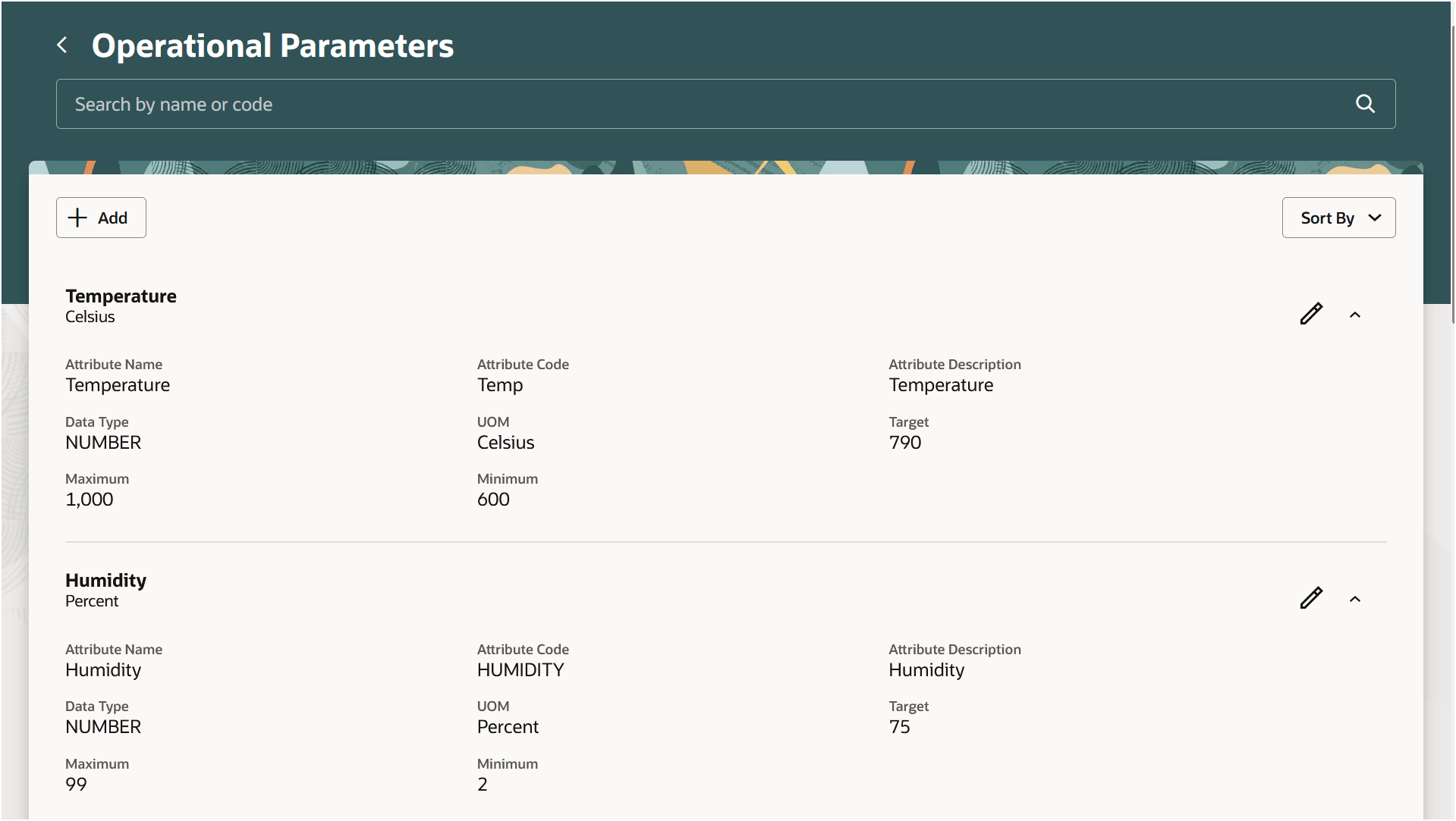

2. Define Operational Parameters.
  • Navigate to the Work Definition work area and select the task Operational Parameters.
  • Create the parameters by specifying details such as the parameter name, data type, target value, minimum and maximum value.
  • Save the parameter.

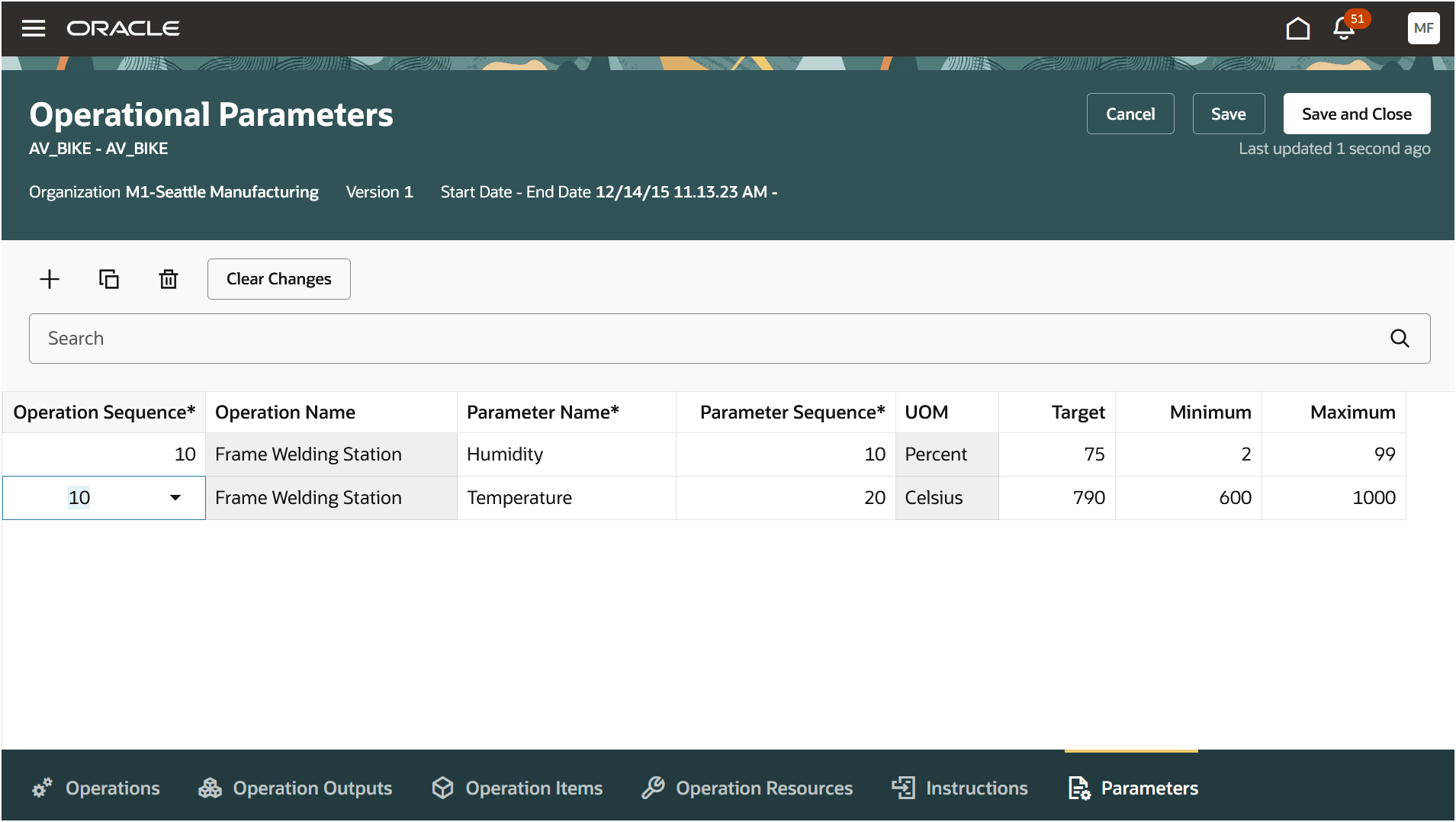

3. Associate Operational Parameters with the work definition.
  • In the Work Definition work area, select the Manufacturing Work Definitions task and navigate to the Parameters tab.
  • Associate the parameters with the operation sequence.
  • Save the work definition.
Associate Operational Parameters to the Work Definition Operation
Associate Operational Parameters with the Work Definition Operation

  • Operational parameters are organization agnostic and can be used in the work definition for items in any organization.
  • Operational parameters are added to work definitions in the "Parameters" tab. An operational parameter can be added once per work definition operation.

  • During execution of work order operations, a connected equipment can send values for operational parameters defined in the work order operation.
  • When an operator or connected equipment reports a completion, rejection, or scrap transaction, the operational parameters collected prior to the report of the transaction are stamped with the operation transaction context.
  • An operator can record only one value per operational parameter while reporting an operation transaction.
  • Entering values for operational parameters is not a prerequisite to submit operation transactions.

  • Operational parameters collected for a work order operation can be viewed in the Electronic Production Record and the Production Transaction History tab of the corresponding work order in the production supervisor workbench.
