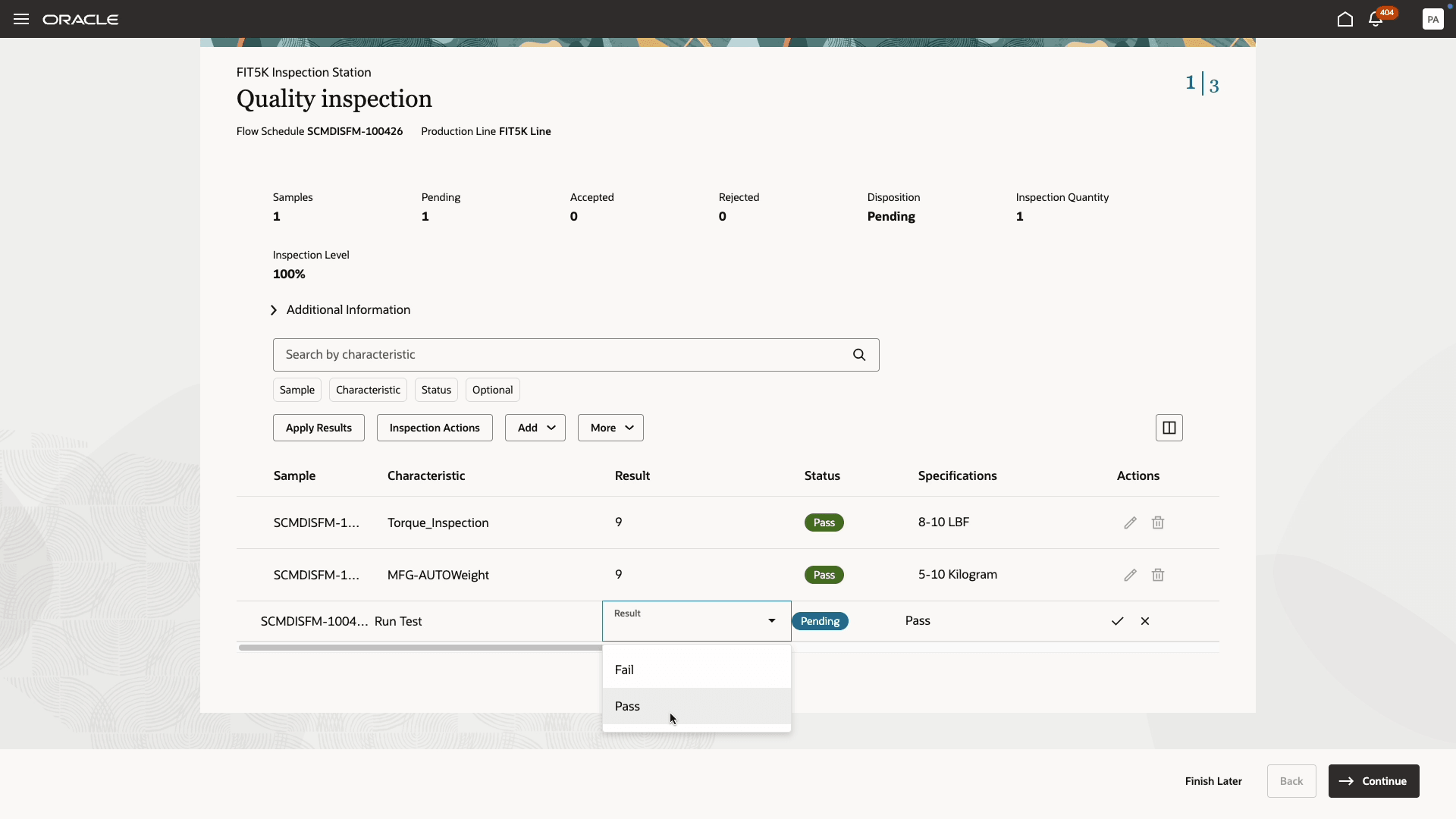

Embedding quality control in flow schedule execution ensures high-quality products for the production line. Operators follow a quality inspection plan by recording quality results against specific characteristics.
With this update, you can now record final inspection results while completing the product in a flow schedule from a workstation at the end of the production line. A predefined inspection plan is automatically selected and enforced at the last operation based on the corresponding work definition for the flow schedule. You are prompted to enter the inspection results and complete the flow schedule quantity as completed or scrapped according to the system-automated inspection disposition.
Perform Quality Inspection for the Flow Schedule at a Workstation Assigned at the End of the Production Line
Operators can use a unified interface for inspecting flow schedules at the end of the production line, ensuring real-time visibility into the quality of items produced.
