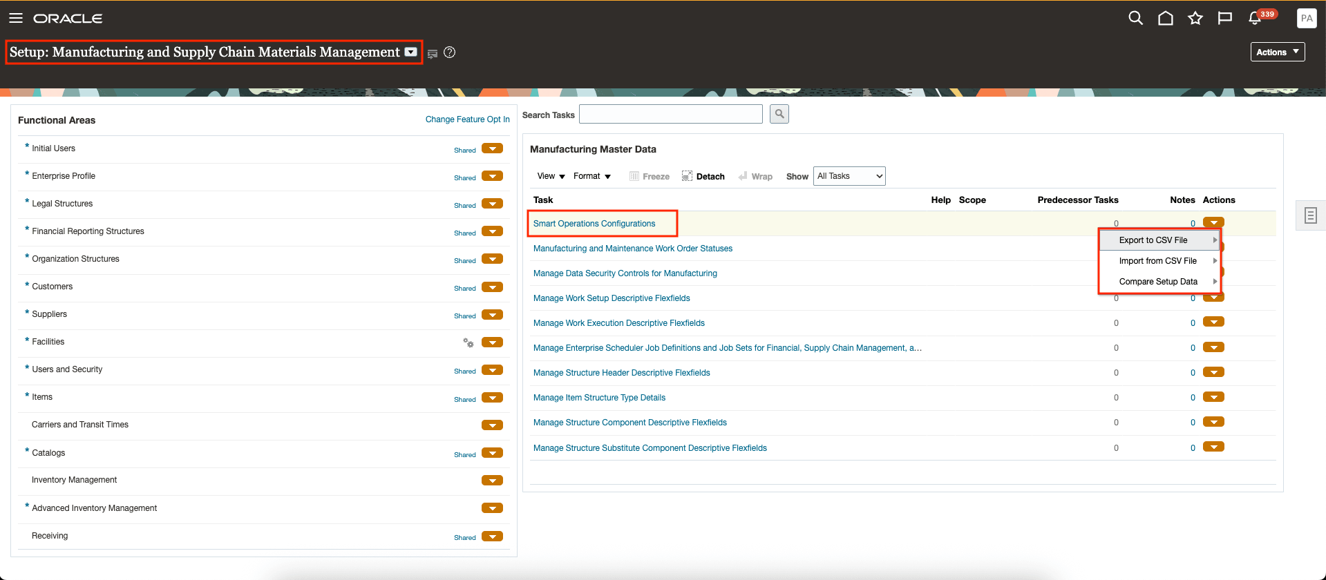

Before this update, migrating Smart Operations Configuration setup data required manual entries to replicate configurations across test and production environments. You can now export and import smart configuration parameters, including unit of measure (UOM) for quantity metrics at the plant level, UOM overrides at the work center level, and reason codes for workstations. The export and import process is trackable, and you can review results to identify and resolve any errors or warnings.
Export and Import Smart Operations Configurations
Using the Functional Setup Manager export feature, you can define key Smart Operations Configuration parameters such as the default unit of measure (UOM) for quality metrics, enforcement rules for operator assignment, target metrics like plan adherence and OEE, and applicable reason codes. These configurations can be exported as CSV files and imported into other environments, simplifying the process of replicating setup data across instances.
The export and import capability also supports UOM overrides at the work center level, which is especially useful in process manufacturing where different work centers may operate with different units of measure. By enabling seamless migration of configuration data, this feature reduces manual effort and ensures consistency between test and production environments.
Seamless export and import of Smart Operations configurations through Functional Setup Manager (FSM) helps manufacturers accelerate deployments, maintain consistent setups across environments, and reduce manual errors during rollout and updates.
