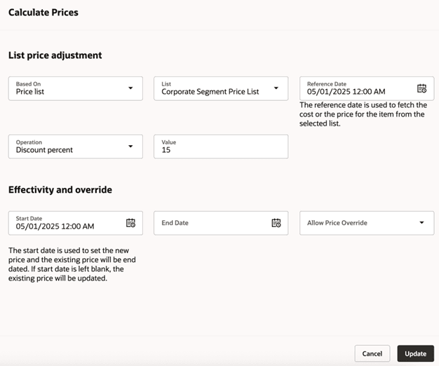

Oracle Pricing uses the Process Mass Actions for Pricing scheduled process to manage a large volume of data on your price lists when you do an action in Pricing Administration or when you import batches of price lists or discount lists. For example, when you click Update on the Calculate Prices dialog:
xxxxxxxxxx

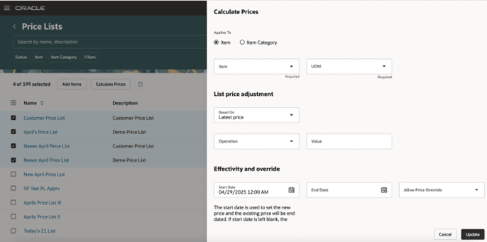

Or when you select more than one item in a price list and then do an action:
xxxxxxxxxxx

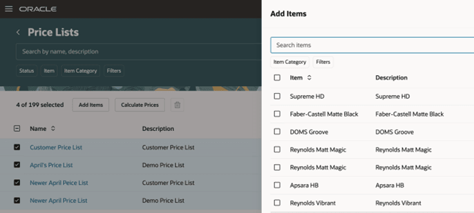

Or when you add items and calculate price across price lists:
xxxxxxxxxxxx
Do mass actions across more than one price list:
  • Filter according to the item's category, then select one or more items in that category.
  • Add items to more than one price list in a single step.
xxxxxxxxxxx

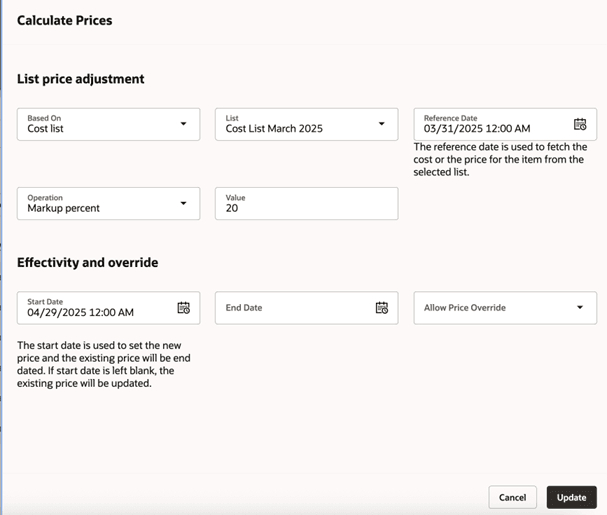

Calculate price according to cost:
  • Set up a calculation according to the item’s cost in a cost list.
  • Apply an amount, a percent markup, or percent discount.
xxxxxxxxx
Calculate price according to the price on another price list:
xxxxxxxxxxxxx

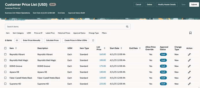

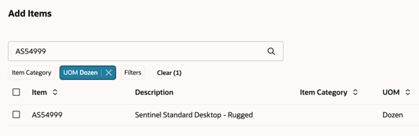

Add an item that has a nonprimary UOM. Add the item manually or through a UOM conversion:
xxxxxxxxxxxxxxx

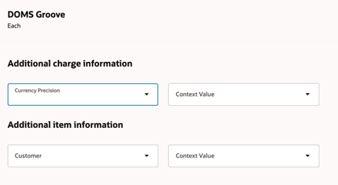

Use a flexfield to store more details about the charge:
xxxxxxxxxxxxxx

Reference Date
Applies when you do a mass action that calculates price according to an item’s cost in a cost list or price in another price list. The action will pick that item’s cost or the price that's in effect on the reference date.
Start Date
Use it to decide when the update goes into effect. If you don't enter a start date, then pricing assumes it's a direct update for that item’s price. If you enter a start date, then pricing will end date the existing price and create a new one.

Calculate Prices
Pricing will immediately calculate up to 500 records when you click Calculate Prices. If there's more than 500, pricing automatically uses a scheduled process to calculate them.

Calculate Prices
You can use the Calculate Prices dialog to calculate price for more than one price list only if the price lists are in the same business unit and have the same currency.

Nonprimary UOM
To add it, go to the Add Items dialog, search for the item, select the nonprimary UOM, then add it to the item.
